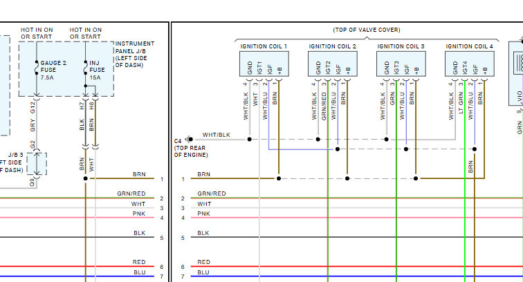

engine crank but no start no spark. I check for volts at the connector at the coils wires, I'm not getting any volts or power to any of the coils brown wire +B where does this wire get its power from and where it connect to? do it run from coils to Ignition switch or the ECU? can you send me the 2.4l engine controls wiring diagram? how do I fix this problem?

The power to the coils (brown wire) comes from the INJ fuse in the fuse panel on the left side of the dash. Please check it out and get back to me.

The INJ fuse is good. do this car have a EFI relay? because there is 0 volts at the coils and fuel Injectors.

Do you have power to/through the INJ fuse?

yes I have power to the INJ fuse. I check the fuses under the hood is there where the INJ fuse is?

Yes, that is where the INJ fuse is. If you have power at the fuse you should have power at the coils, here is the wiring diagram so you can see how it works. Check out the images (below). Ken

look like the volts go and come. right now it show 5.06 volts at the brown wire on all four coils

It sounds like you have a shorted coil, I would unplug them all and then test the voltage at the connectors. Let me know.
