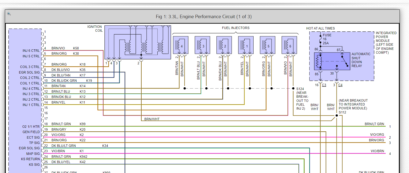

Will not start. No power to coil. Changed crank shaft and camshaft sensors. Changed all relays.
Sep 25, 2022 at 2:25 PM
  • 55,770 POSTS

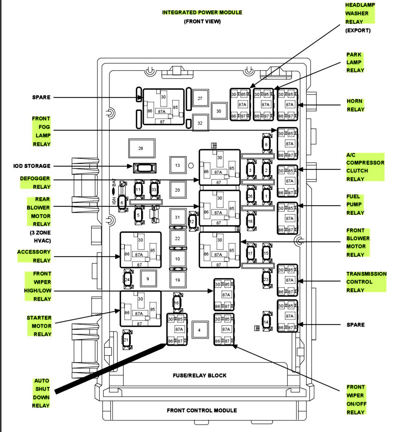

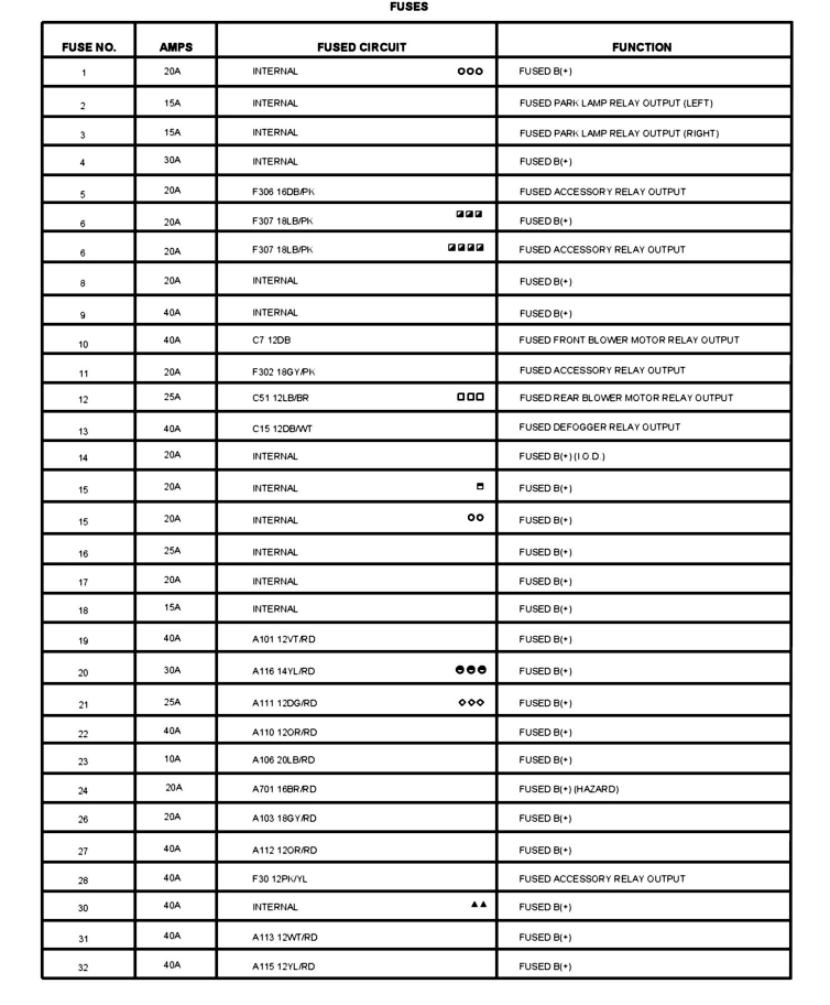

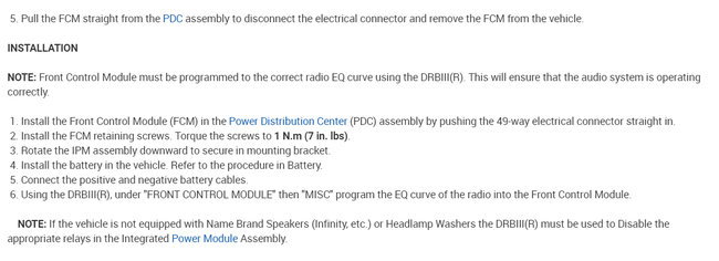

First, I would check fuse #16 for power in the TIPM here is a guide to help you, if the fuse is good and has power check the ASD (auto shut down) relay which is also in the TIPM.
Here is the fuse and relay location in the images below and I have included the ignition coil wiring diagram so you can see how the system works.

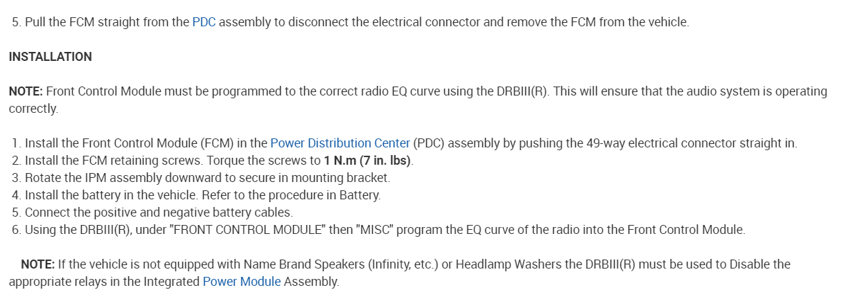

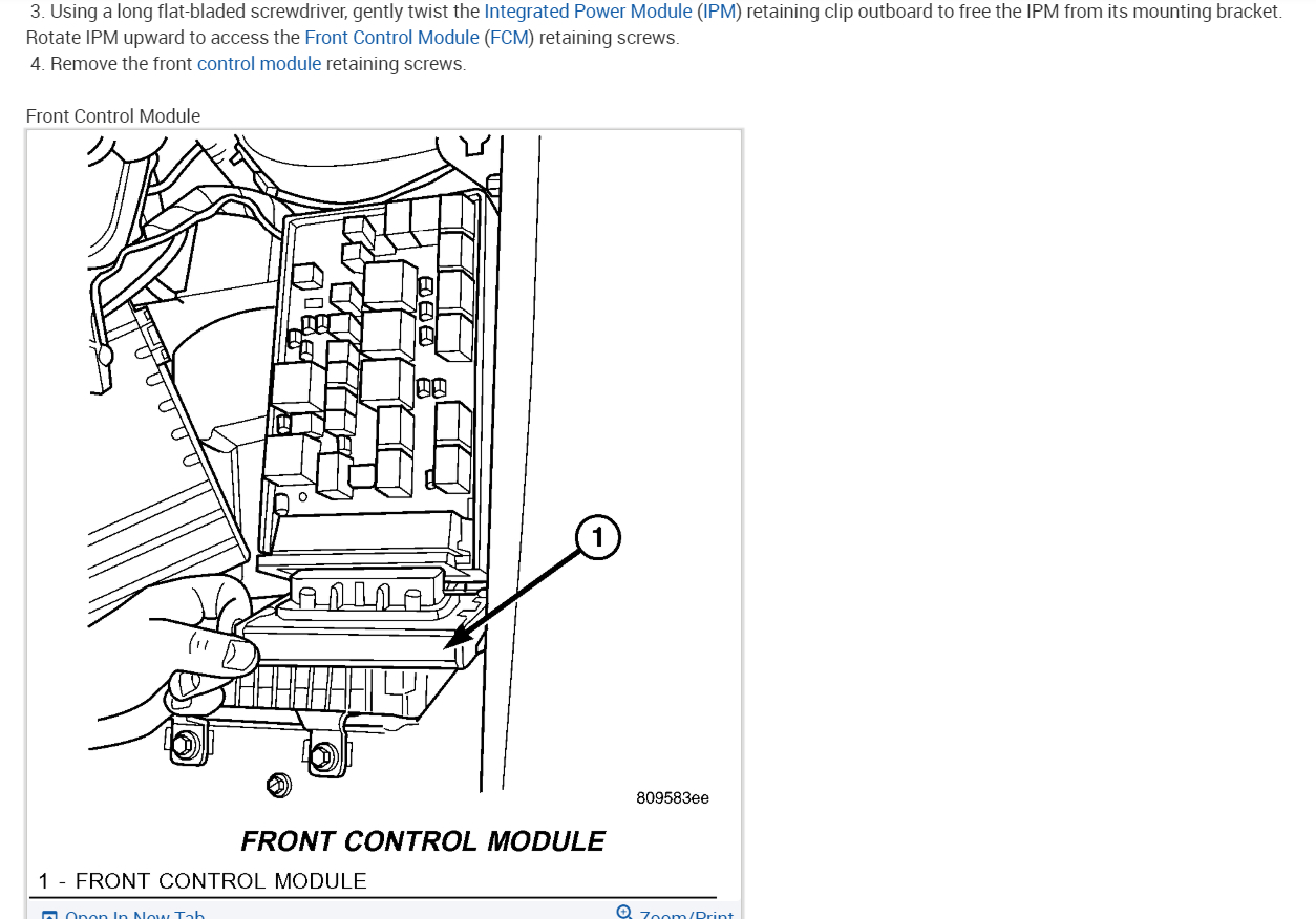

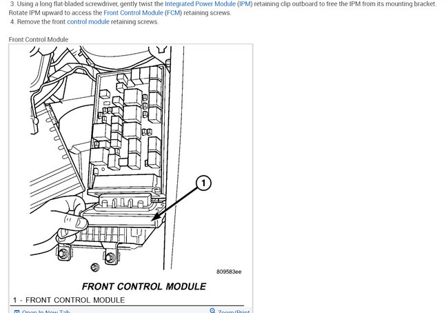

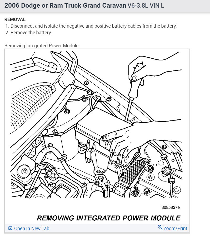

With the key on if the fuse does not have power the TIPM is bad, which is common on these cars. They are easy to replace because they are self-learned. Check out the images (below). Please let us know what you find. We are interested to see what it is.
