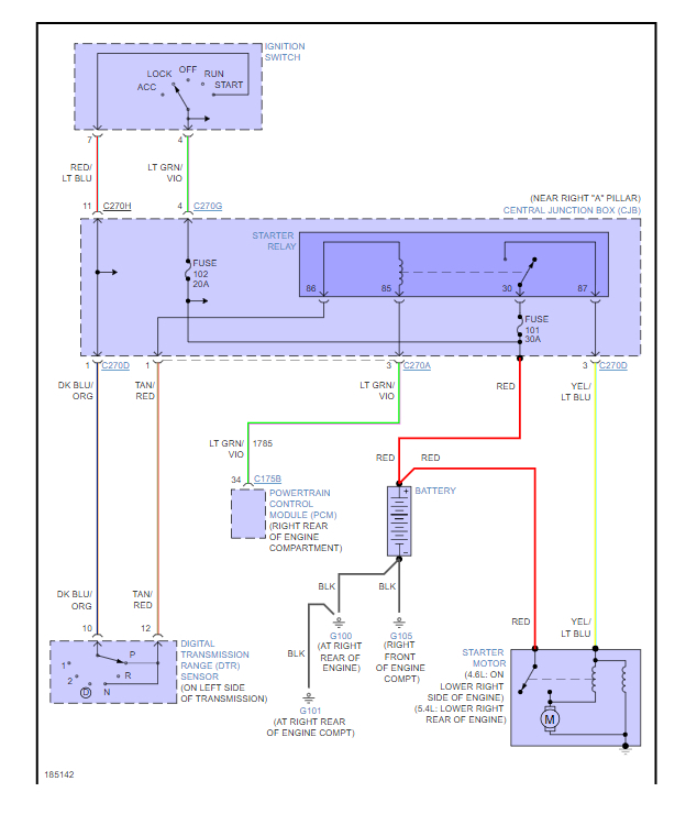

The truck listed above 5.4, super cab, the starter wire got shorted out. It put on a new starter and checked all the fuses and the relays cluster has no power won't crank won't start.
Dec 16, 2022 at 6:36 PM
  • 55,808 POSTS

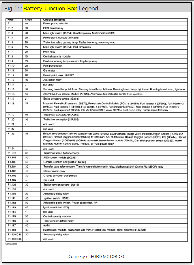

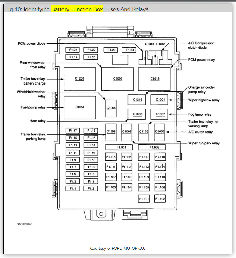

Using a test light can you check to see if there is power at fuse # f102 and f101 in the right interior fuse panel. This guide can help, and I have included wiring diagrams for the starter circuit:
Check out the images (below). Let us know what happens and please upload pictures or videos of the problem.
