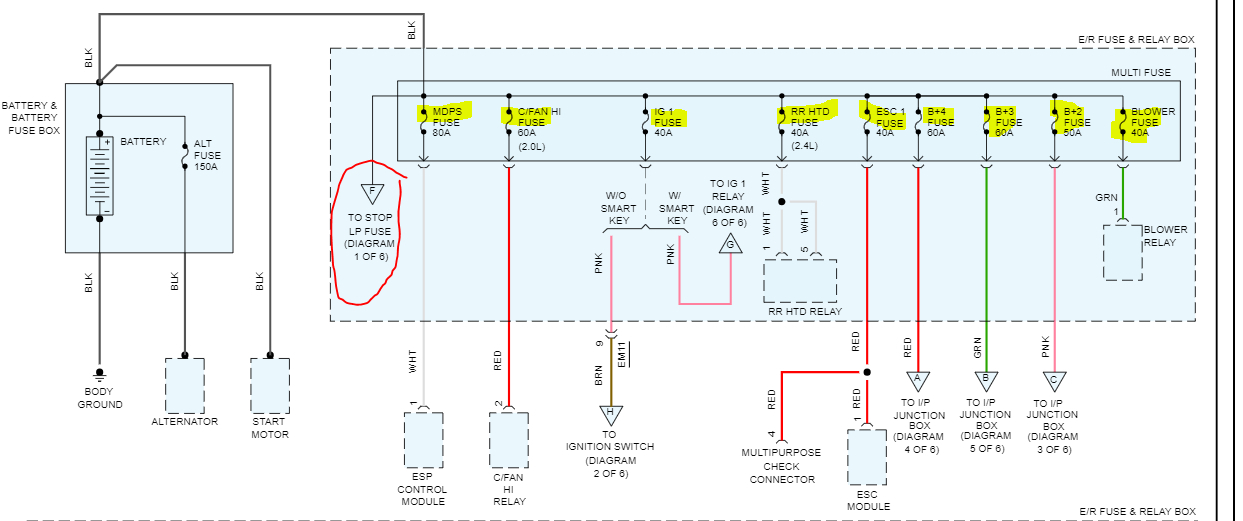

RMASKE
None of my lights on and in the car are working except for my brake lights. My car won’t crank or start. When I push the push to start button, it turns blue and does nothing. The horn works, but my remote key fob doesn’t work since there is no power to the car. Battery has been tested and it is fine. What do you think the issue might be? I don’t hear any clicking or turning over when I push the push to start button.
Jun 5, 2023 at 10:27 PM
  • 110,244 POSTS
If only the brake lamps work, it sounds like the fuse/relay box under the hood has failed.
Power from the battery goes into the under-hood fuse box. See pic below. I need you to take a test lamp and check if the fuses in the box are getting power.
Here is a link that explains how to test a fuse. It also includes checking for power. Try this and let me know what you find:
See pic below.
Jun 6, 2023 at 2:11 PM
