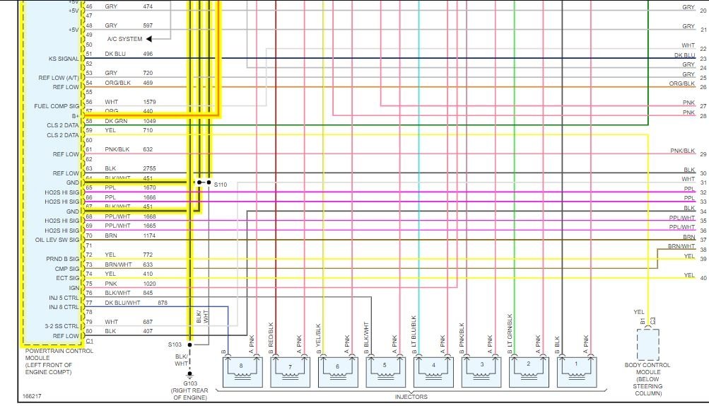

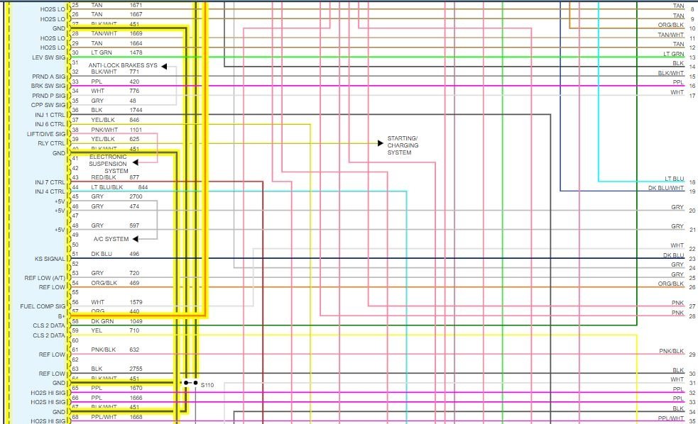

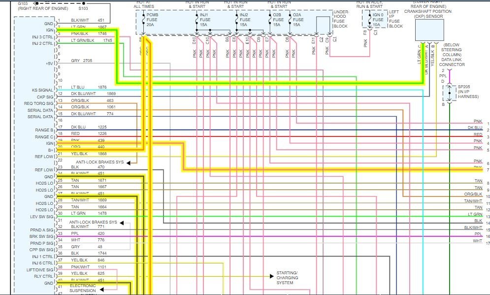

Okay, back to power. Did the shop check for powers to the modules? The ECM would be the first one to check.
Does the check engine light come on with the key in the on position?
I attached the powers and grounds to the ECM to be checked. Check those pins for power and the grounds as well.
