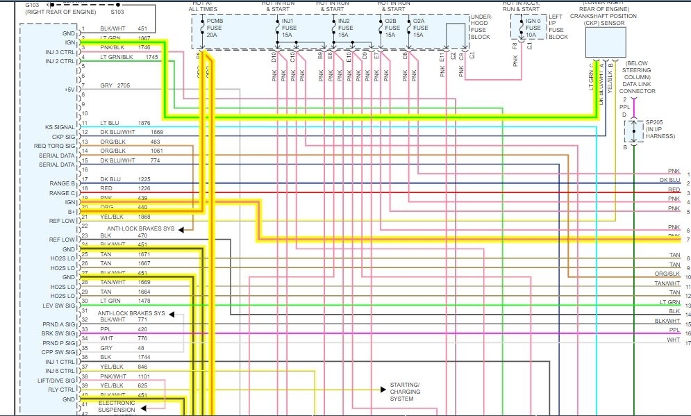

My gauges all quit working except speedometer and tachometer. The 4x4 switch won't light up, dome light won't work, windows, door locks, cruise control, A/C, rear defrost all don't work. Took it to a shop to have it scanned and won't communicate with anything. Replaced BCM and no difference. Checked all grounds and cleaned them. Any help would be appreciated.

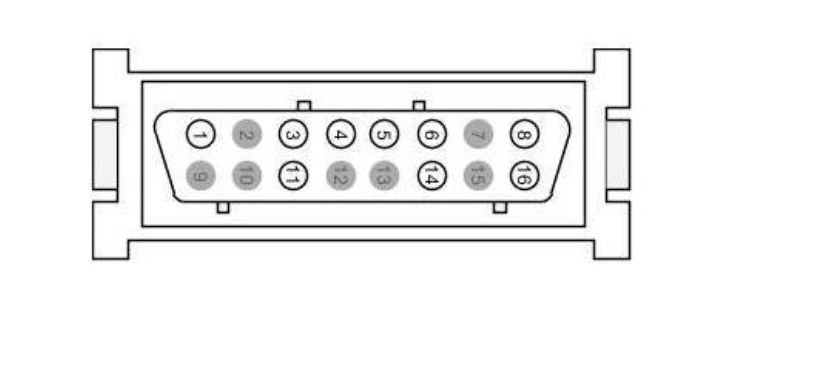

Was there power to the data link connector? Did the shop verify that?
Feb 12, 2020 at 9:20 AM
WILLIAM WARNER
Yes there is power to it.

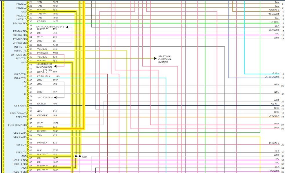

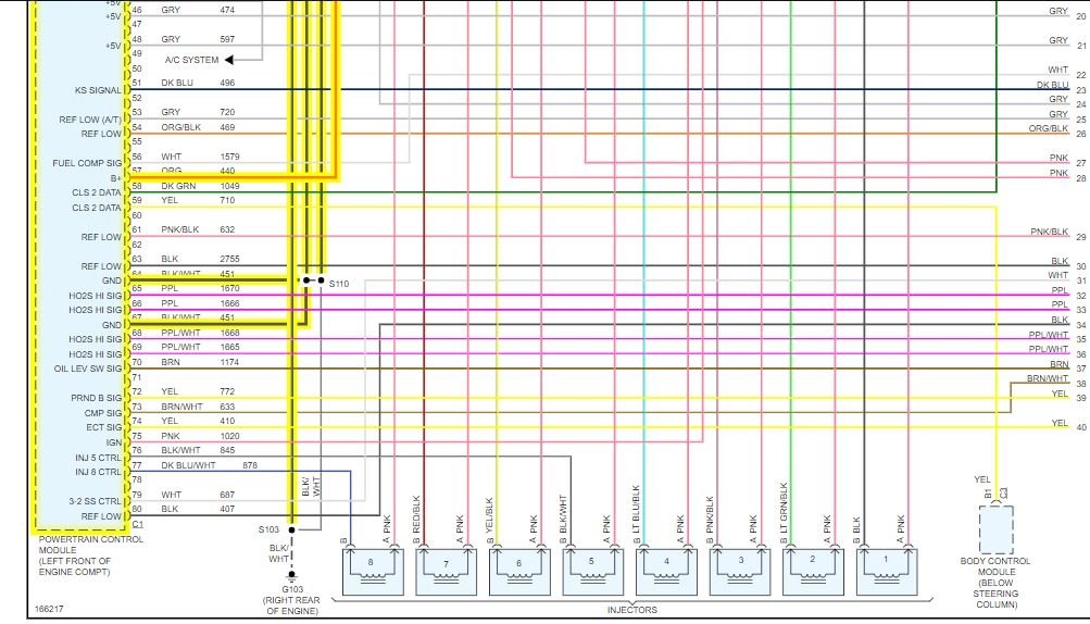

Okay, back to power. Did the shop check for powers to the modules? The ECM would be the first one to check.
Does the check engine light come on with the key in the on position?
I attached the powers and grounds to the ECM to be checked. Check those pins for power and the grounds as well.
