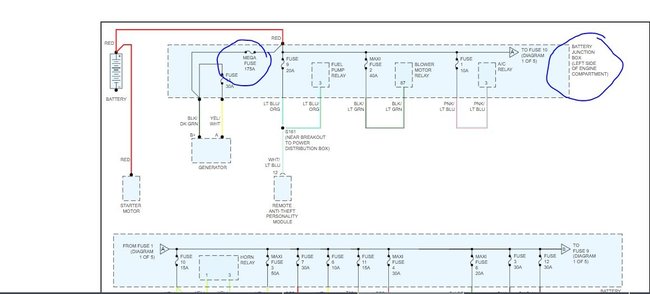

i just got done putting a engine and transmission in my Suv listed above SOHC . when i try to start it the battery arced significantly when attaching the positive cable.I disconnected the cables going to the power distribution box. i left the hot wire going to the starter and hooked a hot wire to the alternator I don't have any power whatsoever.I have tried to find information on the battery to power control box and exactly what goes where and all i get is stuff about mega fuse. any information you could give me about what should go where starting at the battery would be greatly appreciated.
Mar 30, 2020 at 7:30 PM
Good morning,
I attached the location for you. It is under the hood in the fuse block. This guide will help
Hopefully you did not fry any modules. Also, the negative cable is the first one off and the last one on.
