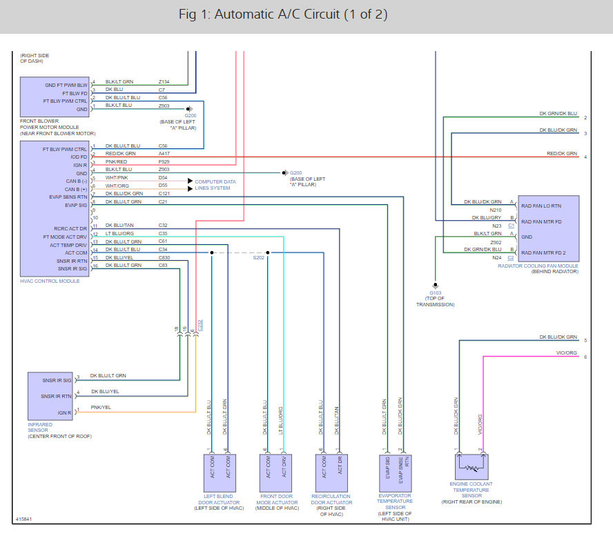

The fuse has been tested and TIPM replaced. Still no power to compressor. Checked hot side of fuse and have 12 volts. somewhere between TIPM and compressor it is losing power to compressor.
Any ideas?

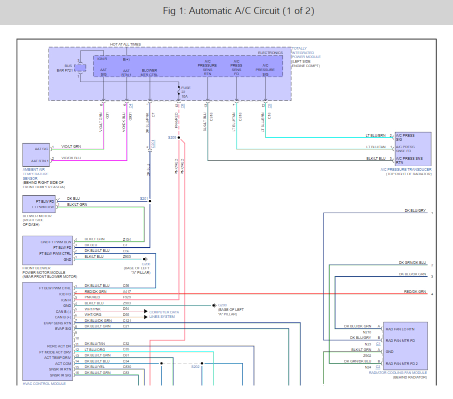

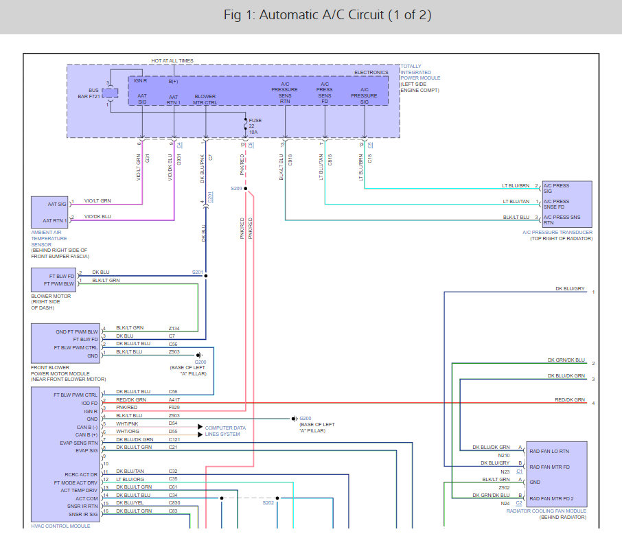

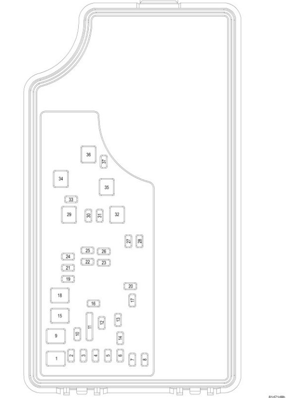

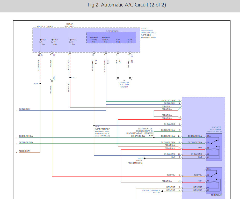

The compressor is controlled by the PCM. Let's first check for power at fuse #22, 6, 18 and 33 in the TIPM.
This guide can help:
If all is good, we should run the codes by doing a CAN scan which is easy. You can get a CAN scanner (Controller Area Network) from Amazon for about $36.00.
and
https://youtu.be/u-4syLc-ifQ
Here is a scanner link:
https://amzn.to/3eCqWWw
Here are the A/C and compressor wiring diagrams so you can see how the system works and the fuse locations as well. Check out the images (below). Please let us know what you find. We are interested to see what it is.

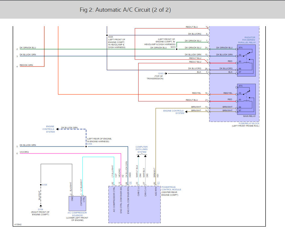

He had it connected to his laptop. TIPM is requesting voltage to compressor. I’m sending the rebuilt back and reinstalling the original.
Mechanics guess at this point is PCM is getting the request but is not sending it on to the compressor.
He’s going to do what I’ve done. Post the problem in a mechanics group. Hope for an answer next week.

Is there power at the light blue wire going to the compressor? If so the engagement coil or ground is bad. Please let me know what the problem is.
Sep 26, 2022 at 4:22 AM
JWINO52
There is no voltage on that wire. TIPM is telling PCM to send voltage on that wire. I’ll sure let you know what happens.
