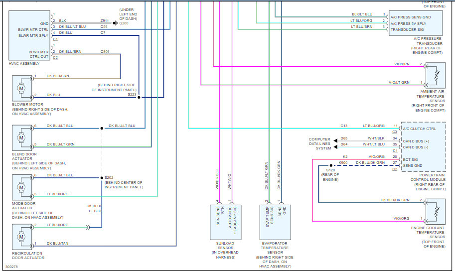

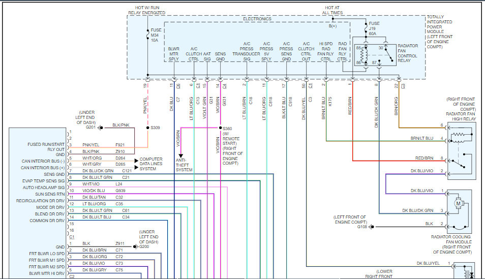

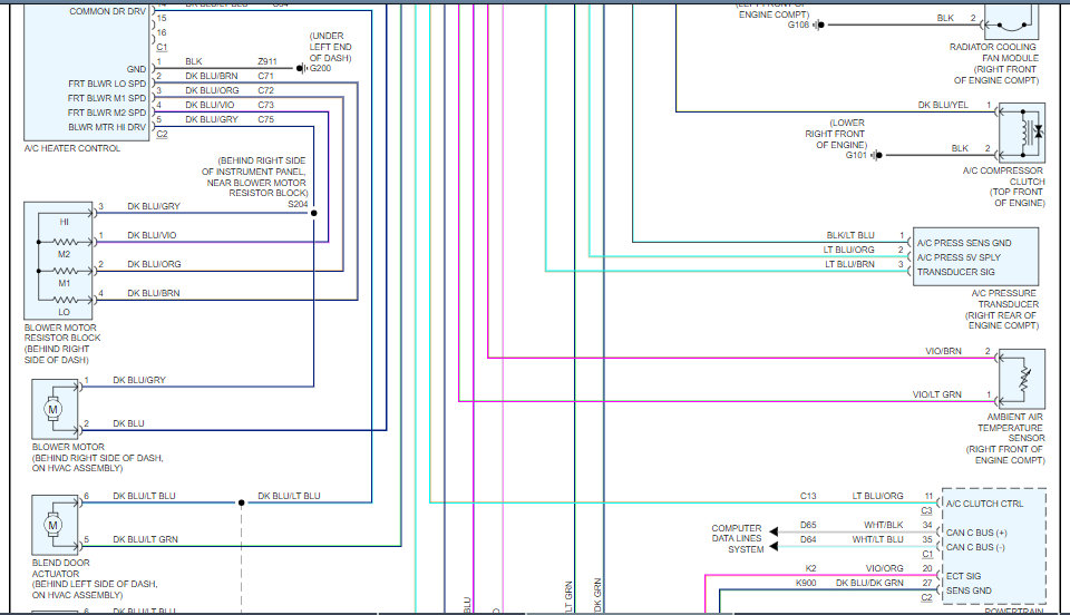

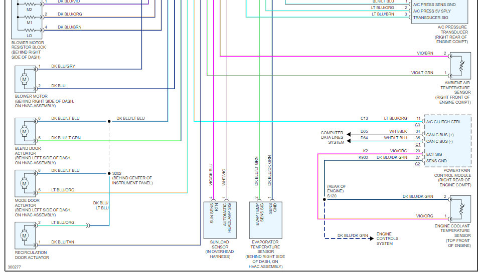

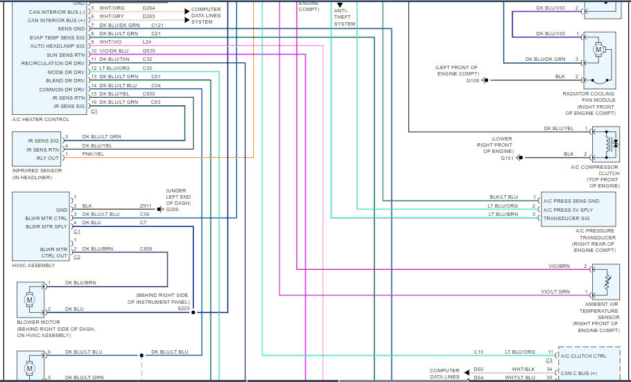

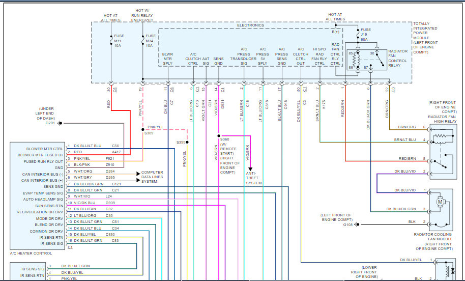

I just bought this vehicle. replaced a locked up A/C compressor. But no power through A/C system. I have checked fuses all good. No known relays though this model. And there is only the one fuse box under the hood. Am I missing something or does this mean I'm going rabbit hunting through wires?
Aug 29, 2021 at 7:08 AM
DANNY L
  • 5,648 POSTS
Hello, I'm Danny.
Here are the wiring diagrams you requested for your air conditioning system. This is a tutorial showing how to test electrical wiring:
I've attached the wiring diagrams below for your Jeep. I've cut the pictures into 3 pieces each so you can view larger. The first 3 pictures are for an automatic system and the last 3 are for a manual system. Hope this helps and let us know if you have any further questions on this issue. Thanks for using 2CarPros.
