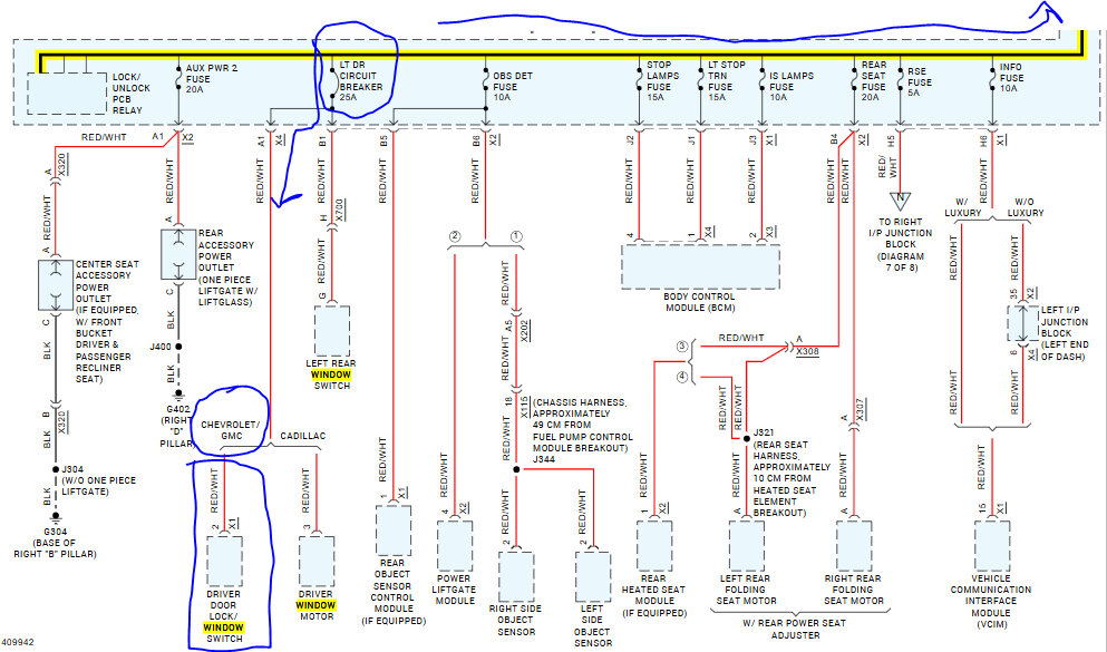

Hello, my master driver door switch doesn’t work; nothing on it works.
Nothing on the driver door is operating from other switches.
All other door switches work for all doors but driver door
When I lock the doors from any switch but driver door all doors lock but driver.
No power on 4 fuses in interior fuse box on driver side.
No power on 11,12,18, and 21.
Any help would be appreciated.

I worked backward from the switch. The schematic is 8 pages long, so I focused only on the power supply to the master door switch.
First, at the switch, there should be a red wire with a white tracer. That is a power supply from a circuit breaker located in the interior fuse panel where you are working. This is not a traditional fuse but a circuit breaker. So, start by checking the power to the red/white wire on the switch.

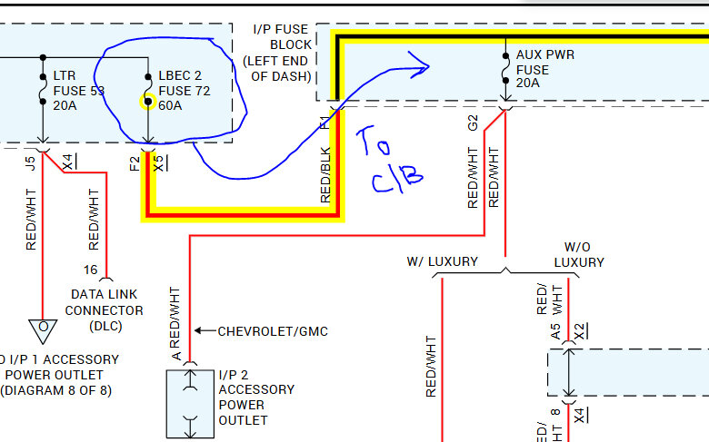

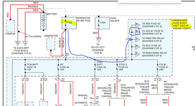

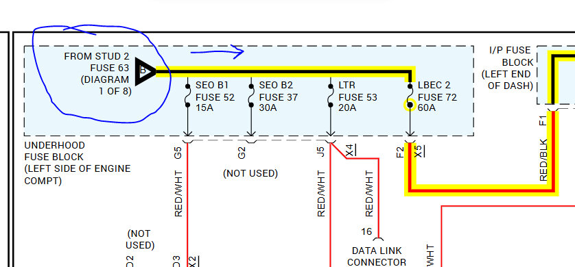

If there is no power (key on), then we need to work backward. The LBEC 2 fuse (number 72) located in the under-hood fuse box is the next location that needs to be checked. Make sure it is good, has power to and from it, and let me know what you find. If it is good, that takes us back to a 175A fuse in the under-hood fuse box. However, if that fuse has failed, there would be several other (not 4) fuses not getting power.

2) Power to the CB in the interior fuse box
3) Power to and from the LBEC 2 (number 72) in the under-hood fuse box
4) The main 175A fuse in the under-hood fuse box.
Once we determine where power is lost, then we can perform other tests to see what is happening.
