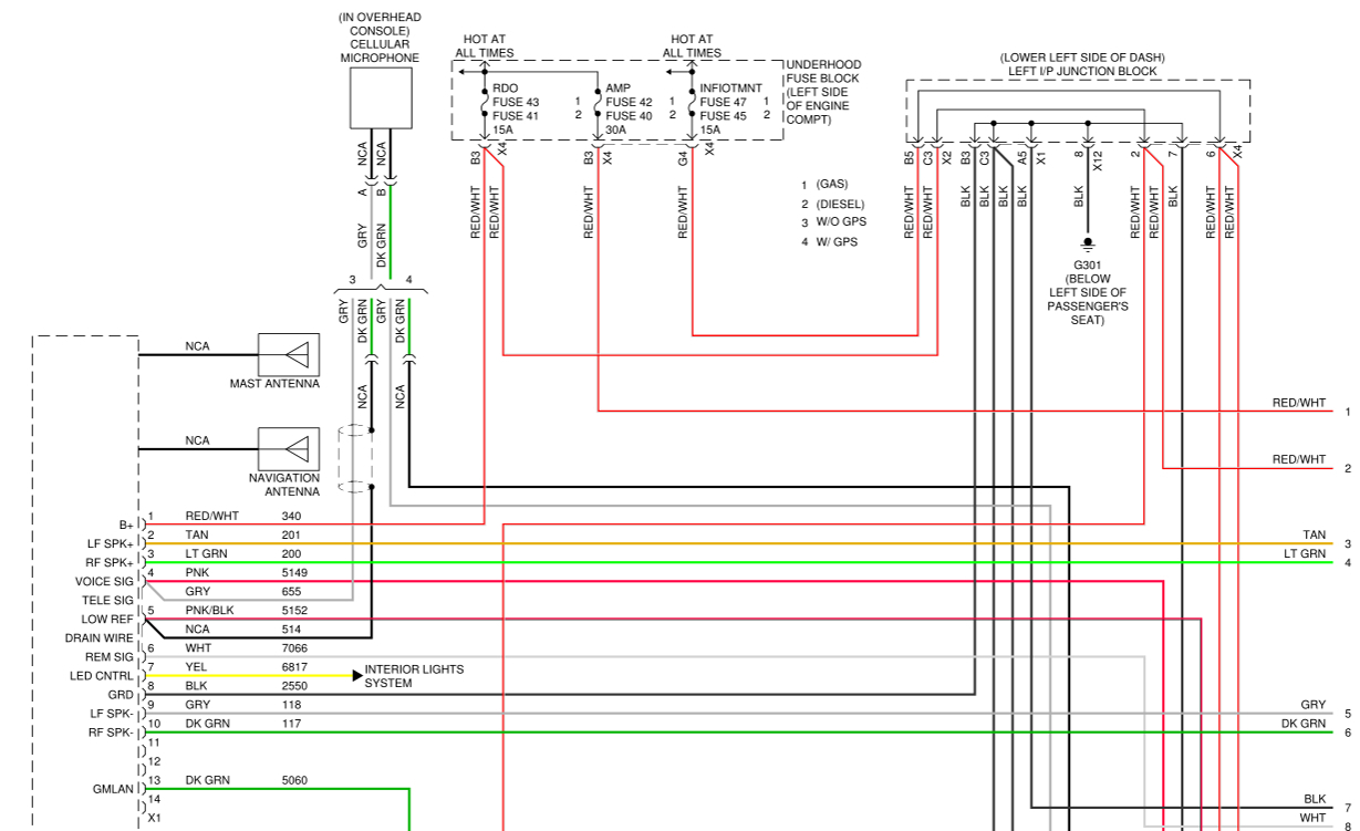

I have no power when key is in any on/run position on line 1044 going to A1on the radio. I want to check the line from the BCM but do not see it on any drawings.

All wiring diagrams I look at show current track 340 to pin A1, red/white wire.
Constant 12V supply from fuse F43 or F41, 15A, in engine fuse block
See image below.

I found what I was looking for. A1 from line 1044 goes to the SP205 turning into line 1037 going to the serial port of the BCM. Bcm should push a 12vdc once key is turned on thus providing the necessary data to turn on the radio. I will pin my line once I get some free time from work.
