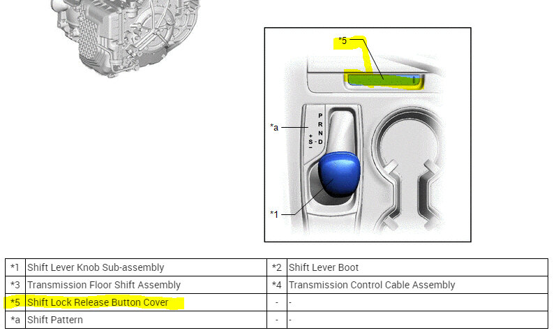

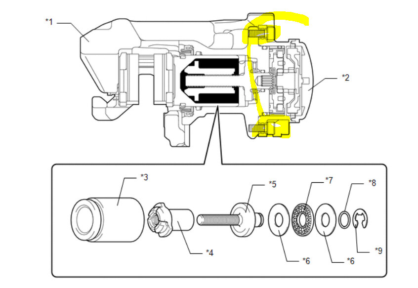

I've purchased the car listed above XSE used with all keys lost, battery drained, and ebrake engaged. What's the best way to get this car moving again either on its own or manually by pushing/rolling? I am pretty good with repairs and do own a Autel IMO enabled device to program new key.

As far as the parking brake is concerned, if you have no power, the only suggestion I have is to remove the electronic parking brake actuator on the rear of the brake caliper. See pic below. There is a long screw that turns and pushes the caliper piston and engages the brake.
To remove the transmission from park, there is a shift release button. If you look at pic 2 below, it shows the location. Remove the plastic cover and the release button is below it.

Thank you for your response! Car is a repo with no keys. It's in immobilized status. I was able to get it unloaded from carrier by removing the electronic emergency brake motors and putting it in Neutral by pushing the shift release button.
