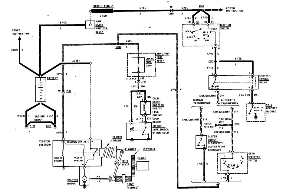

Replaced battery and car still won't start or turn over. No dash lights or anything. I have no idea where the fuses or relays are to check them. Please help.
Oct 9, 2019 at 11:38 PM
SCGRANTURISMO
  • 4,897 POSTS

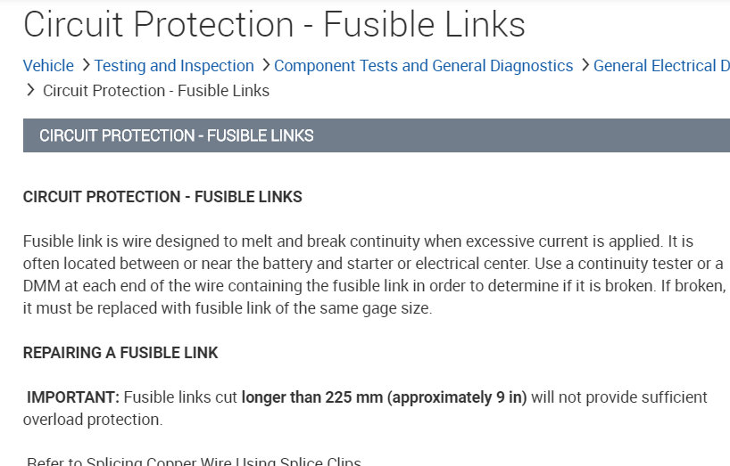

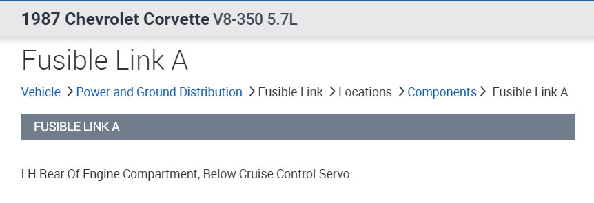

Okay, in the diagrams down below I have included a wiring diagram of the starting circuit on your vehicle and a description of where fusible link A is located, and a guide to fusible link inspections. Can you please inspect fusible link A and get back to us with what you find out. We can go from there.
