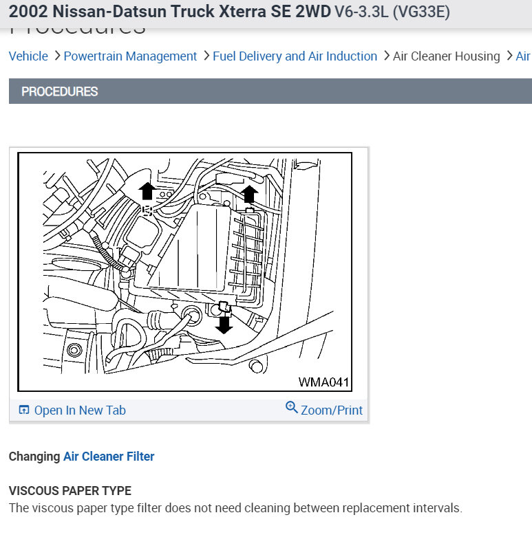

Vehicle shut off while making a turn, started right up without difficulty. Stepped on accelerator to speed up, engine bogged and no power. Gas pedal release restores power. At 2,500 no power.

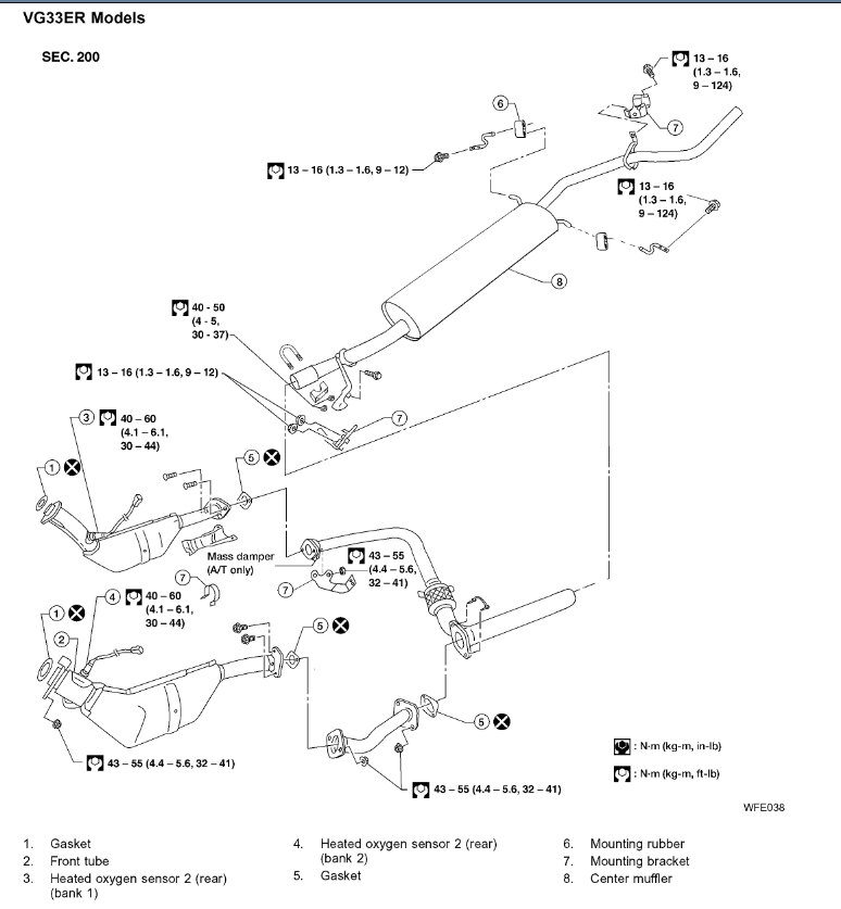

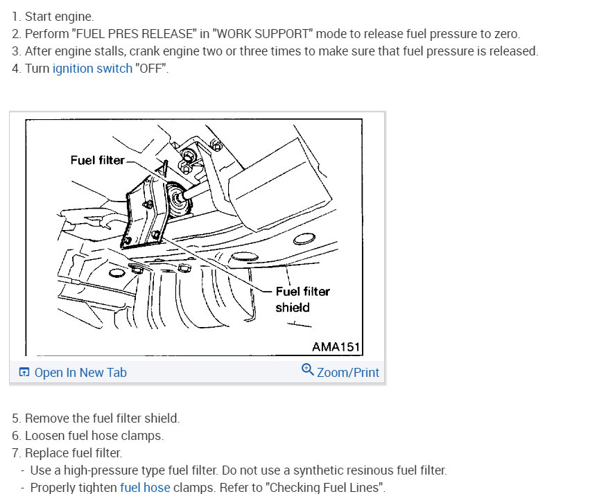

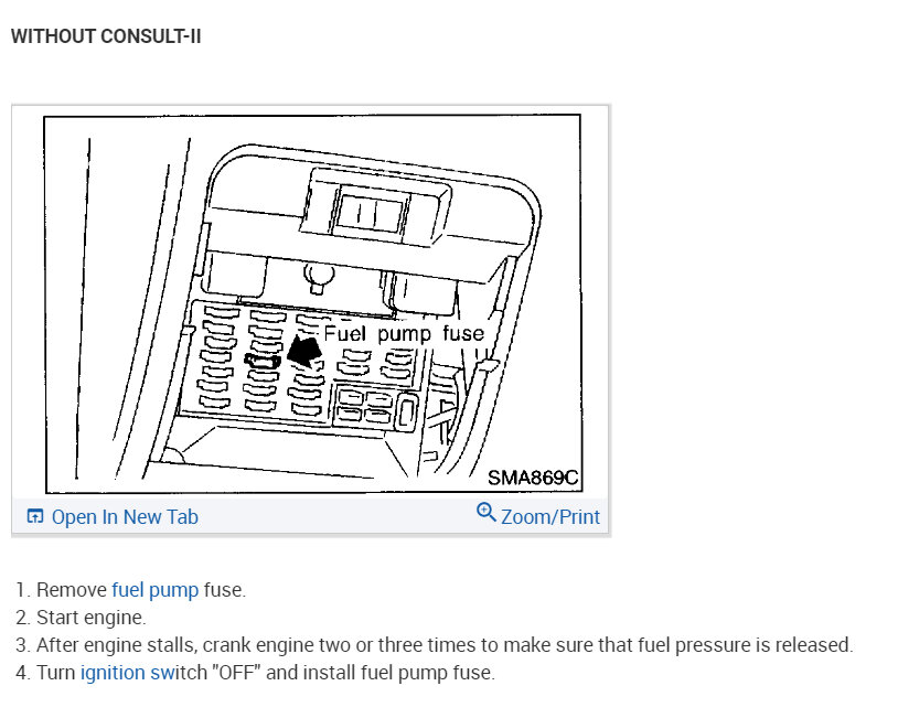

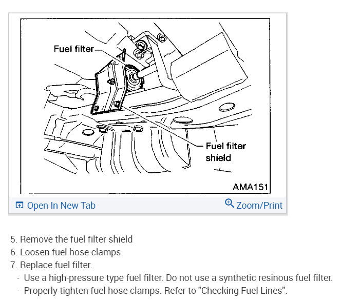

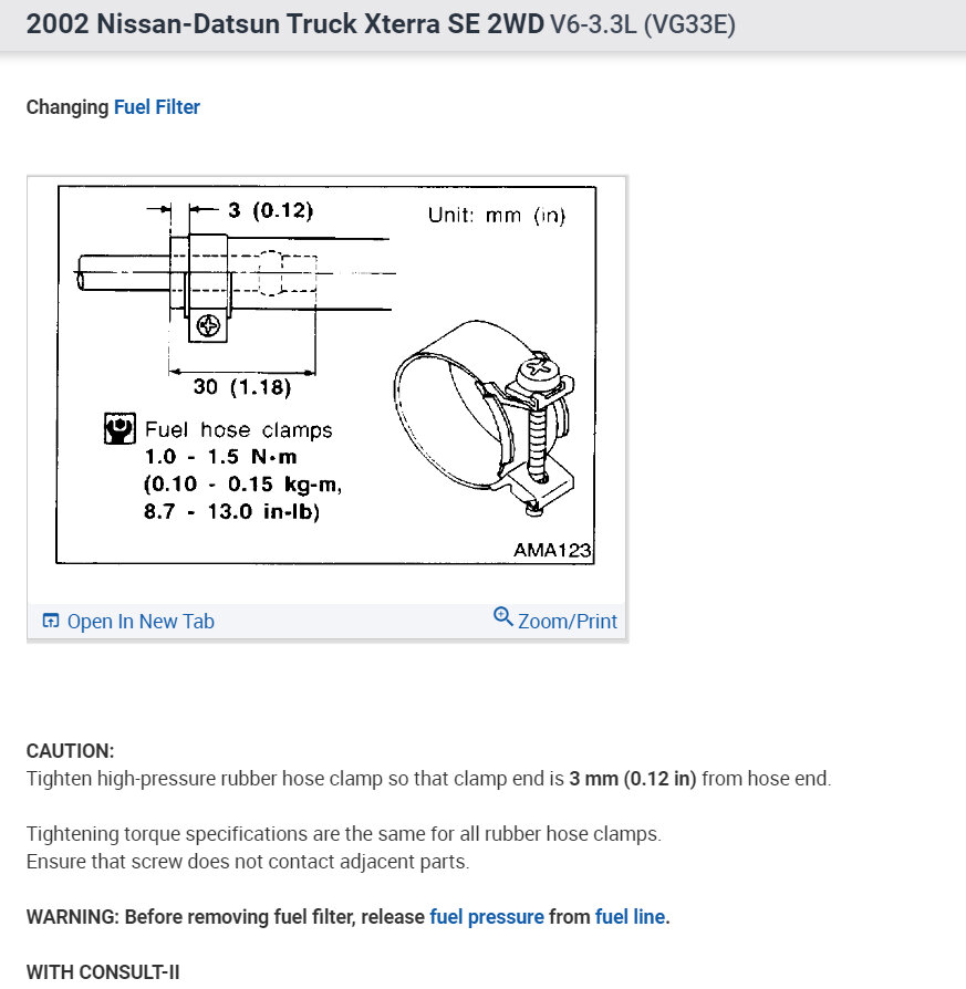

I would first check the air filter and then change out the fuel filter. Here is a generic guide to help you step by step with instructions in the diagrams below to show you how on your car:
https://www.2carpros.com/articles/how-to-replace-a-car-air-filter
and
https://www.2carpros.com/articles/how-to-change-a-fuel-filter

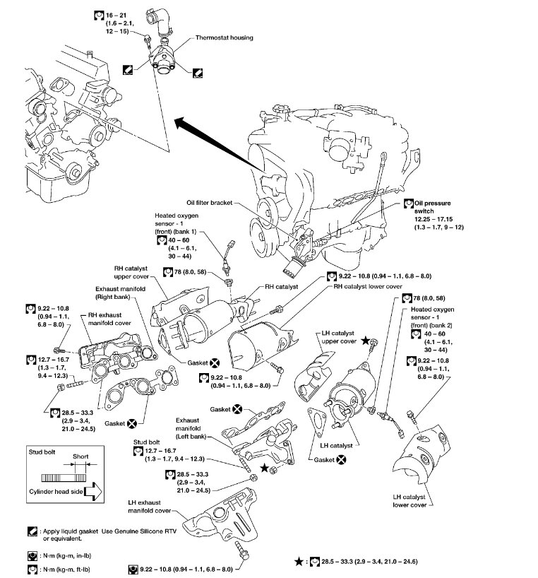

If these are okay let's check for a clogged exhaust system, this guide can help:
https://www.2carpros.com/articles/engine-has-low-power-output

Thanks for your input. Ran to parts house and replaced MAF sensor. OBF showed MAF and Knox. Runs like normal with replacement MAF.
