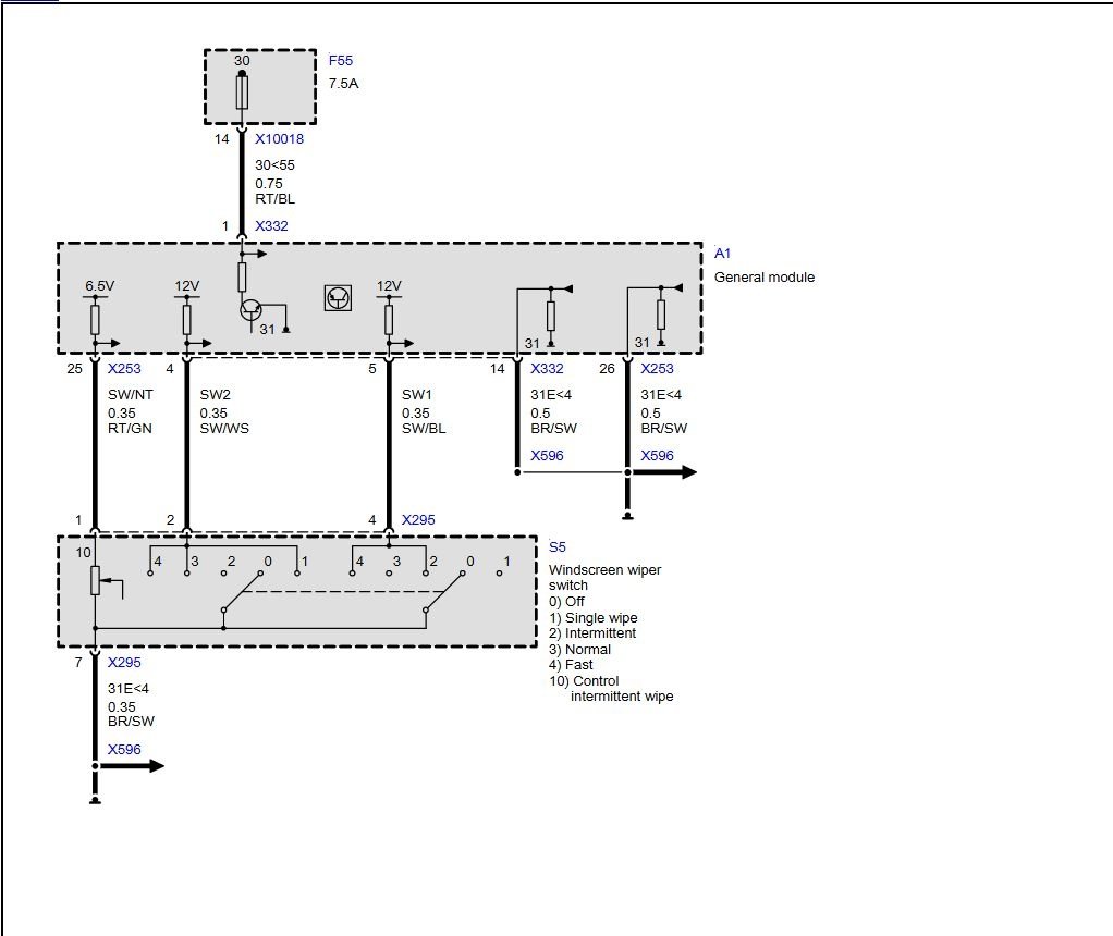

The spray comes on but the wiper does not. Check the motor and it is working but there is no electrical supply to the motor. Any diagrams will be helpful.

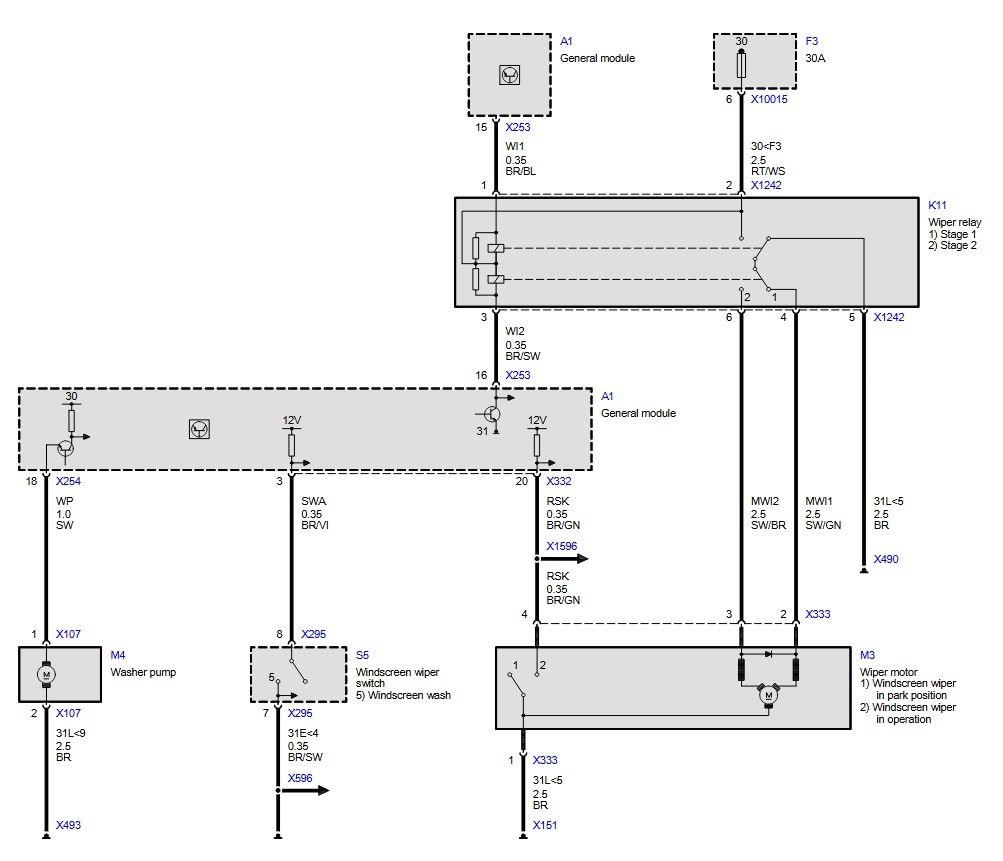

Okay, these are the diagrams BMW shows for that system. It appears that you should have battery power on the brown/green wire at the wiper motor with the switch on. That is fed through from the general module, which also powers the washers.
You should also have battery power through the wiper relay from fuse F3 a 30 amp.
I would start at the fuse and the relay.

Not sure it was much help. BMW has some of the most confusing service information. However, the way that system works testing for voltages on the wiring should point to where the problem is.
