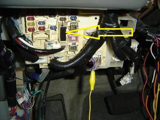

Hi Sir, I checked further and found a big black fuse-like part (see the pictures) in the fuse box below the steering wheel. I pulled it out and found a part numbers on it "90980-04066". It's not transparent and can be seen filed with epoxy from the bottom. I found no continuity (no current passing through) between the 2 blades. Toyota calls it "condenser" and several dealers can't tell me what it's and it's a special order item. People in the internet said it's a fuse, circuit breaker, relay, diode, or capacitor. If it's a fuse or circuit breaker, then it's blown. But if it's diode or capacitor, it might be normal and I don't need to order it. Please advice. Thank you very much!!!

The yellow arrow in the last picture pointing to this big black fuse-like part in the fuse box.

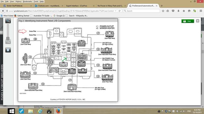

From what i can find out it is what is called a noise filter, it 's exact function is something that i will have to look into, but i do believe that it will not case the car not to start and i am not sure how to test it, its something that i have never had to deal with before.

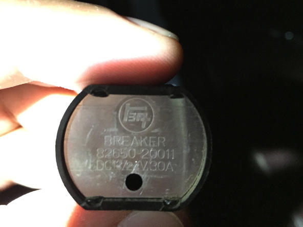

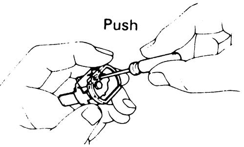

I have went through many internet messages on this condenser 90980-04066 and just found one person said both new and old condensers had no continuity between the two prongs. If true, it is more and more likely to be a circuit breaker opened. Many people talked about a re-settable circuit breaker in Camry 1988 ~ 1996 (see the attached pictures), but I can't find it even after the left kick panel was removed. The Hayes Repair Manual for Camry 1997 ~ 2001 very briefly talks about circuit breakers, but doesn't show numbers, locations and pictures.

Please see the pictures from some internet messages on re-settable circuit breaker.

Tye re set circuit breaker is quite easly identified with the hole to access the re set function, i believe that Toyota have not used these for a while now, but i could be wrong, what you have identified on the earlier pic is not a circuit breaker, but a noise filter as shown in my pic.
