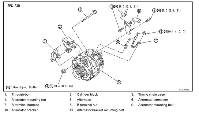

I put in a battery but ground was too short I understand rewd it from side wall under battery holder. Started up fine I noticed the battery light and brake light were on. Last time that happened it was the alternator. I got a new one and battery and brake light went off. I got to a red light and car only sputtered I put it in neutral and it revved same in park. I pulled off put ground back. And same thing. I turned it off and tried to start. Nothing. I hooked battery then hooked it back up. Started drove until I slowed to a stop and same no power only in neutral and park.

The negative battery cable concerns me when reconnecting it did you connect the battery/body ground as well as the engine block grounds? Can you upload images of the job so I can see?

Yes, I put all back where it was. I think I caused the alternator to go out again.

I guess I am going to have to learn how to remove and install a alternator.

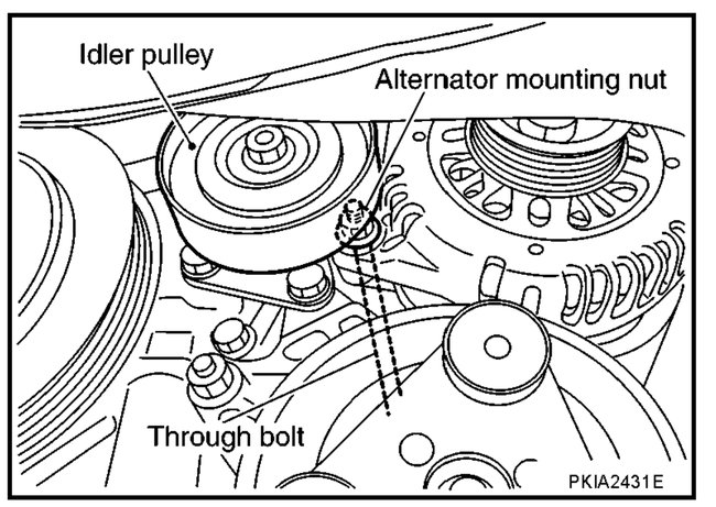

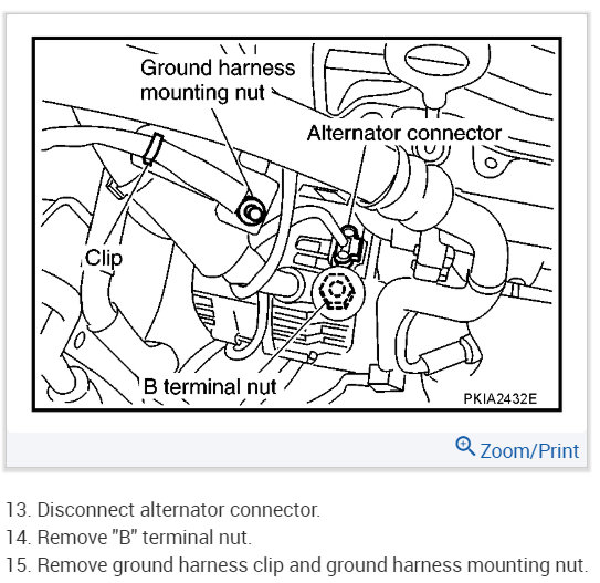

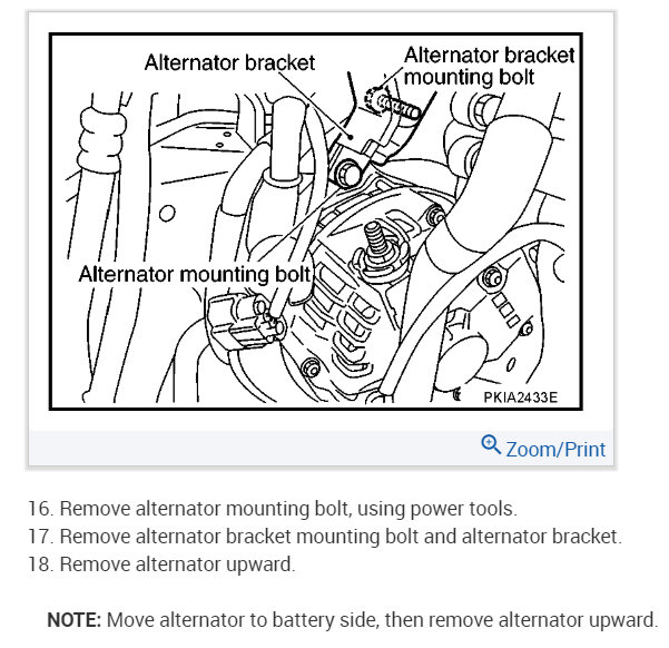

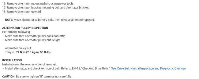

Yep, I would use a Denso rebuild. Here is a guide to help you with the step by steps and diagrams below that show you how on your car:
https://www.2carpros.com/articles/how-to-replace-an-alternator
