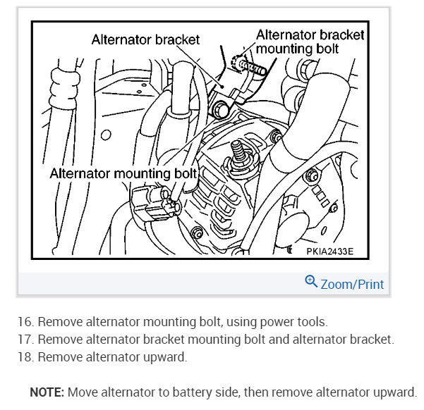

I put in a battery but ground was too short I understand rewd it from side wall under battery holder. Started up fine I noticed the battery light and brake light were on. Last time that happened it was the alternator. I got a new one and battery and brake light went off. I got to a red light and car only sputtered I put it in neutral and it revved same in park. I pulled off put ground back. And same thing. I turned it off and tried to start. Nothing. I hooked battery then hooked it back up. Started drove until I slowed to a stop and same no power only in neutral and park.

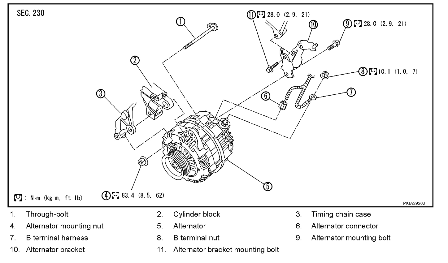

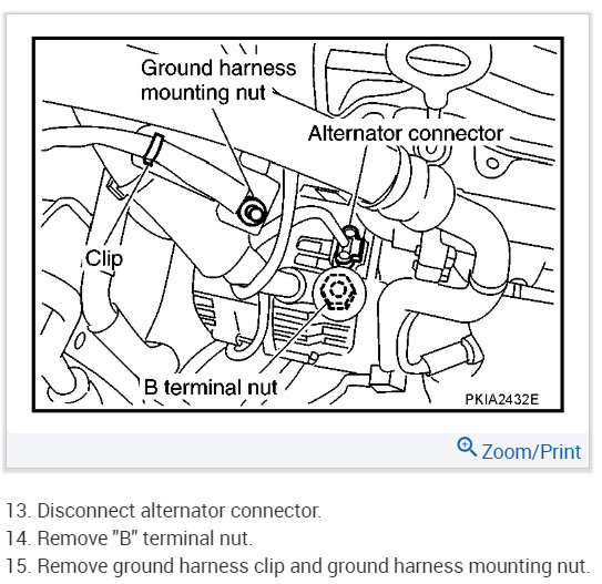

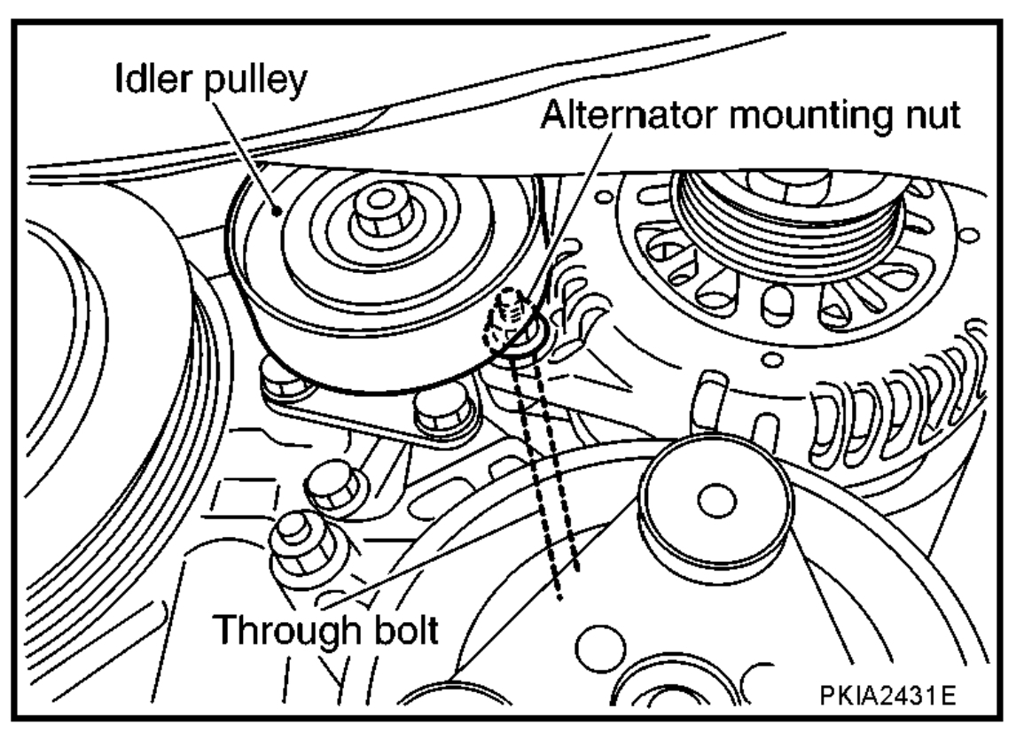

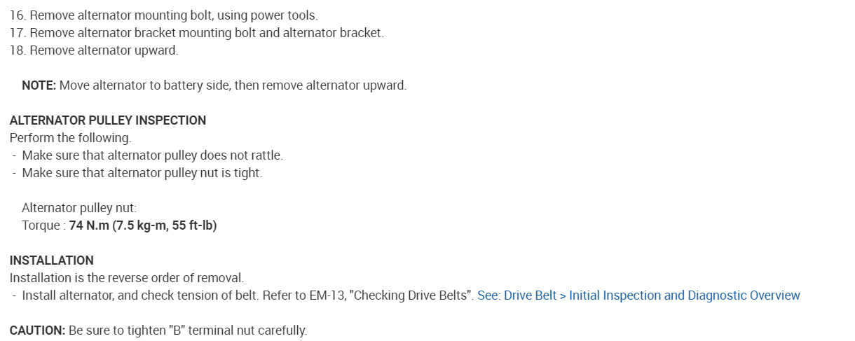

I guess I am going to have to learn how to remove and install a alternator.
Aug 18, 2018 at 8:19 AM
  • 55,433 POSTS
Yep, I would use a Denso rebuild. Here is a guide to help you with the step by steps and diagrams below that show you how on your car:
https://www.2carpros.com/articles/how-to-replace-an-alternator
