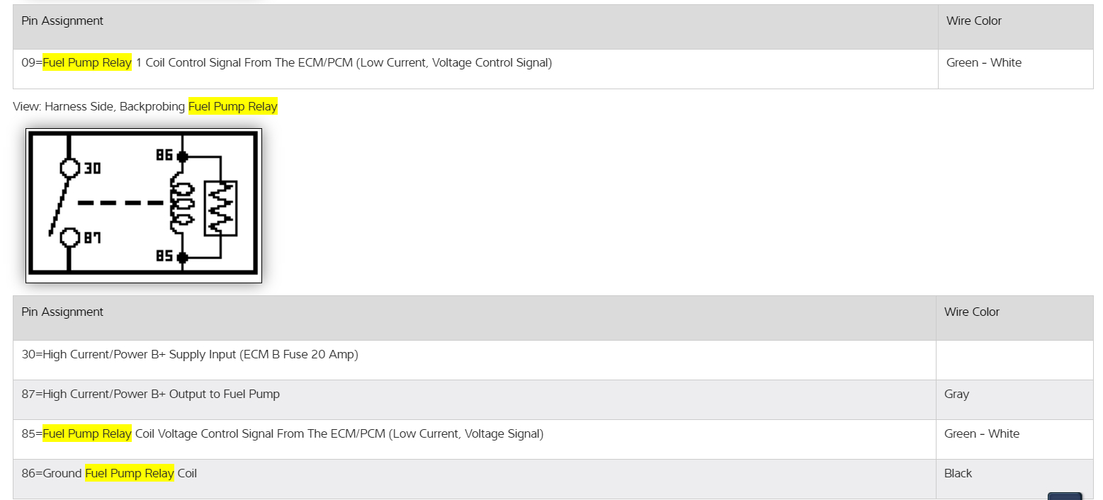

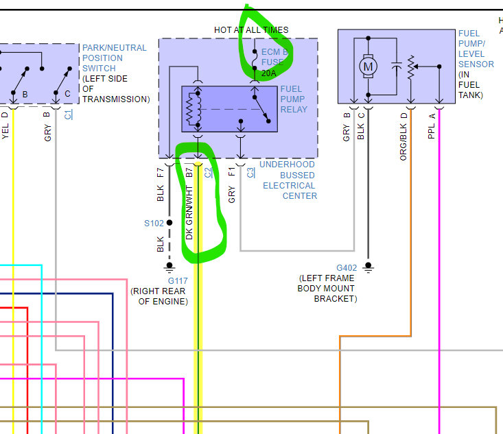

Hello, if you pull out the Fuel Pump Relay, and with the key in the On Position, just touch your test light to the Fuel Pump Relay socket female pins, don't stuff your test light in there just touch the open pin area and you should have 2 pins with 12-volt power, you'll probably have to do this test while cranking the engine over, since at Key On you'll only get a 2 second prime for the Fuel Pump. This Relay is a power side switched relay, so power comes from the ECM to energize the Relay. Circled in green here are your 2 power sources for the Relay. So, the other 2 pins should be Grounds, you can hook your test light to battery power to check the Grounds at the Relay. If you're missing any of these 2 power feeds or 2 Grounds, then we'll chase that circuit down. The test should be able to Ground right through the Fuel Pump. This is a quick easy test to see what's happening on those circuits.

Okay. so, I just did that. I have 2 powers and only 1 ground with check light. Bottom left on relay is #30 does not have a ground.

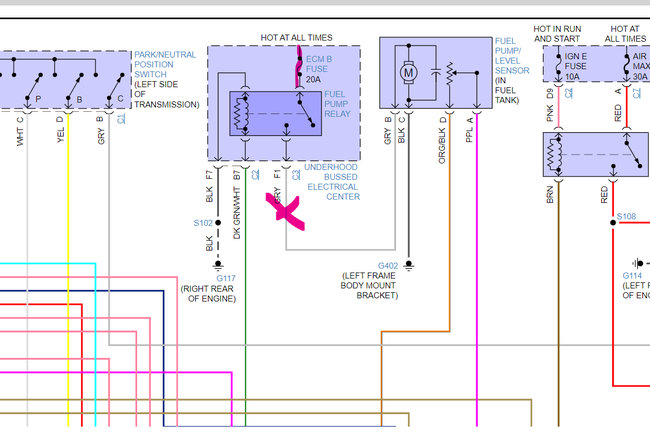

Okay. so, pins 85 and 86 are the control side of the relay, and pins 87 and 30 are the load side, if you have two powers, technically speaking, the power should be coming from ECM Fuse B 20Amp and the other power feed should be coming from the ECM because it's a power side switched relay. Usually and the diagrams say that pin 30 should be the feed from ECM B Fuse, but sometimes they have them backwards on the diagrams or if it's not the original relay the numbers could be in different spot. So, to determine what's the correct numbering, simply do the same check but with the key off. Because ECM B Fuse should be hot even with the key off. So, you should have only 1 power wire. If that's the case, then the Ground you're missing is the actual wire going to the Fuel Pump, you have an open circuit somewhere between that relay and the Pump.
Considering how old the vehicle is, you may first check the underside of that Fuse/Relay panel, the wires are exposed to the element's underneath there and the pins for the relays break off after getting corroded. You might find some other circuit issues under there as well. But that's where to start. GM has always used that grey wire for their Fuel Pump circuits as long as I can remember. So, if the pin for the relay is not broken off, just start tracing the wire back from that location.

I finally found the frame body ground back by the pump, bolt had fallen out and ground was loose, I’ve looked over it ten times and never saw it until last night. Thank you for the help. I knew it was a wiring issue but just couldn’t trace it down.
Much appreciated. Ol Betsy back on the road now!!
