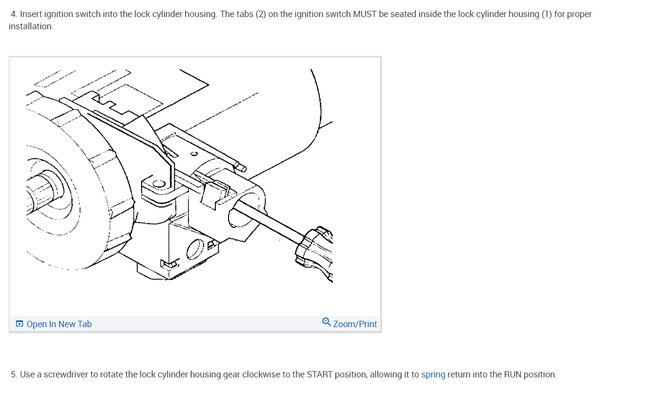

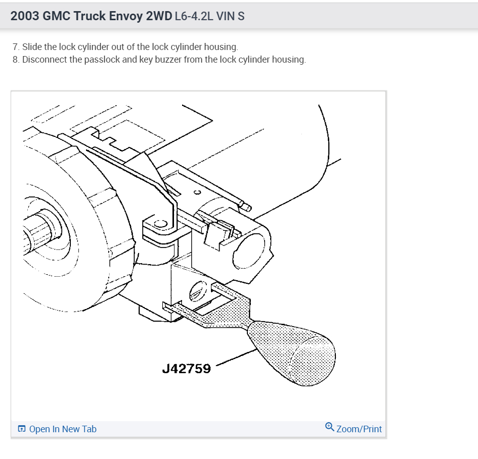

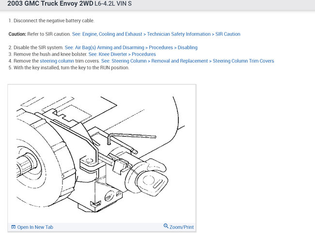

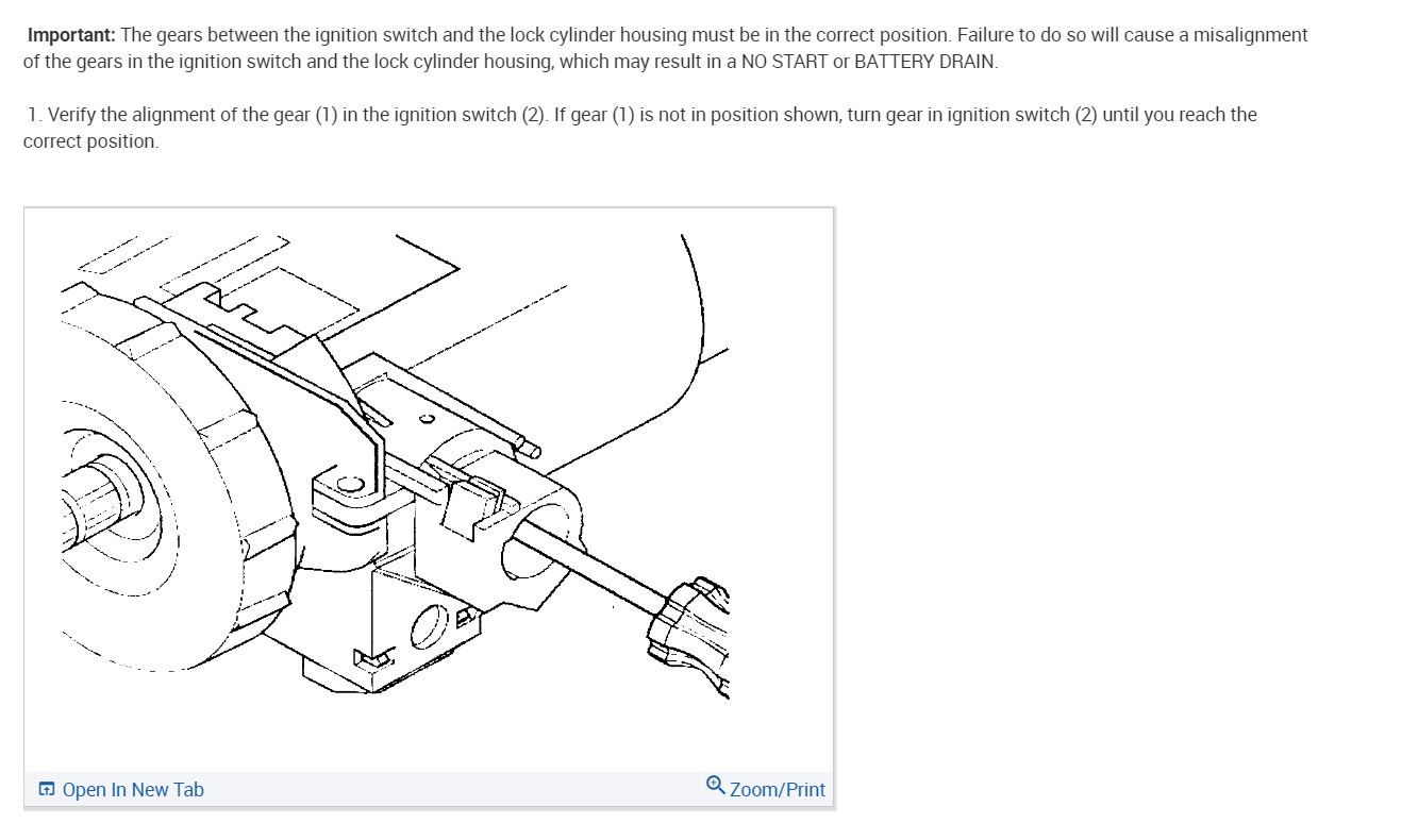

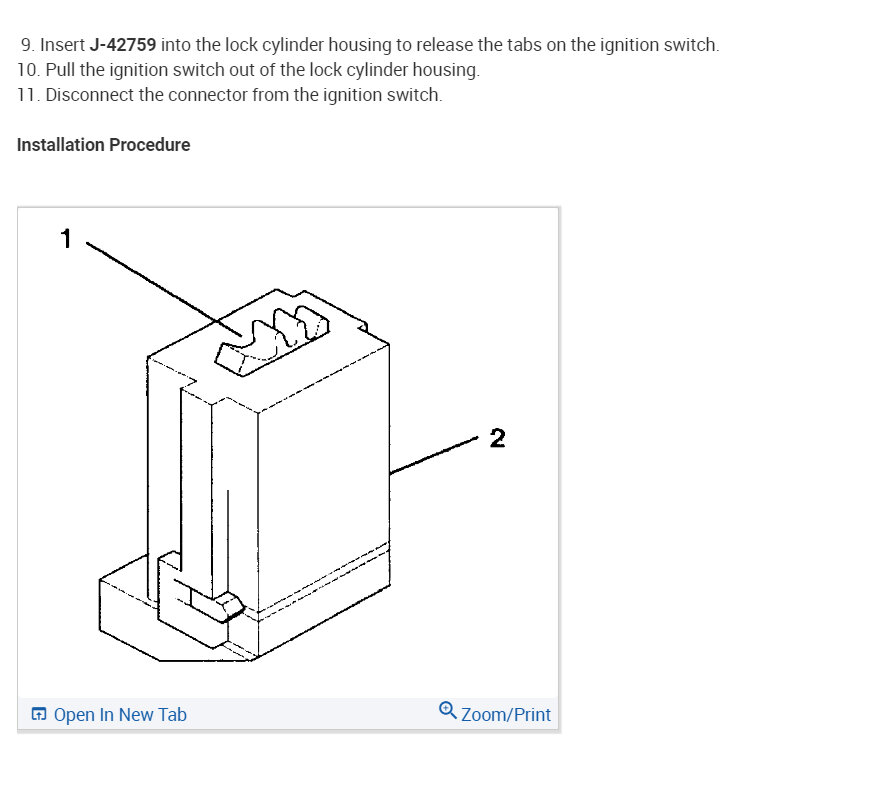

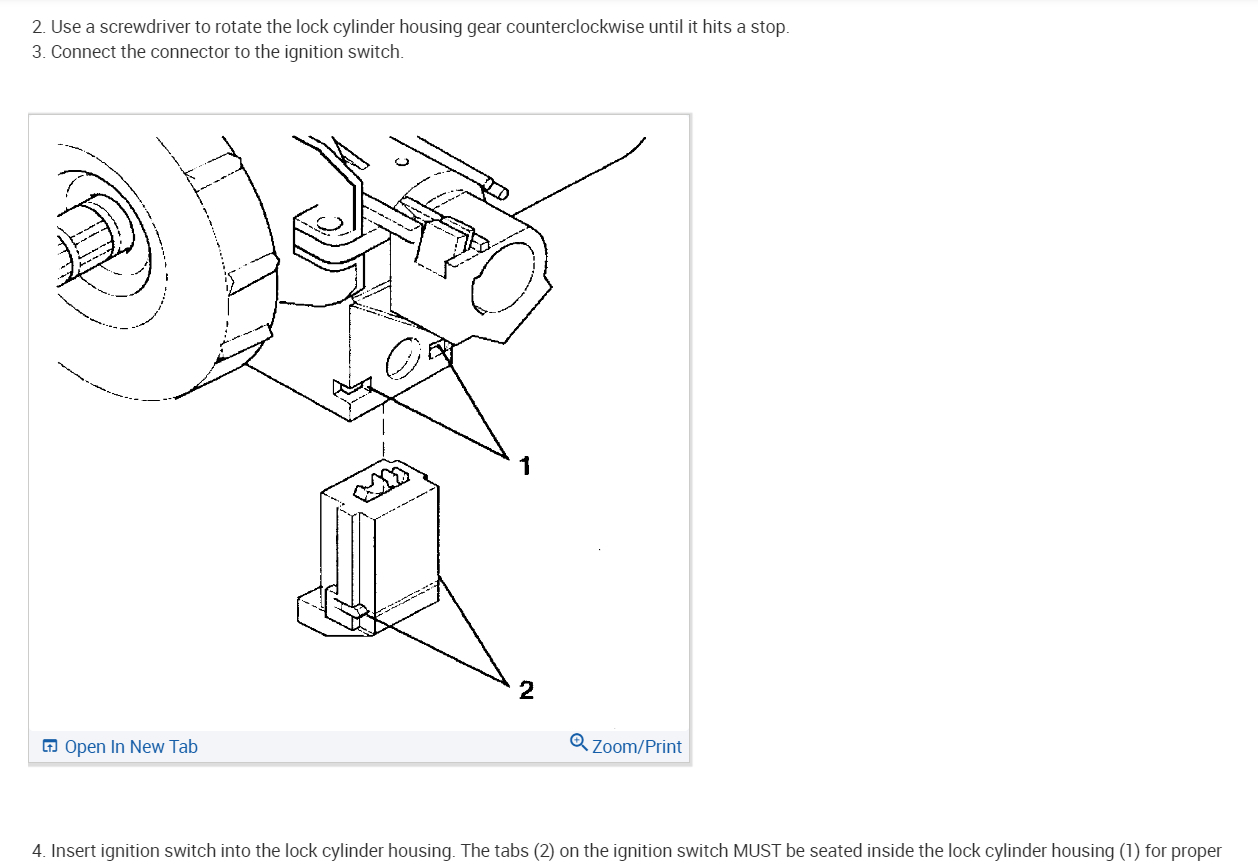

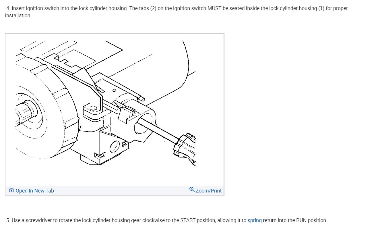

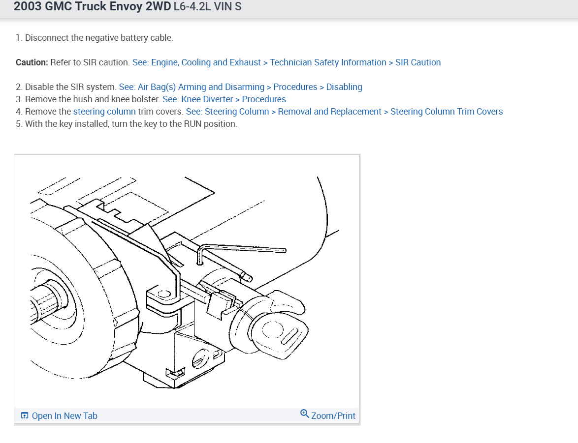

The key will turn all the way to start but will not turn all the way back as it should. The brake pedal is up all the way and hard cannot be pressed down. The shifter will not move. The battery is fully charged. I drove it home and about 2 hours later I went to leave and there was nothing. please help.
May 23, 2023 at 4:40 AM
  • 55,456 POSTS

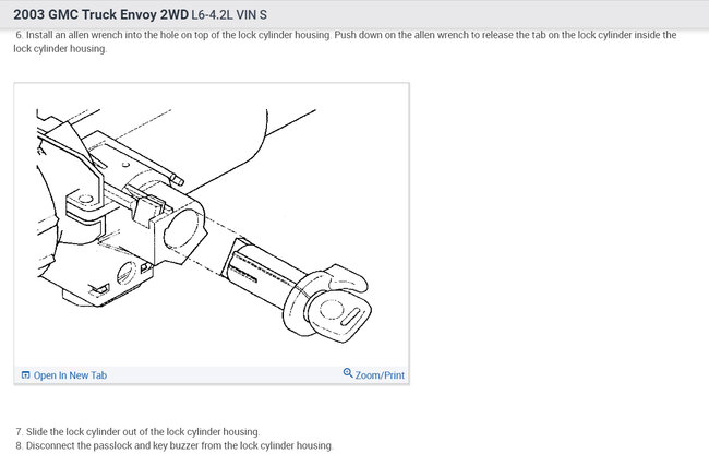

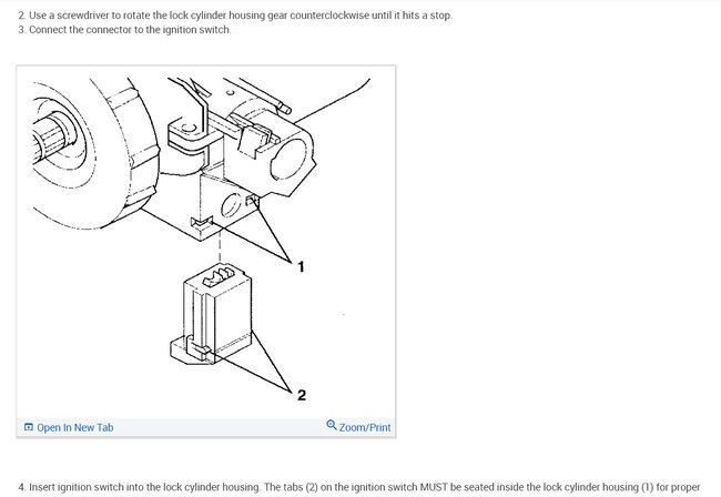

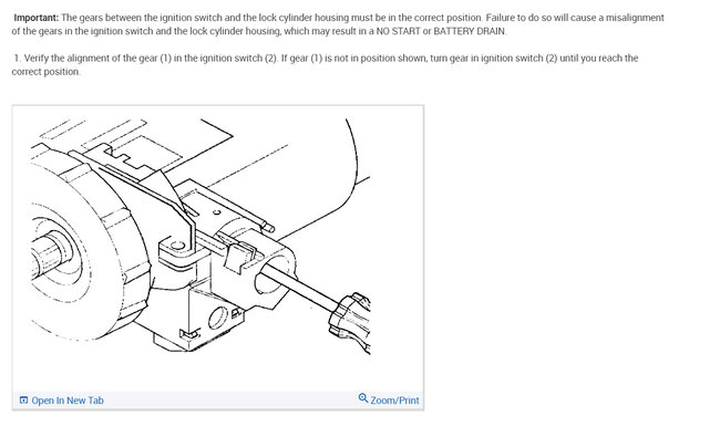

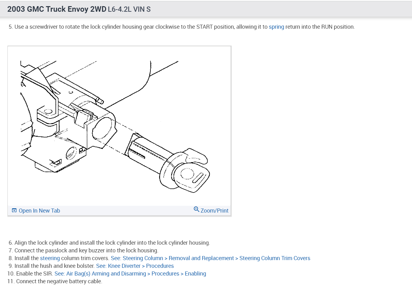

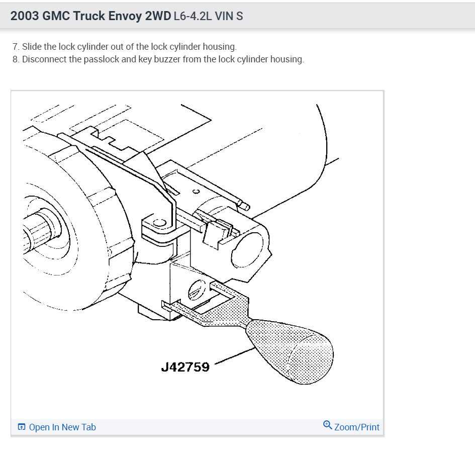

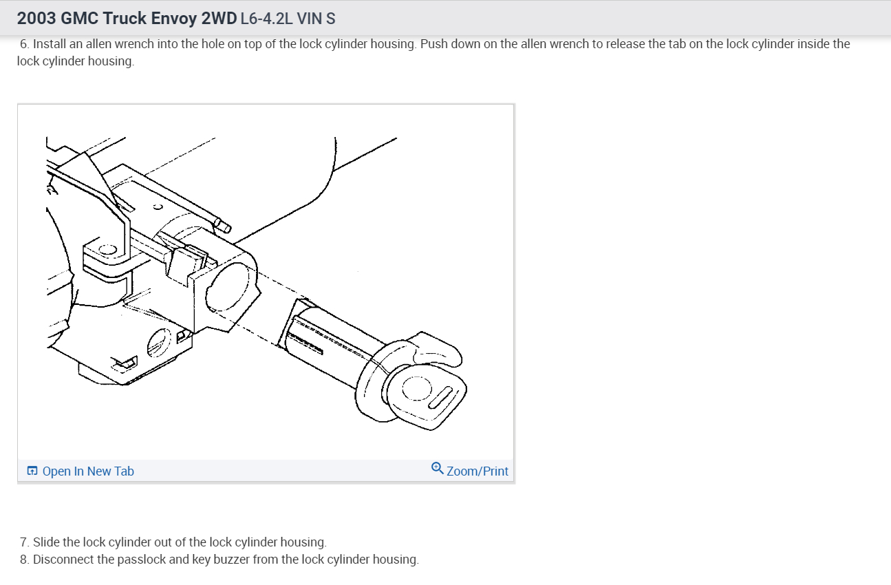

This sounds like a typical ignition switch operation failure here is how to change it out in the images below. Check out the images (below). Let us know what happens and please upload pictures or videos of the problem so we can see what's going on.
