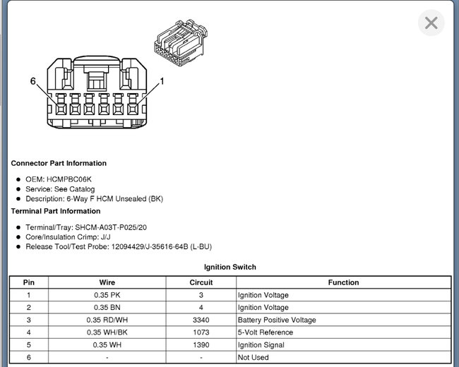

I came out of work, found that there wasn’t any power in the vehicle, the gearshift is stuck in park, turn the key, nothing happens...I put a new battery in it 3 months ago, haven’t noticed any change in how it drives. I replaced the ignition relay, no change. A coworker had a portable battery charger, hooked that up, no change. It seemed to show the battery was fine. Any suggestions? Thanks

There are a number of things that come to mind but the first and foremost is we have a fuse issue that is causing a power issue to the ignition switch.
So, I would suggest we start with checking the fuses and make sure you have power on both sides of the fuse with the key in the on position.
Next, we should go to the ignition switch and check for ignition voltage on pin 1 and 2 then battery voltage on pin 3. This will be 12 volts but you should have 12 volts all the time on pin 3 and then 12 on 1 and 2 when you turn the key.

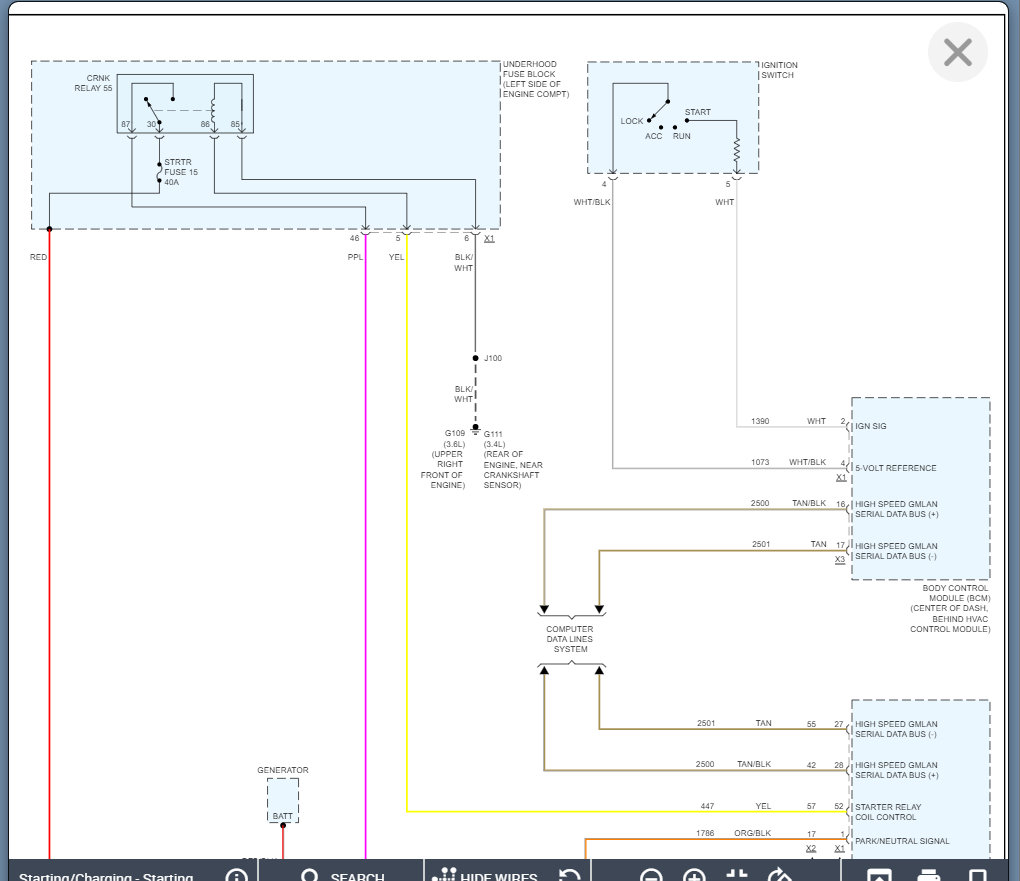

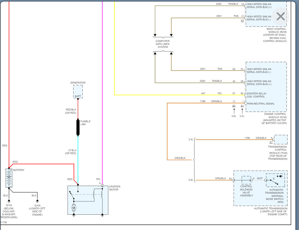

I attached the wiring diagram and pin out diagram that will help with this.
Please let me know what you find, and we can go from there.
Thanks
