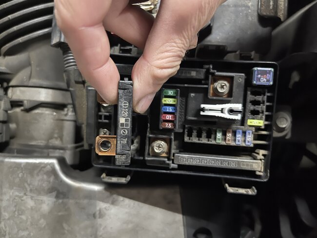

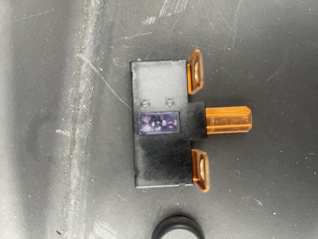

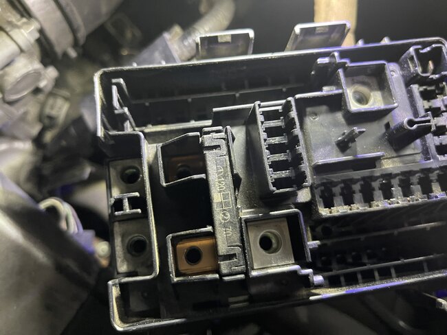

Bought it non-runner. Battery dead and measures close to 0. With a jump box nothing, removed cables and attached to jump box still nothing, no lights on dash, remote does not work, no signs of life. If I am not mistaken, the box next to the battery has a fusible link or more. I removed one and i think it looks good if I am not mistaken. If i try to connect a wire from battery positive to one side of the fuse it sparks, the other side does nothing. There are 2 other ling ones but am not sure where to look first.

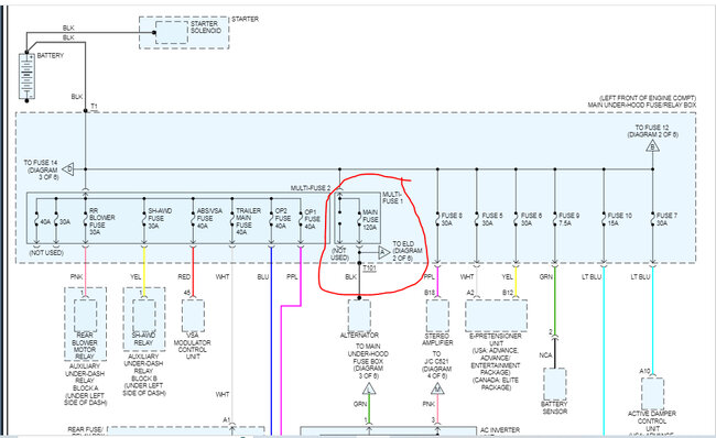

Have you checked the fuse for continuity? There is a main 120-amp fuse under the hood. I attached a portion of the power distribution circuit below for you to reference.
Take a look at the schematic and see if that is what you are seeing. Show me which terminal sparks when you attach the battery jumper.

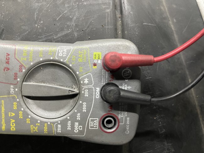

Thanks. Can you tell me how to check for continuity if the fuse?
Jan 11, 2023 at 7:33 AM
  • 110,251 POSTS
You will need a multimeter to perform this. When you check continuity, basically you are checking to see if power goes from one place to another. The measurement is done in Ohms of resistance. In a perfect world, you want no resistance.
If you look at the last test of the following link, it shows a wire being tested for resistance/continuity. You will be doing the same thing with a fuse from one end to the other.
Let me know if this helps.

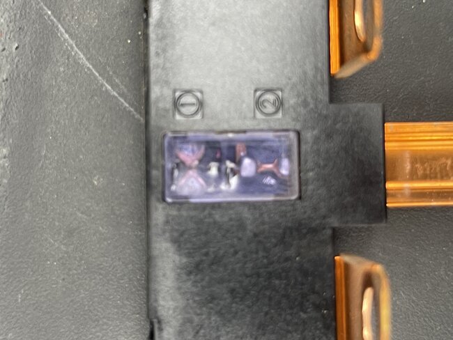

Yes, the picture i sent you is for the 120 amp. I tested it with multimeter, nothing happens when i touch the 2 ends, whether it's on ohm resistance or continuity. It sparks when i touch the right side if the fuse.
Jan 11, 2023 at 7:49 AM
  • 110,251 POSTS
If you are not getting power through the fuse, it needs to be replaced. The thing is, what caused a 120 amp fuse to fail? WHen you say it sparks, what sparks in the pic above?

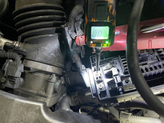

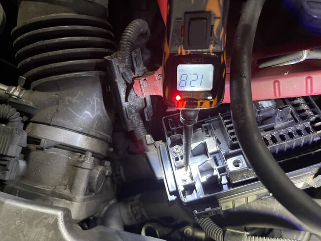

Using a probe, one side is 12v the other is ground. I think it sparked cause i was attaching a wire from positive to that side which the probe indicated as ground.
Jan 11, 2023 at 7:56 AM
BHAMDOC1973
  • 2,007 POSTS
Even when connecting a jumper box , after attaching positive terminal then trying to attach the ground to the battery's negative post it sparks a bit more than it should.
Jan 11, 2023 at 7:57 AM
  • 110,251 POSTS
I would have to see the extent of the sparking. Some can be considered normal from low voltage draws at all times.
I watched your video. If the fuse between those two points is good, you would have power on each side and not ground on one of the sides. Remove the fuse and confirm continuity, which I feel won't exist. If there isn't continuity within the fuse, the next step is to replace it and see if it fails again. If it does, then we have a short which could be anywhere. If that is the case, let me know and together we will start eliminating possible issues. Also, if the fuse does fail again, disconnect the battery and remove the fuse box to see if there is anything damaged under it where the connectors are located.

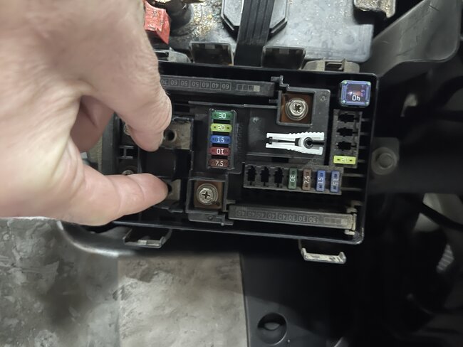

What I would suggest is this. Remove the fuse. Using a multimeter, check for continuity to ground between the return side where the fuse goes (not the power supply side).
If there is continuity, remove one fuse in the box at a time to see if there is a specific fuse that eliminates the ground.
Try that and let me know what you find.

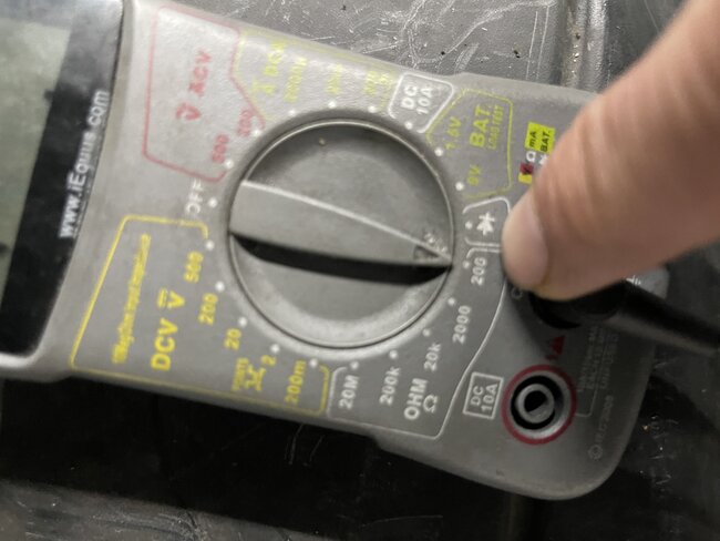

Hmm, that makes sense. So, continuity would be to check between where it is grounding at the fuse and the chassis or battery terminal and once a fuse is removed and ground is out that is where the issue is.
Jan 13, 2023 at 9:09 PM
BHAMDOC1973
  • 2,007 POSTS

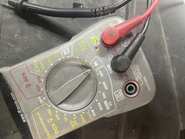

So, with a voltmeter turn it to volts and touch on battery and other end to the end if the fuse that was coming as ground? I did but nothing was reading. I could not understand from the link how to do it as far as removing a fuse by one to see if it eliminates the ground from the fuse end.
Jan 14, 2023 at 1:59 AM
BHAMDOC1973
  • 2,007 POSTS
Sorry read it wrong, with a connector to ground and other end to the fuse end where it sparks it reads about 25 , sometimes more or so when the voltmeter is on continuity test.
Jan 14, 2023 at 2:03 AM
BHAMDOC1973
  • 2,007 POSTS
I removed each fuse in the box while voltmeter on continuity and one end to round and the other to the fuse end in the box, while fuse is off, but none of the fuses resulted in the numbers to go to zero.

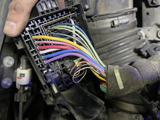

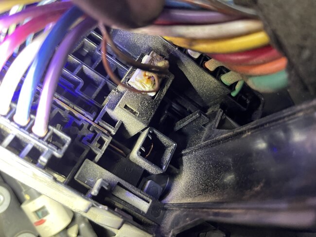

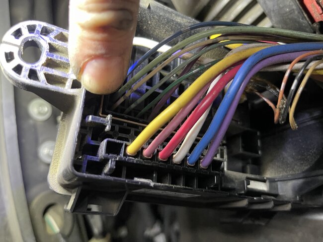

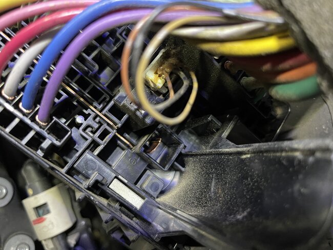

I am not seeing anything burned or weird under the box. But isn't the fuse which is snowing on bottom supposed to connect to something? Or is it just made like this to sit inside the box, weird that the end of the fuse which comes out of the box underneath connects to nothing. I am guessing the issue with the 120 fuse since it still sparks with nothing else connected and even with the battery jumper only connected to the jumper box.
Jan 16, 2023 at 10:57 PM
BHAMDOC1973
  • 2,007 POSTS
More.
Jan 16, 2023 at 10:58 PM

Okay progress. I followed the positive cable that goes from the box to alternator, found a previous work was done on one of the coils which melted before the repair or after, disconnected the 3 front coils, no change. kept following the sane wire to alternator, removed the positive cable which has a nut on the alternator and now it does not show ground on the 120-amp fuse. Connected all the fuses that i removed back and now it does mot spark, but no power inside other than interior lights, nothing when i turn ignition on.

Take the alternator to a parts store and have them bench-test it. They will likely do it free of charge. It appears there is an internal short. Also, take a pic or two of the wire repair you mentioned.
