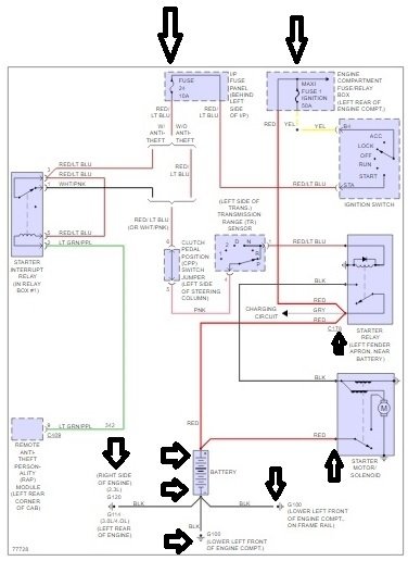

I have a hydraulic Tommylift on my ranger. i was fixing a leak in it it was not tighten right so when the cables started to move it sparked twice and everything went out. What do i do to get it started? It ran great until now.

Things like an anti-theft system/ fusible link might be possibilities.
I have found many times that even simple stuff can go wrong with a cross connection situation and have you "wanting" to chase down the hard stuff.
Before we get all flustered and involved, check the darn clamps and wires to the clamps at the battery, there may have been a little "pop" or "snap" that you did not get to see, now leaving you a bad connection.
Next thing to look at is the wires/ cables from the battery (positive and negative) look at their destinations, same thing may have happened there too.
I uploaded a diagram from "Prodemand" of the "starting circuit".
(click on it below)
I did not see a fusible link in the diagram, but there are a few fuses listed. Their size and locations are on the diagram.
Let me know how it is going, I can get other diagrams if needed.
