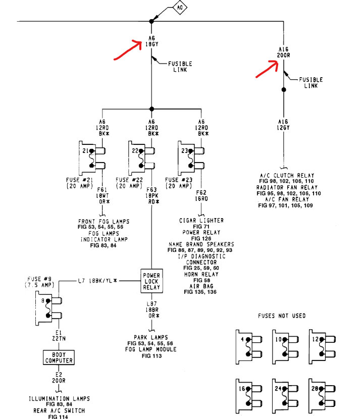

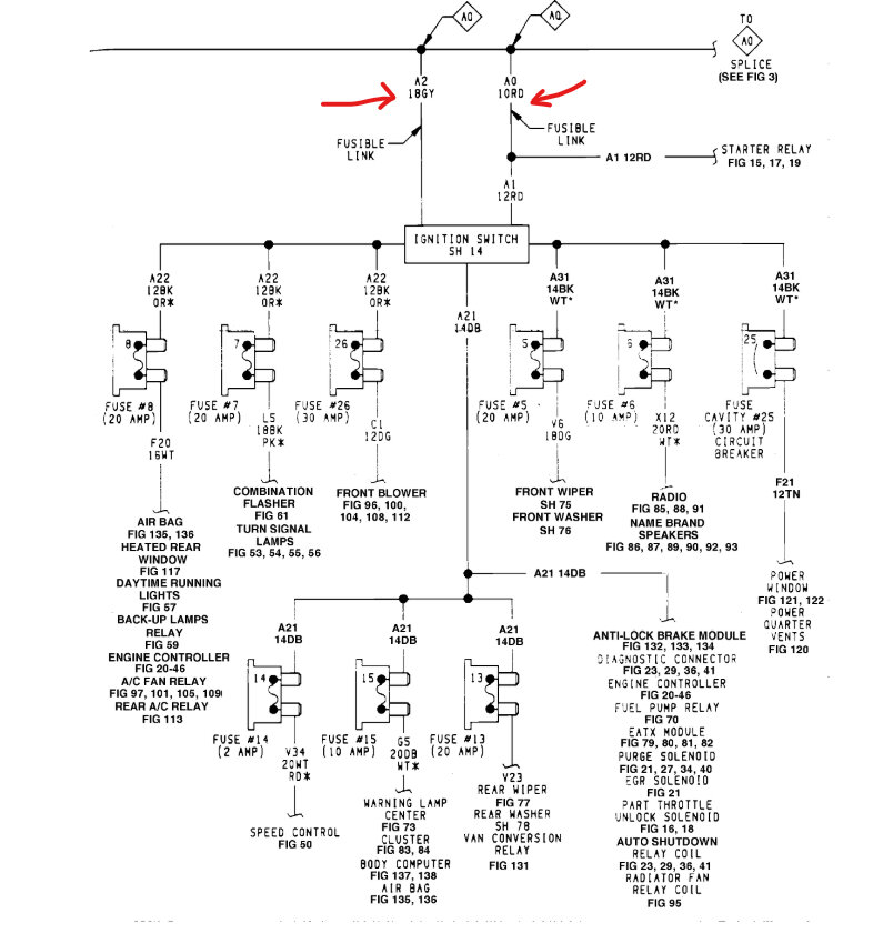

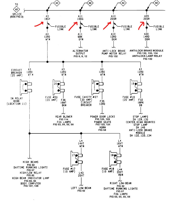

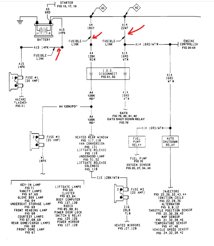

To me it sounds like the positive battery cable, or a fusible link is bad. The links are near the battery. I would try pulling on them to see if one will come apart and lets you know it is bad. Here are the links so you can see what they power. Check out the images (below). Please upload pictures or videos in your response of any problems so we can see what to help you with.

That was my thought, also. Thanks for the road map to these links.
Two pins in the ignition switch harness (A1 and A2) currently show 12v. I have also cleaned all relay plugs in the engine bay, checked all fuses and circuit breakers and cleaned the plugs by the battery. I keep the engine compartment clean and regularly clean ground connections and the battery cable connections and check for drops. All relay sockets showed light corrosion. Now it's on to the fusible links. Thanks

I have had problems in the past with the links FYI. You should find the problem there.

And I say you are absolutely right. It may still be connected but having a high resistance from old age. etc.
So far, one questionable fusible link at battery, but it only goes to the emergency flashers which work (pink wire), according to wiring diagram. My next step is run a fused line from the battery directly to terminal A1 on the ignition switch, replacing the existing wire and go from there. (An old 1960's fix for bypassing bad switches.) Luckily this 1992 system is pretty primitive compared to today's systems. Should work and would give a snapshot of the upstream wiring situation. If the vehicle still will not start and run, then the problem must be downstream from the ig switch, which could be a head scratcher.

Yep, that solved the problem. Ran a fused line from battery + to ignition switch red terminal. Works better than before since there is no voltage drop at all to the ig switch.
