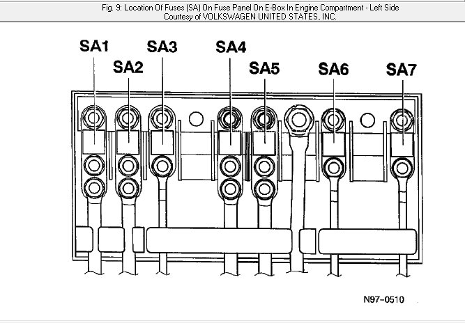

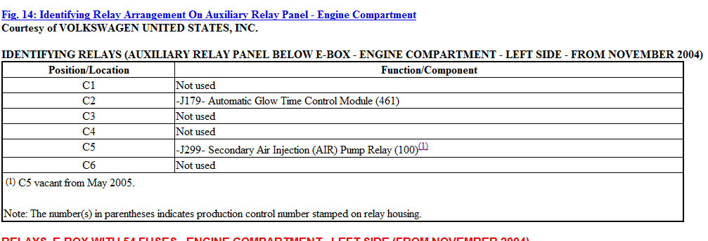

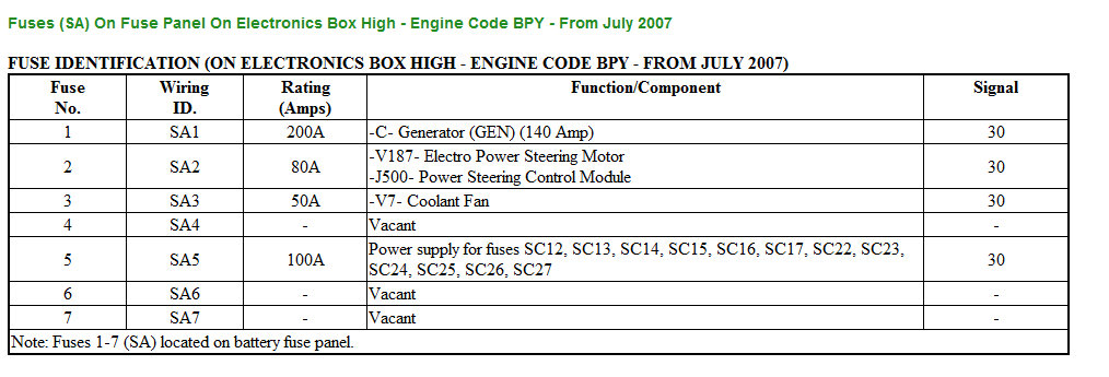

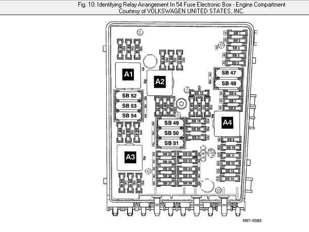

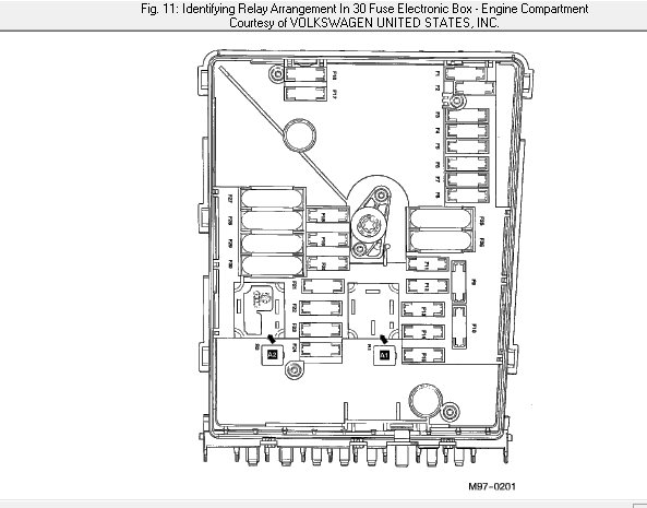

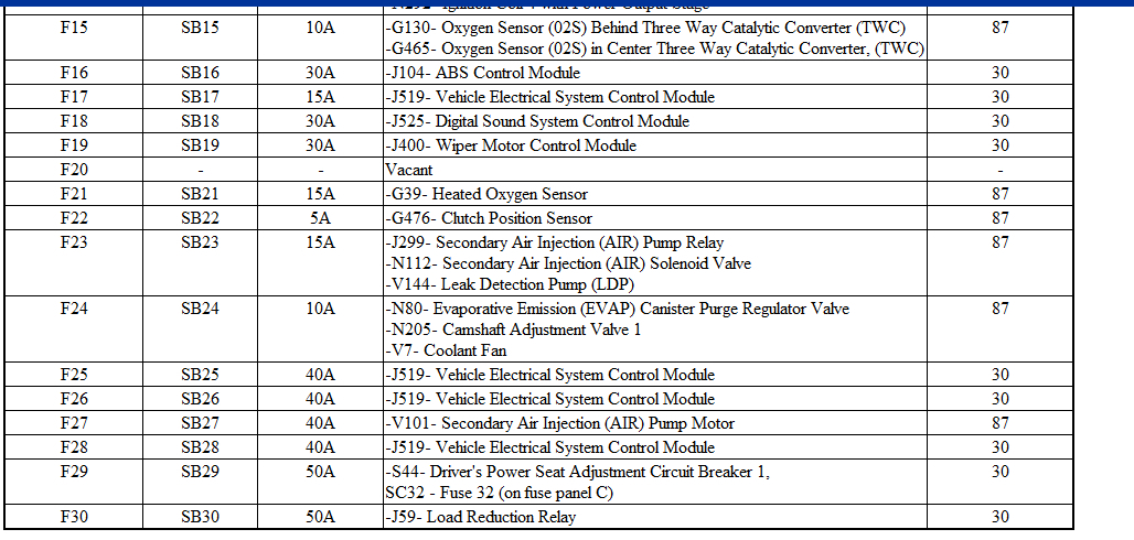

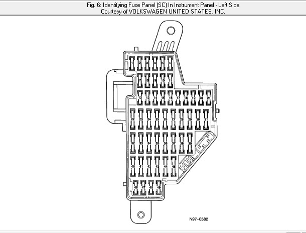

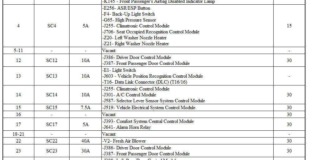

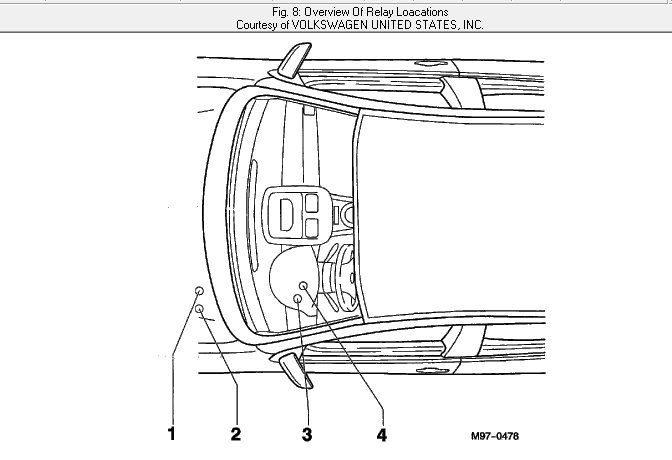

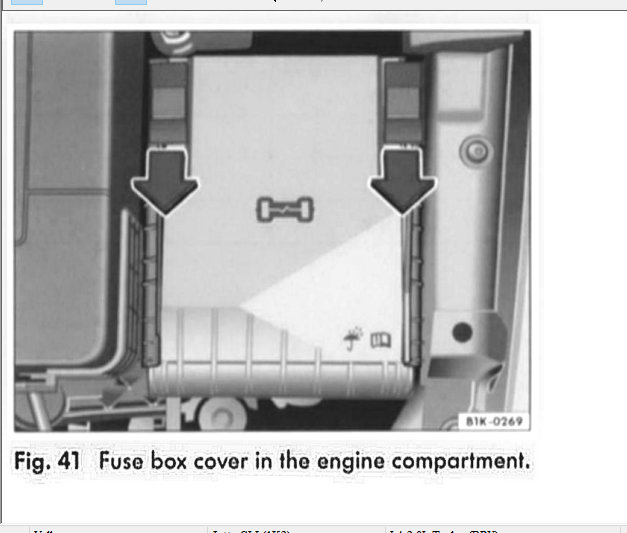

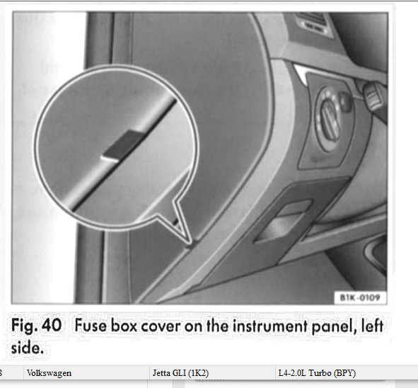

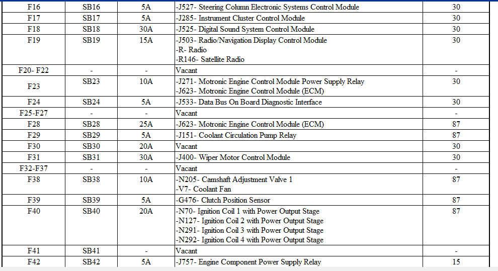

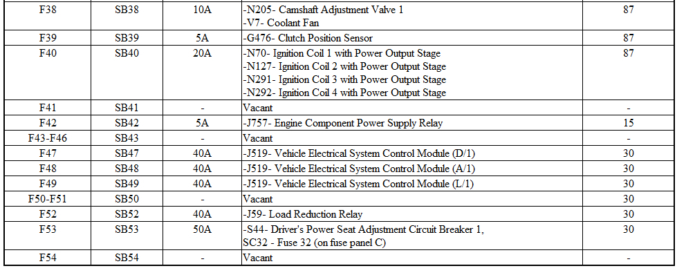

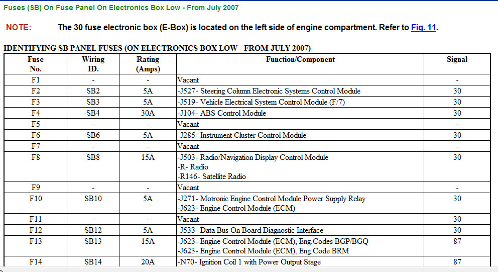

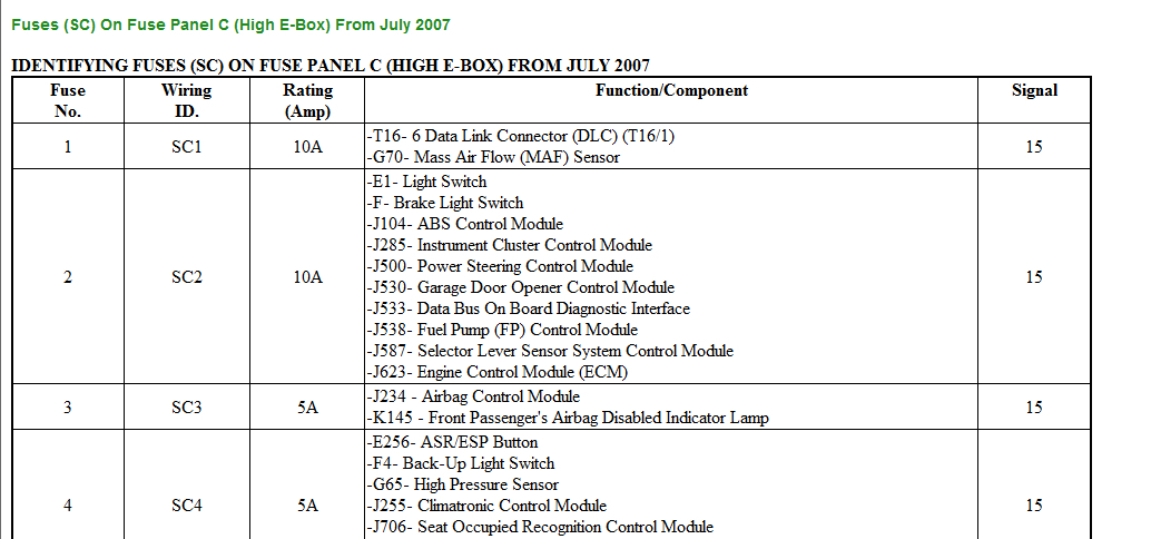

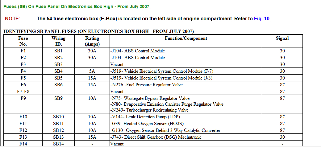

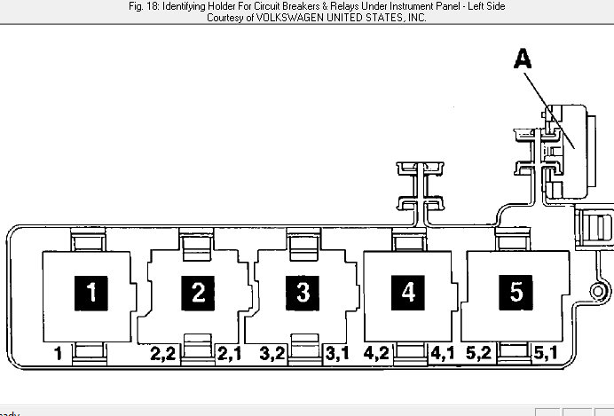

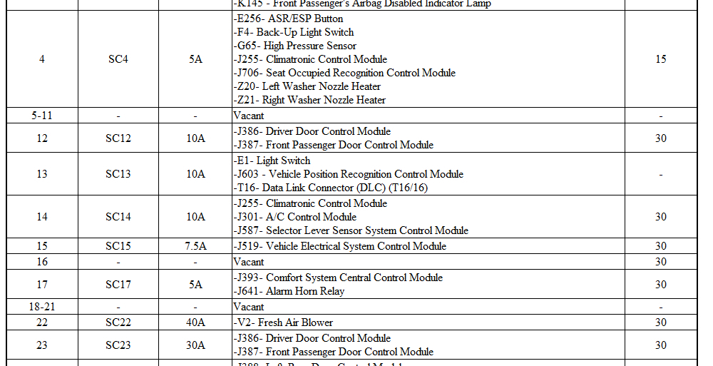

No power please help.
Monday, January 25th, 2021 AT 2:16 PM
SEVAG P
MECHANIC
405 POSTS

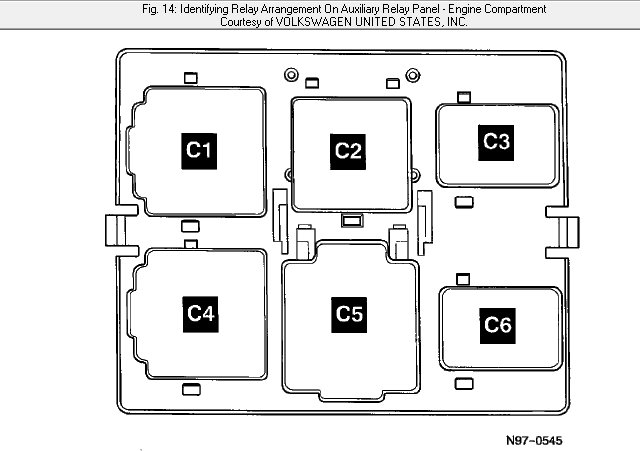

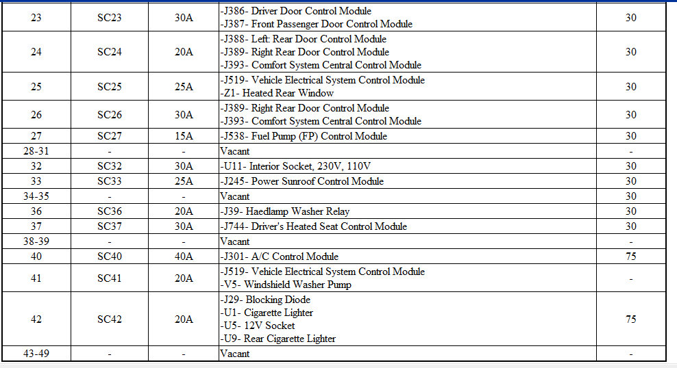

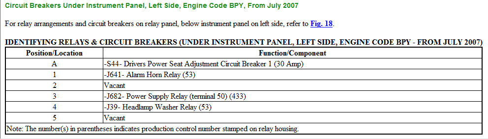

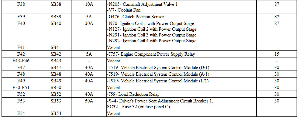

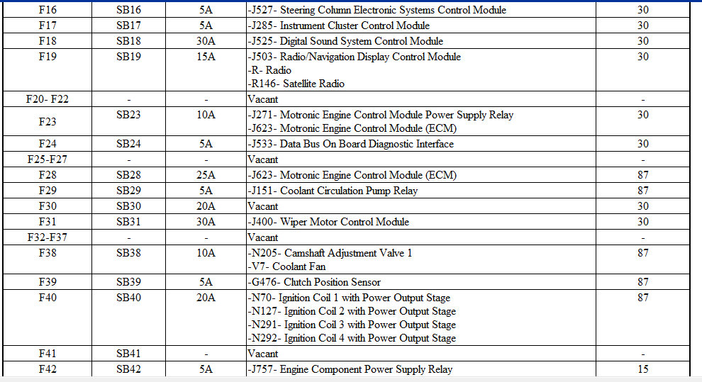

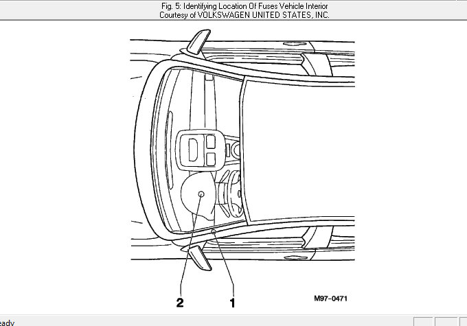

can you explain more in details what's the problem that we can help for diagnosis?
check the pictures below, fuse and relay locations.
check the links below how to check fuse and relay.
