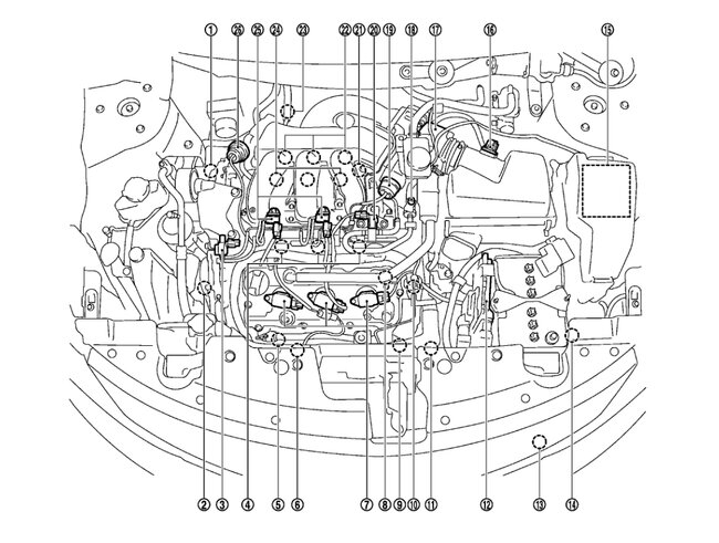

So, what is happening is the PCM is going into limp mode most likely because it cannot control the throttle which is common. This is caused by a dirty throttle body.
Here are two guides to help you understand what's going on and how to service the throttle body on your car in the images below:
and
https://www.2carpros.com/articles/reduced-power-limp-mode
It is #31, Check out the images (below). Please let us know what happens.

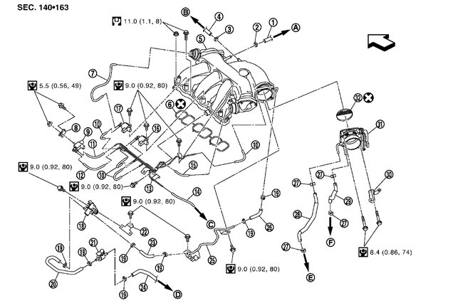

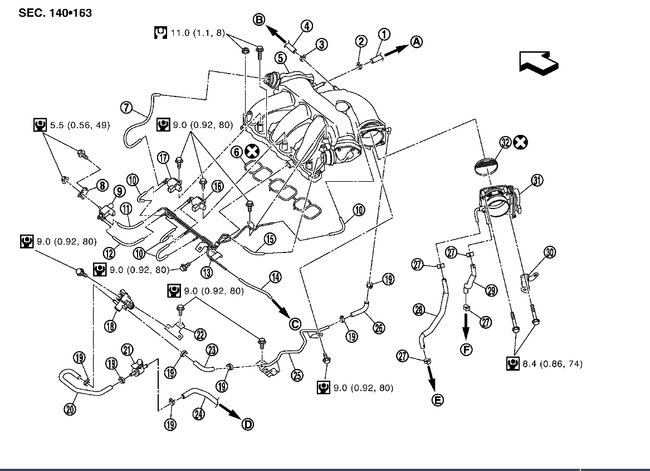

So, this engine has a VIAS system that closes and opens the intake runners inside the intake manifold. I would check the vacuum lines going to the actuators. here is the vacuum line routing diagrams so you can check it out. Check out the images (below). Please let us know what happens.
Oct 13, 2022 at 5:31 AM

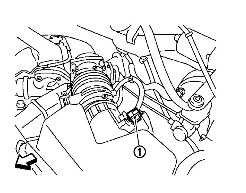

It could be the MAF sensor or the engine coolant sensor. I would try the MAF sensor first here is the location and instructions on how to do so. #1 in the image below.
Oct 15, 2022 at 4:56 AM
