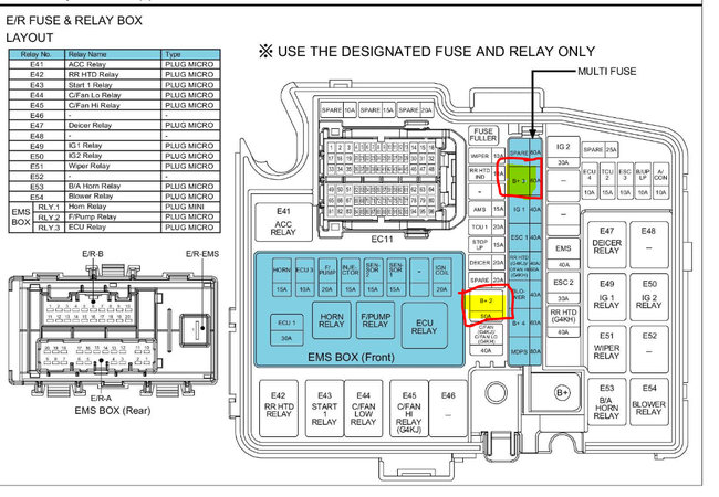

I turn the key and motor turns over but no power to anything inside the car. What could it be?
Dec 20, 2019 at 12:20 PM
  • 110,240 POSTS

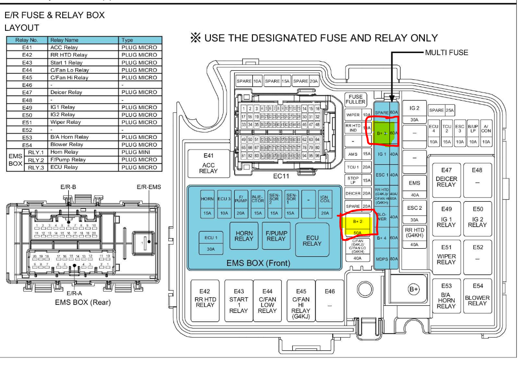

There are two fuses under the hood of the vehicle (power distribution box) which supply power to the instrument panel fuse box. I attached a pic below of their locations. Check both of them.
Here are a few links you may find helpful:
If you find a bad fuse, only replace it with the same type and amperage.
Let me know what you find.
