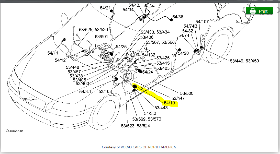

No power to my radio and and 12 volt auxiliary outlet
177,000 MILES
JOHN DELGADO
I checked the fuses and they are good. What else it could be?

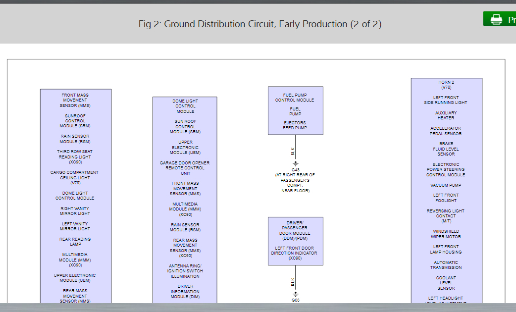

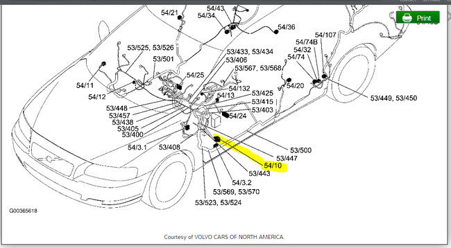

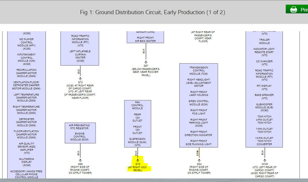

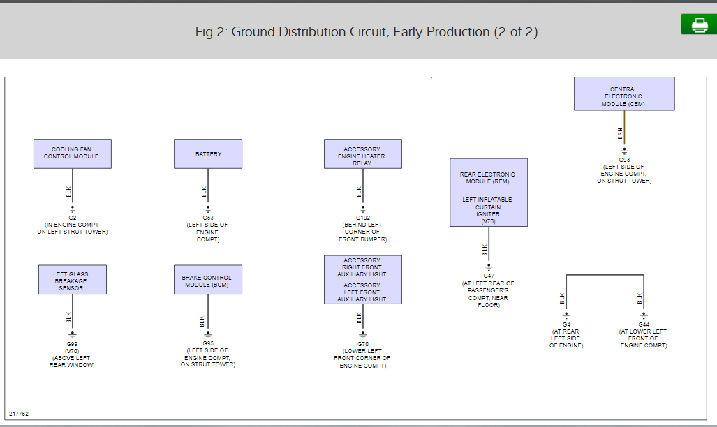

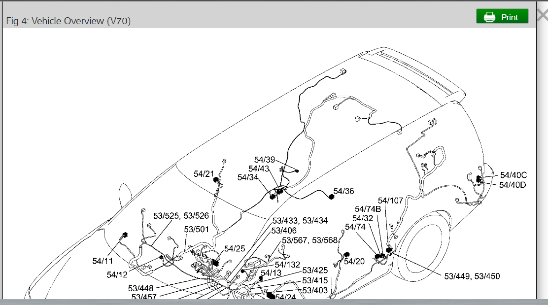

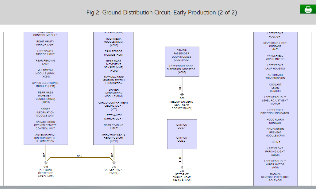

This could be a problem with a shared ground which is at the drivers side kick plate. Please check this ground and make sure that is clean, corrosion free, and making good metal to metal contact. This ground is only shared by the radio and the 12 volt outlet so it's a pretty good bet that this is your problem. In the diagrams down below I have included a diagram with the ground location as well as a Technical Service Bulletin (TSB) on improved 12 volt power outlets for you to go over. Please check out the ground and get back to us with what you find out.

Thanks for the advice but there's is no diagram. Can you please send it, thanks

I'm sorry about that. Here are the diagrams and ground location in the diagrams down below. Please go through these guides and please get back to us with what you are able to find out, please.
