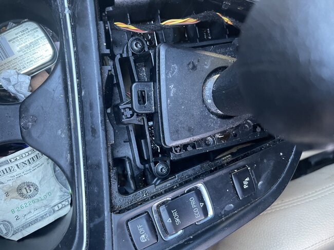

Bought it as a repo car. Since i have no way of getting into the trunk i only used the jump box under the hood, when i connect i am only able to press the button on the cluster to see the miles, placing fob by steering does nothing but i see the stop/start button let, the gear shifter flashes on N, since it was towed and was out in neutral. I am not sure how to get it off of neutral and into park as pressing the p button does nothing. And trying to get into the trunk but there was no key hole for it and the fob does nothing. Can you find out if there is a way to get into the trunk?

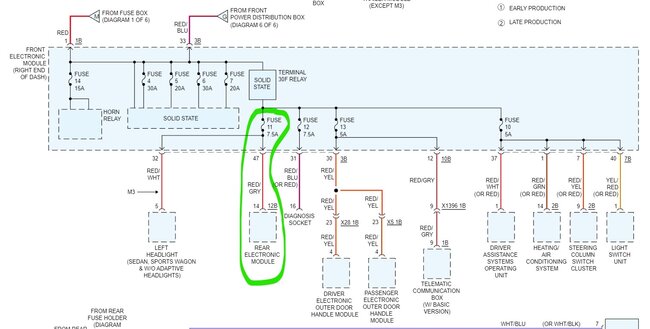

I found the area around the FEM module; the carpet is kind of damp. Is that a possibility that the FEM has got issues?
Feb 3, 2023 at 7:00 AM
STEVE W.
  • 15,352 POSTS

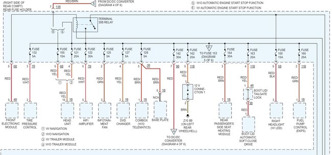

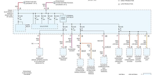

That is not a good sign water in any of the modules that are network connected can cause a lot of unexpected things to happen. In this case the FEM also controls the rear power module in terms of it powering on properly. Take a test light and see if you are showing power on fuse 11 in the FEM. If not, you might try using the jump box and applying power to the circuit with the fuse out and see if it powers the rear module on enough that you can at least get the trunk to open and maybe if it powers up it will let you shift into park.
Feb 3, 2023 at 8:00 AM
BHAMDOC1973
  • 2,007 POSTS
But if the fuse is good?
Feb 3, 2023 at 8:03 AM
STEVE W.
  • 15,352 POSTS
If the fuse is good, does it have power? That one should power on with the push to start. The problem is that most of the power circuits for the system are in the rear.
Feb 3, 2023 at 9:14 AM
BHAMDOC1973
  • 2,007 POSTS
Yes it has power on both sides.
Feb 3, 2023 at 10:32 PM
STEVE W.
  • 15,352 POSTS

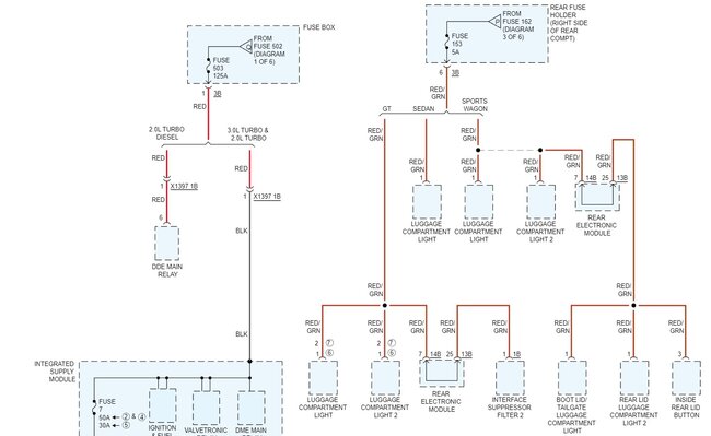

Okay, then the rear box should be waking up. The rear trunk release under the trim does nothing either. The interior and exterior use slightly different paths to release the latch but then you still have the lift motors to deal with. I don't see any good way to get the trunk released without having full power to the vehicle. I sort of wonder if someone didn't pull a couple fuses in the rear box and then slam the trunk. The neutral lockout it's in should have automatically released as soon as the start button was touched to turn things off. It also should have returned to park as soon as you touched the button when you applied power, but if a fuse was missing so the power to that system was out nothing would respond.

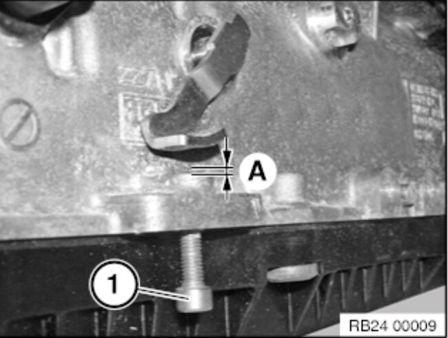

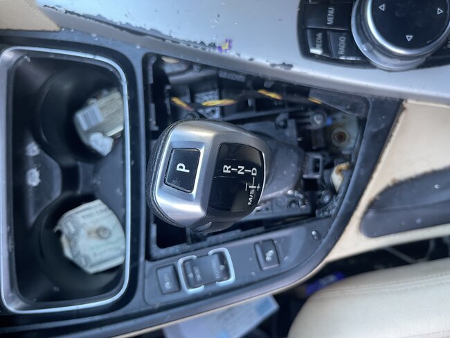

All good finally, had the fem replaced and programmed with the fob, installed it and boom she started. The only thing now is the gear shifter still flashing in neutral, popped trunk and disconnected battery and connected same thing. I am thinking the tow truck must have got it in neutral from underneath. I just don't know what I should be looking for.
Feb 16, 2023 at 10:34 PM
STEVE W.
  • 15,352 POSTS
Okay, go under it, look on the side of the transmission for a hex bolt in the flange of the case at the pan. That bolt pushes the release and locks out park. Remove the bolt and you should get control back.
Feb 17, 2023 at 3:04 AM
BHAMDOC1973
  • 2,007 POSTS
I did, it worked. Thanks a bunch.
