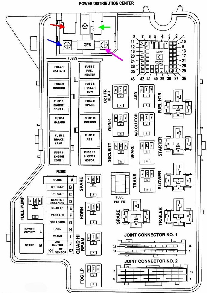

My dome lights will come on but when I go to crank the truck. I have no lights on dash cluster and it kills the dome lights as well when I try to crank it any help.

That's the classic symptom of loose or dirty battery cable connections. Also follow the smaller positive battery wire to the under-hood fuse box and be sure that connection is clean and tight. Follow the smaller negative battery wire to the body and be sure that connection is tight and not rusty.

The high system voltage is another indication the battery is not in the circuit, meaning there's a broken connection. The battery is the key component in helping the voltage regulator do its job.
Did you check the connections on the under-hood fuse box?
Which new terminals are you referring to? If you replaced the cable clamps right at the battery posts, with universal clamps that you bolt the cables to, those are not meant for a permanent repair. They cause way too much trouble with loose and corroded cables under those straps. They're meant to be temporary repairs until the cable assembly can be replaced.
If all the connections look good, the next step is to get the problem to occur so we can look for the defect. Turn the head light switch on so current is trying to flow. That will also provide a visual indication as to when you do something that affects the bad connection.
Use a test light and check at the four places pointed out by the arrows in the first drawing. You should find full battery voltage on all four points. Let me know what you find there.
