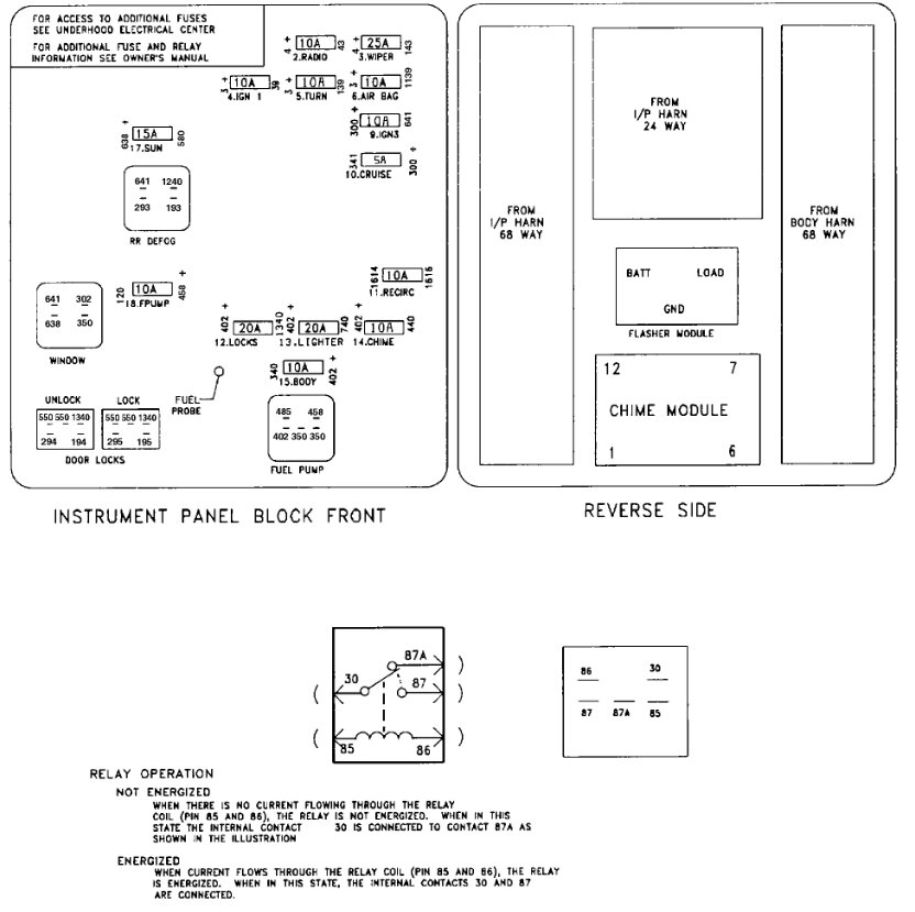

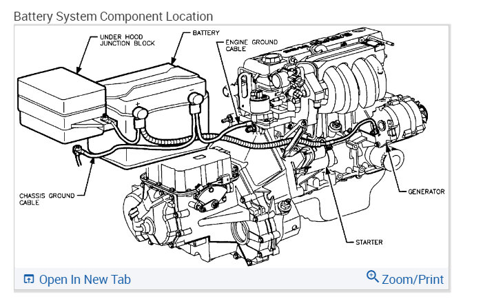

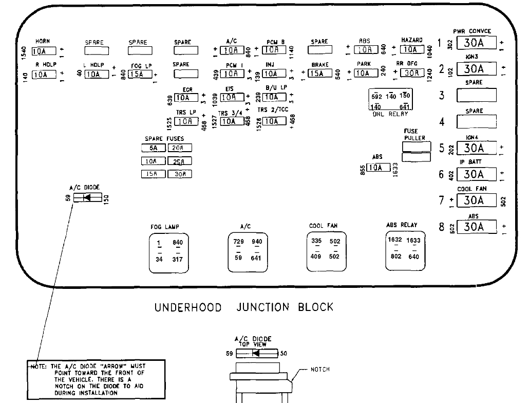

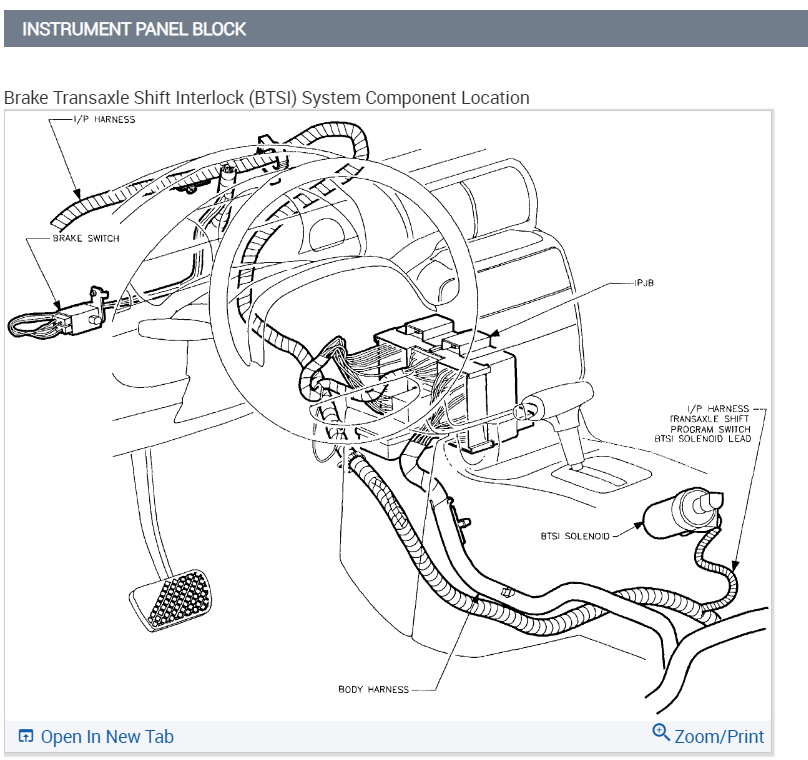

Sure, here is a guide to help you test the fuses and the fuse locations and identifications in the images below.
Check out the images (below). Please let us know if you need anything else to get the problem fixed.
