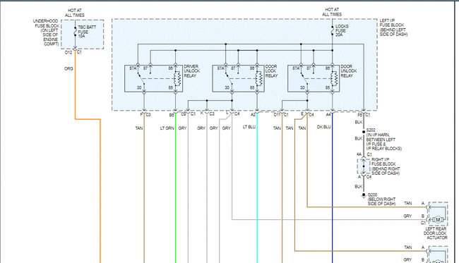

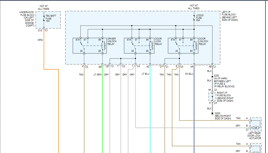

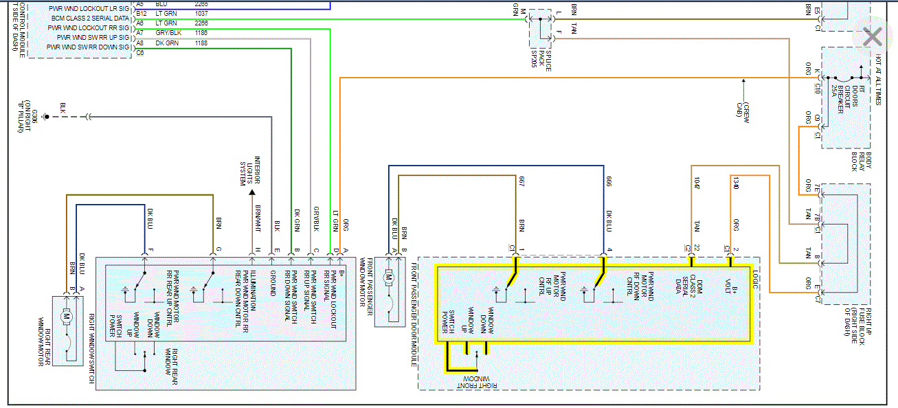

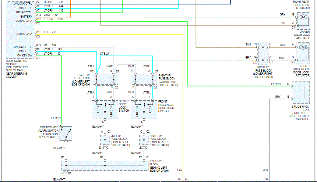

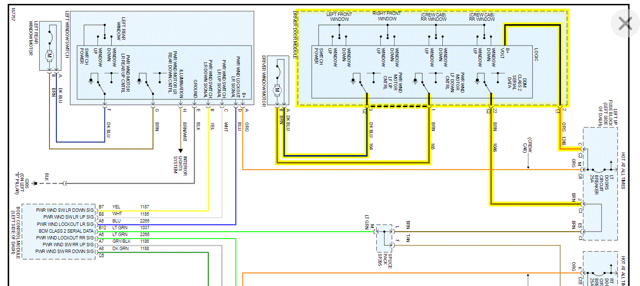

I do not have any power to the drivers door control module all other doors work fine.
Aug 12, 2020 at 3:17 AM
I attached the wiring diagram of the module for you along with the power locks.
Test the fuse listed for power on both sides. If that is okay, I would look at the boot from the body to the door. Inside the boot are the wires going to the module. It is common for the wires to flex over time and break inside that boot.
