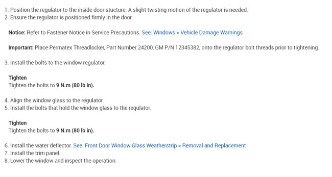

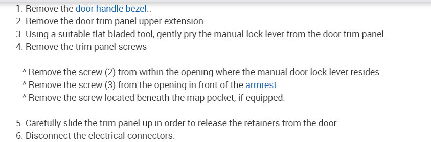

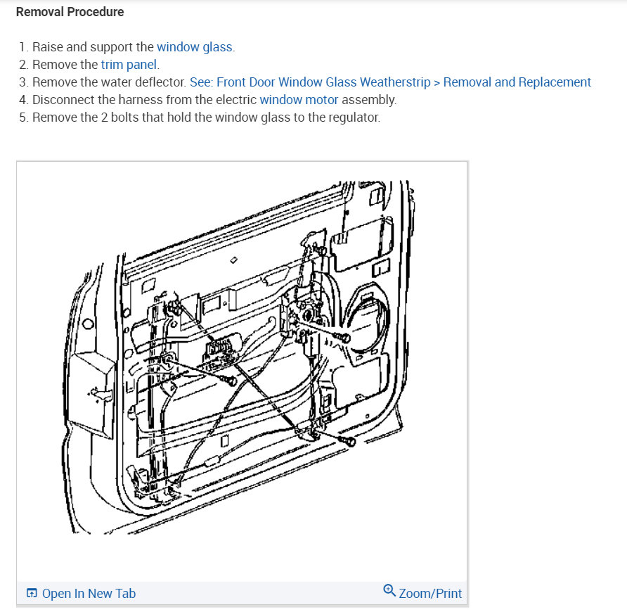

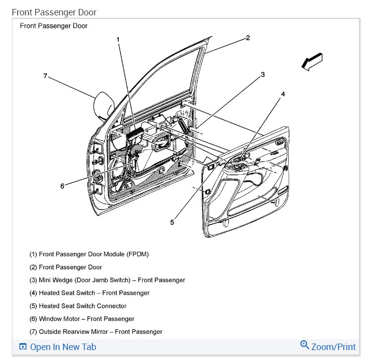

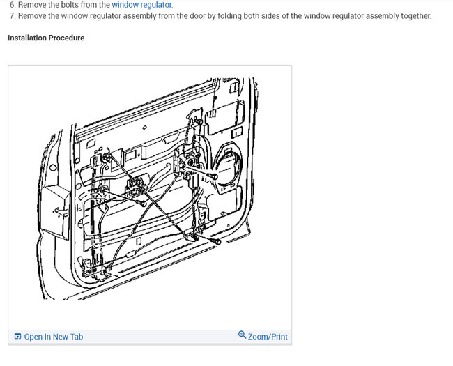

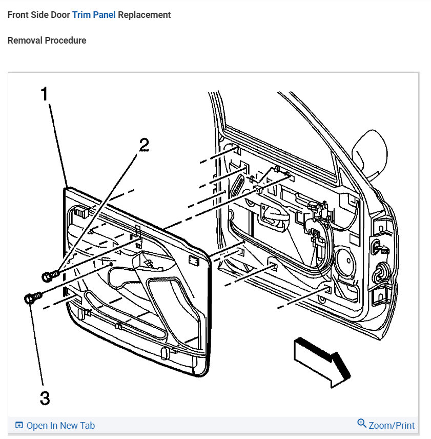

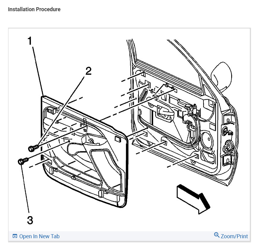

Hello guys! Can anyone assist me with a no power problem on the passenger side of my vehicle listed above? I can't control the window or the lock on that side from the driver switch also. The driver side switches are fine. Thanks in advance guys.
Jun 29, 2022 at 11:48 PM
  • 55,732 POSTS

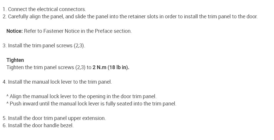

This happens when the passenger's side door module goes out. To be sure let's do a CAN scan which is the future of automotive repair. You can get a CAN scanner from Amazon for about $30.00. Here is a video to show you how and a link to a scanner from Amazon. I have included the instructions on how to change the PDM out in the diagrams below.
