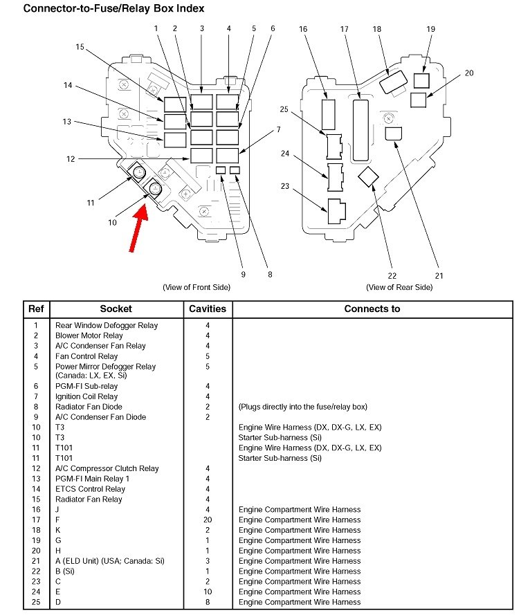

I have replaced battery, battery cables, and alternator and I still have no power!! Doesn't make a sound when I turn the key. Just nothing.

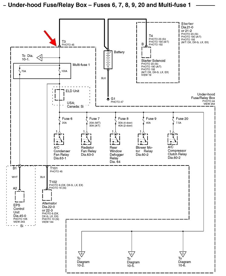

The most common suspect is a loose connection at the under-hood fuse and relay box. Follow the smaller battery positive wire to that fuse box and check that connection.
