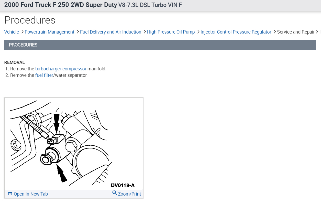

The RPM's don’t go over a 1,000. did fuel pressure test was 50/52 psi. changed fuel filter, changed fuse for the lift pump.
Apr 21, 2020 at 1:19 PM
DANNY L
  • 5,648 POSTS
Hello, I'm Danny.
Well, the fuel pressure is within range. Specifications are 40-60 p.s.i. with key on-engine running. Is there by any chance the check engine light on? Hope this helps and thanks for using 2CarPros.
Apr 21, 2020 at 2:54 PM
AUSTIN ERLANDSON

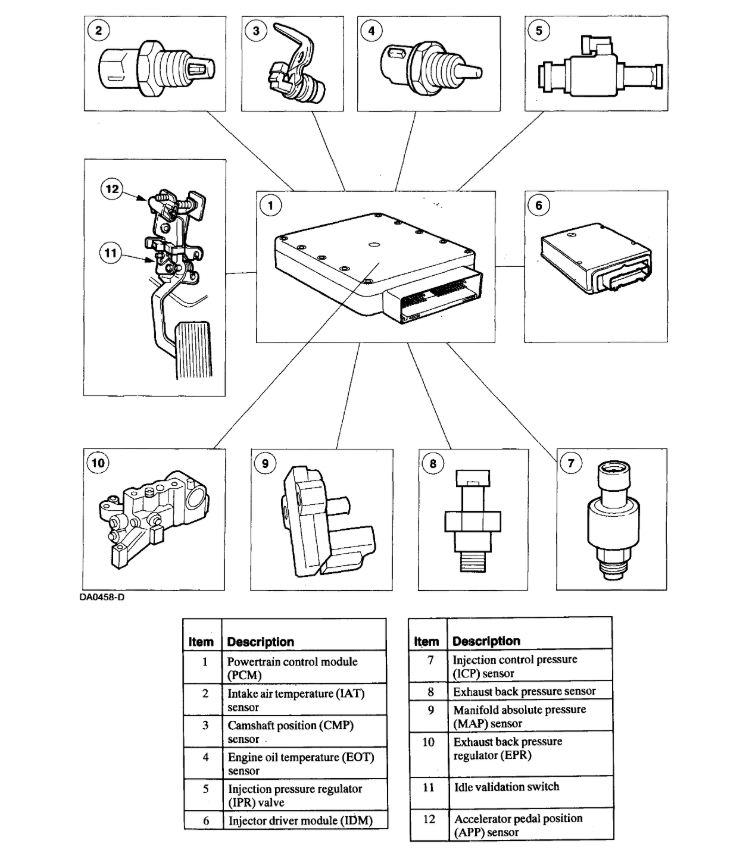

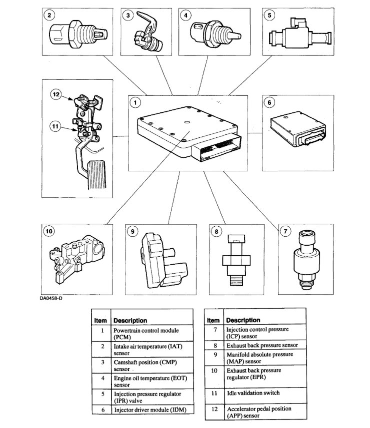

The engine light isn’t on, but the ABS light is on. I read the code with my code reader and I had a code for p1211.
Apr 21, 2020 at 10:54 PM
  • 55,711 POSTS

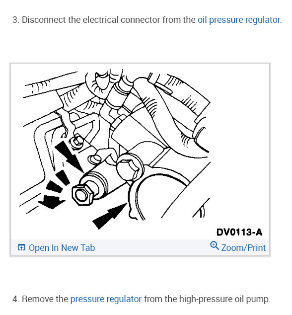

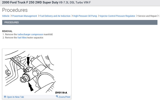

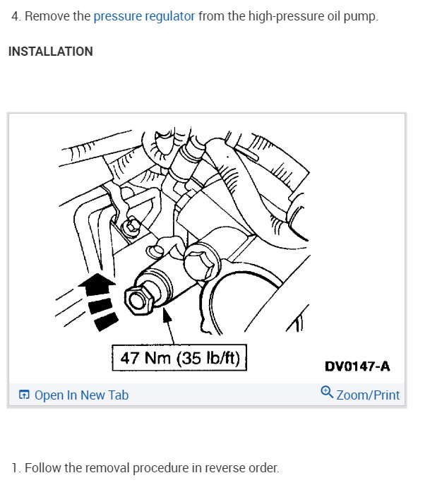

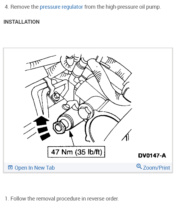

The p1211 code is common when the Injector Control Pressure Sensor goes out. here is the location and instructions on how to replace it in the diagrams below. Check out the diagrams (below). Please let us know what happens.
