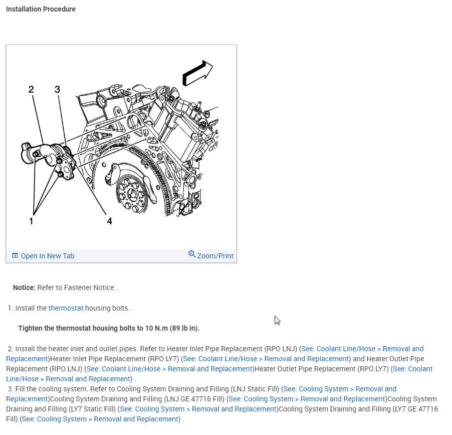

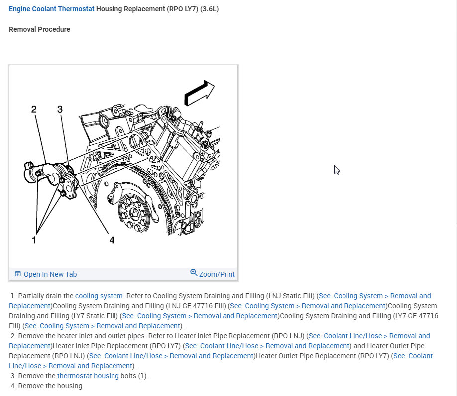

Started overheating replaced thermostat now there is no power
2008 CHEVROLET EQUINOX
150,000 MILES • 6 CYL • 2WD • AUTOMATIC
RAELYN PERRY
The car began to overheat what Cahn I do to fix it?
Feb 2, 2020 at 5:18 AM
  • CAR REPAIR CONTRIBUTOR
We need to start with going back over the job that you just did and make sure nothing was left off or loose. Here is a guide to help you step by step with instructions in the diagrams below to show you how on your car.
https://www.2carpros.com/articles/engine-overheating-or-running-hot
