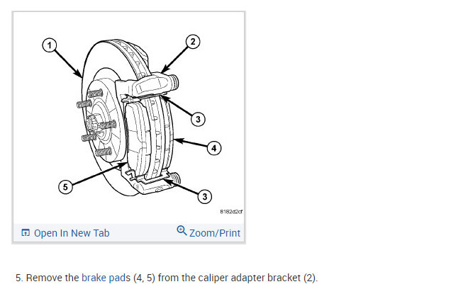

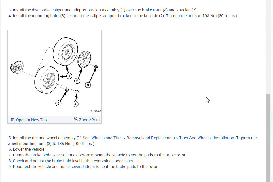

I just replaced my battery three months ago. this morning when I went to turn it on and the brake warning light was on?
Jan 14, 2017 at 4:11 AM
Experienced Mechanic
18,907 POSTS

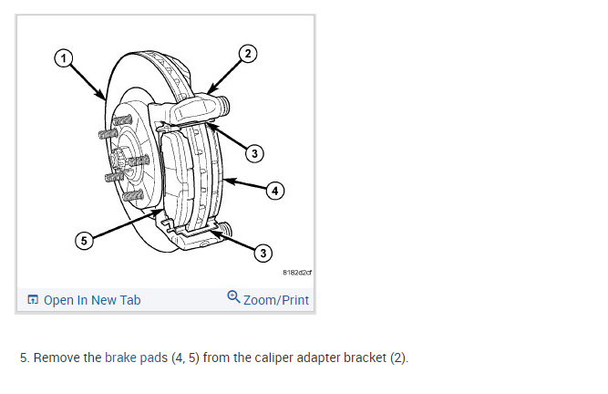

The brake light remaining on means the brake fluid is low and that is normally due to a leak or the pads are worn and need replaced.
Here is a guide that will help with replacing the pads as that is the most common issue:
https://www.2carpros.com/articles/how-to-replace-rear-brake-pads-and-rotors

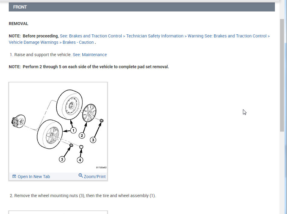

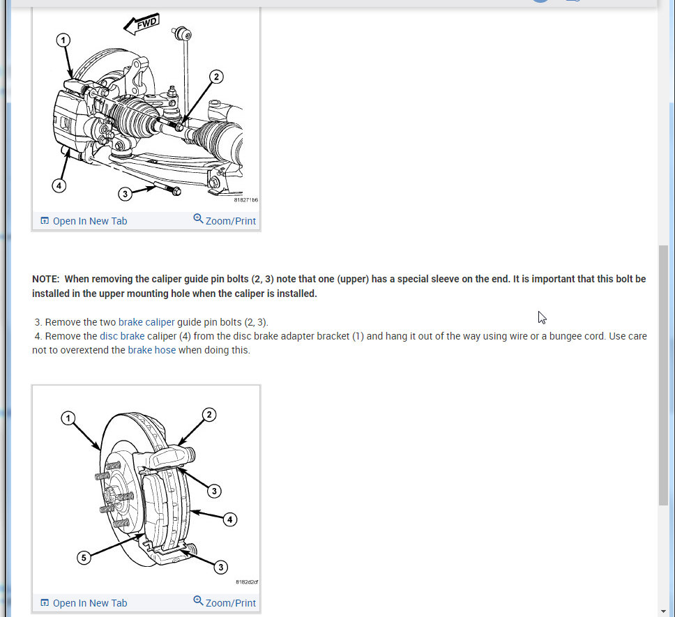

Lastly below is the process from the manual that will help with replacing the pads on this vehicle. Let us know if you have other questions. Thanks

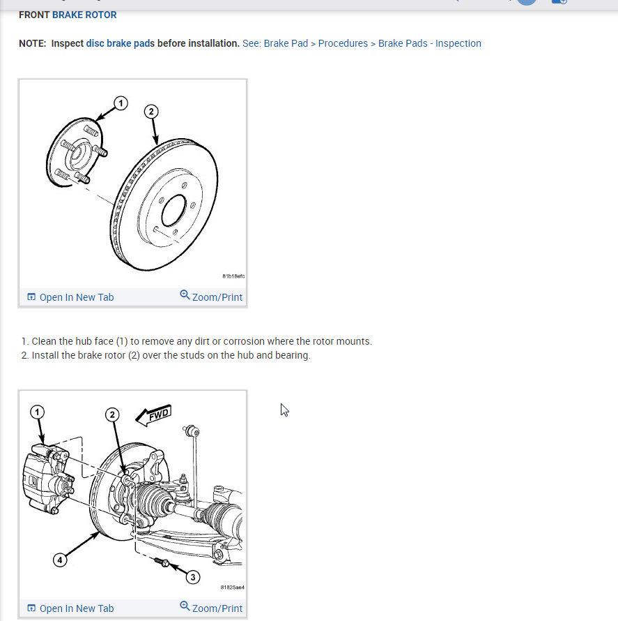

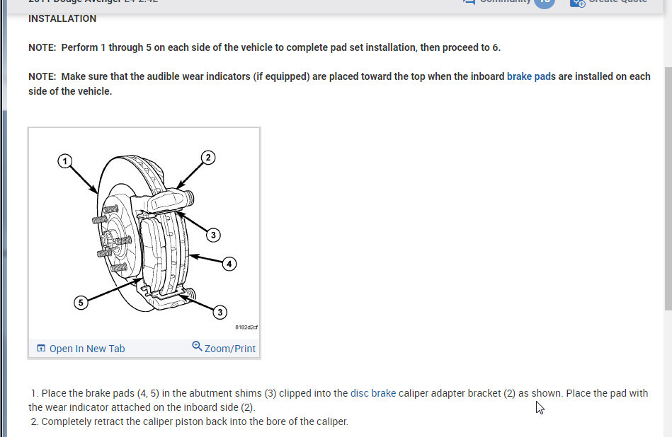

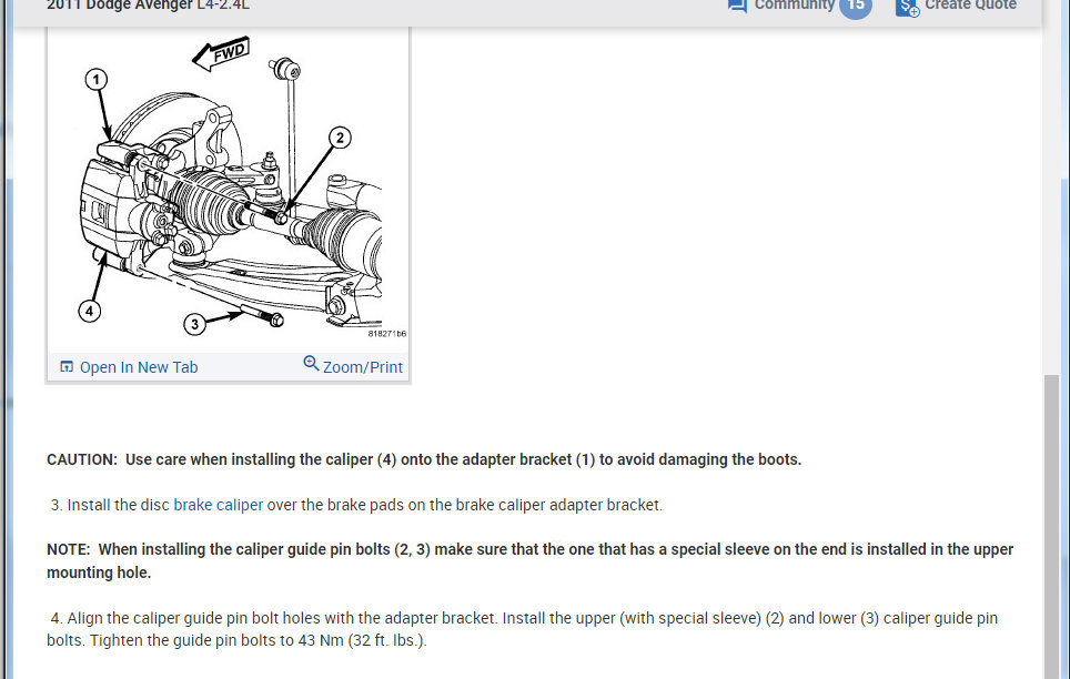

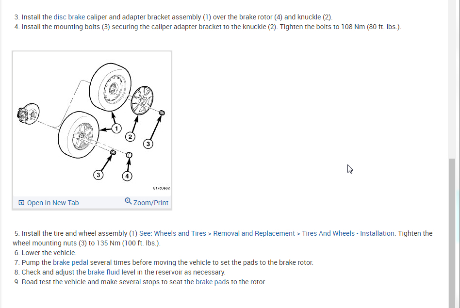

Additionally, here are the installation instructions for the pads and rotors including torque specs.
Let us know if more info is needed.
