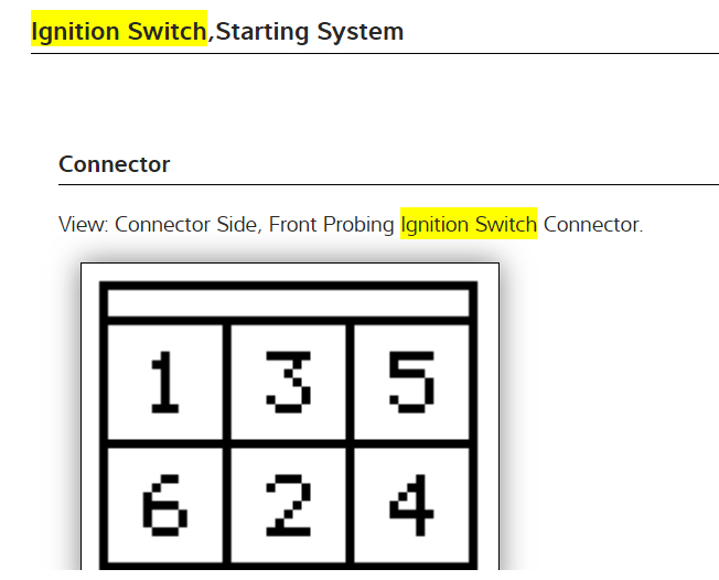

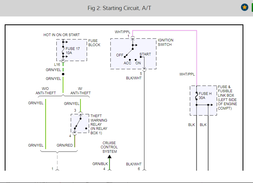

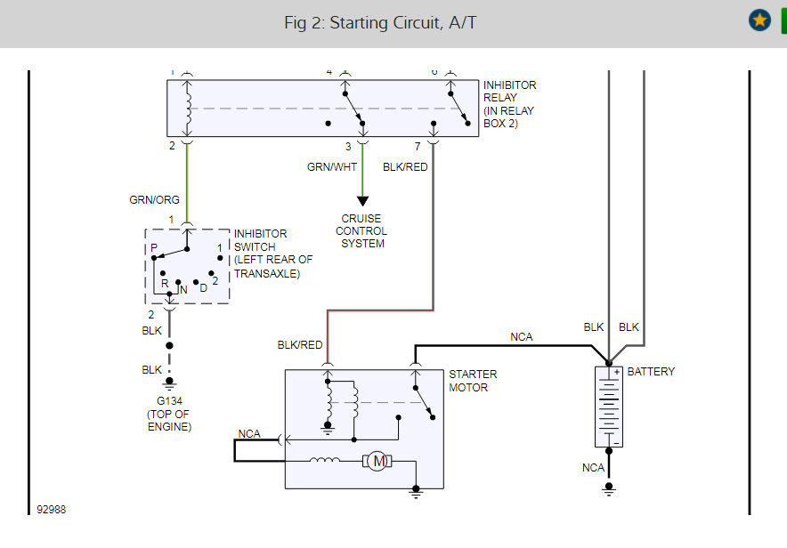

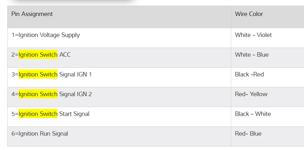

How do you have your new ignition switch wired? In the diagrams down below I have included a wiring diagram for your vehicle's original starting circuit. Please get back to us with what you find out.
