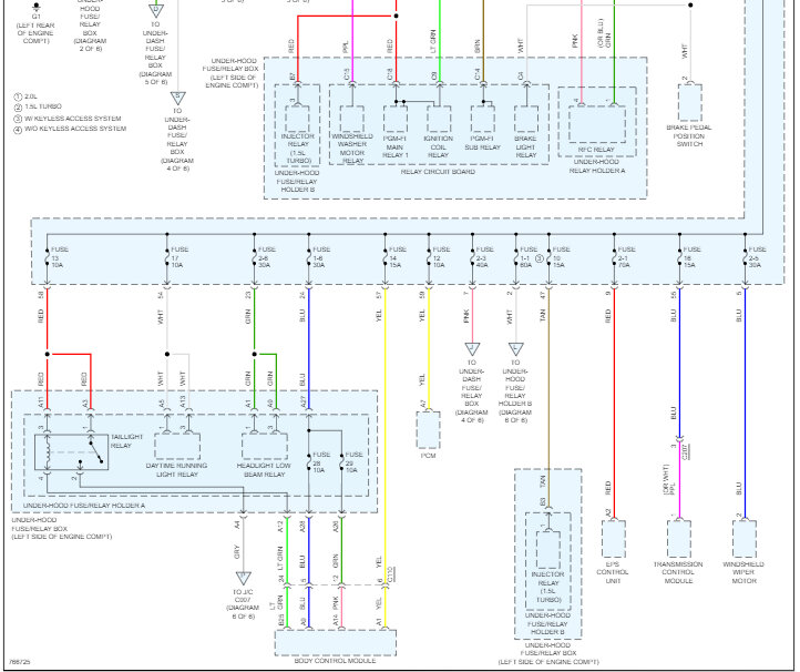

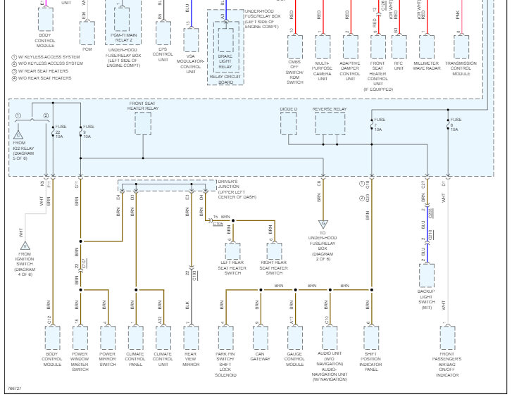

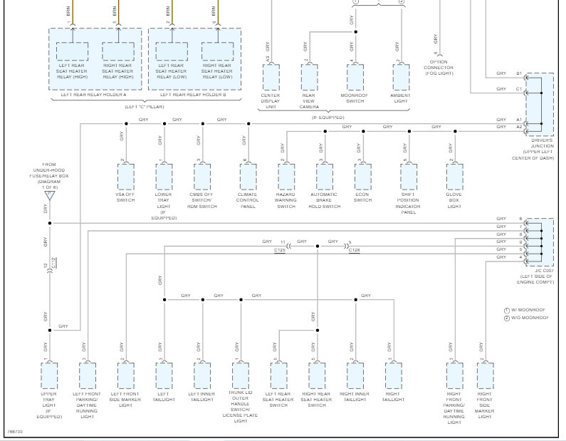

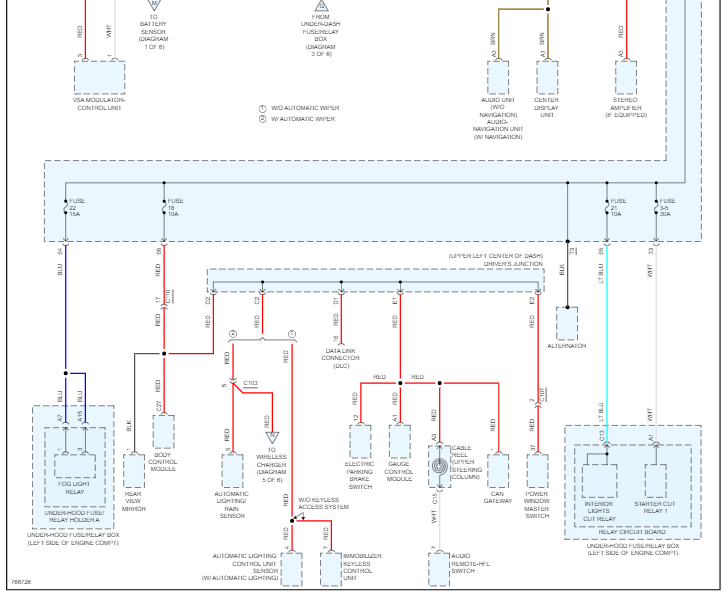

Kindly asking for a wiring diagram for the car listed above engine (P10A) eleventh generation 2021.
Mar 23, 2023 at 7:29 AM
  • 110,241 POSTS

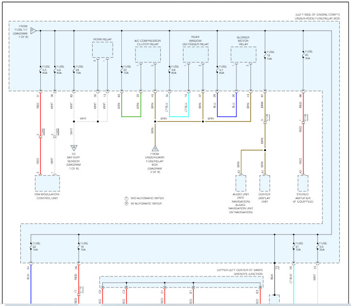

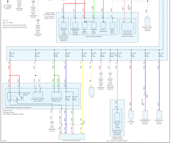

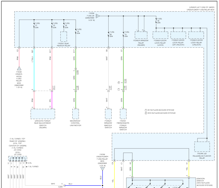

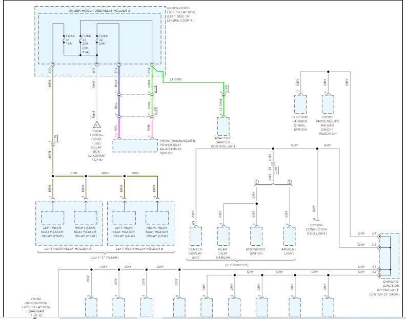

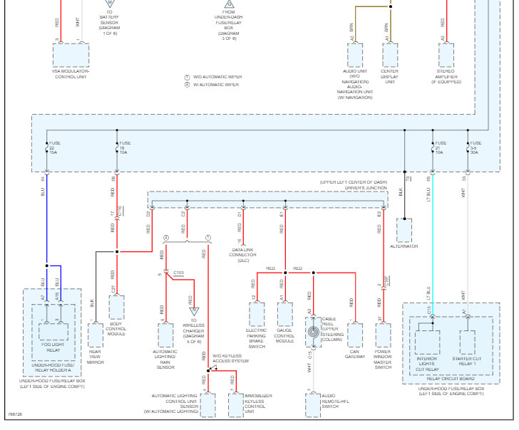

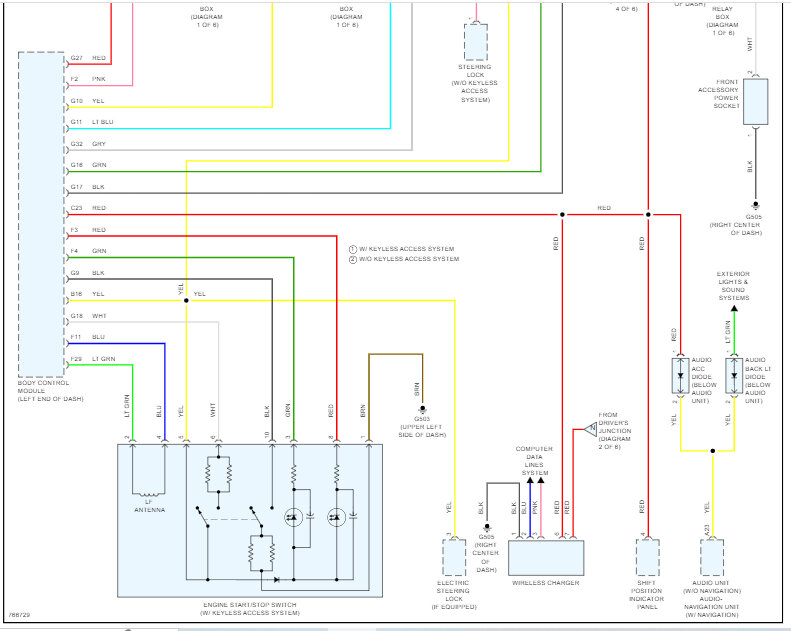

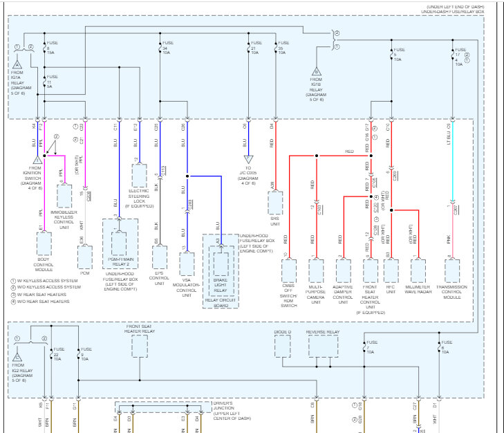

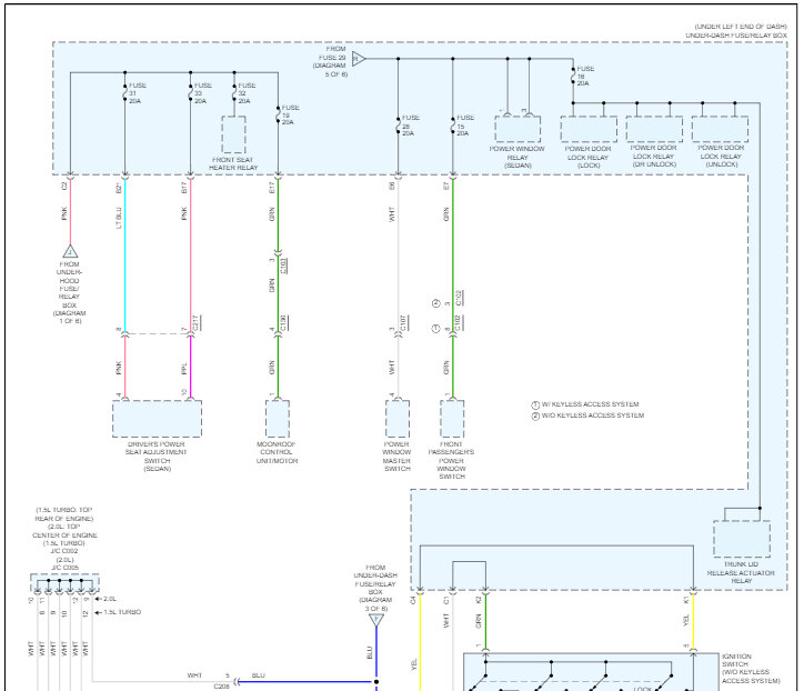

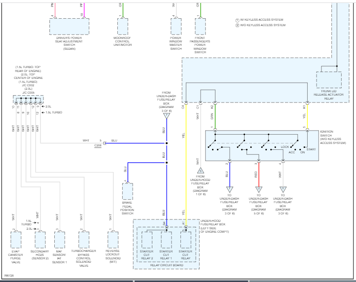

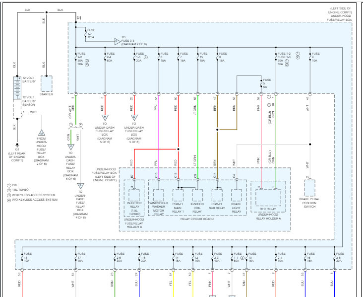

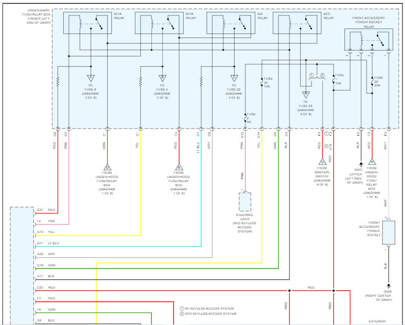

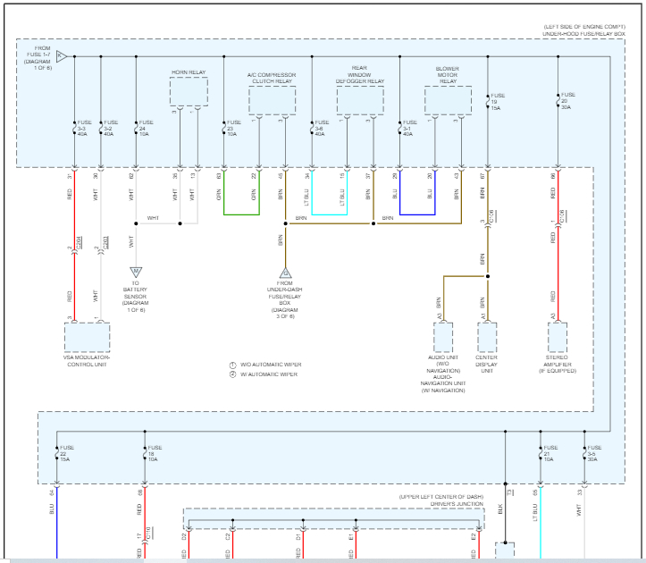

I'm not sure why this isn't being repaired under warranty. It is still under full warranty. However, I will be happy to provide what I have.
I attached the power distribution schematics below. However, I have to say that the only engine I am showing is the L4-2.0L (K20C2).
I checked through the different model civics, but that is the only one listed.

At first, I wasn't given the full information but after asking the guy who sold it, he said that they changed the engine.
That's the root of the problem after checking the car I found out that even the rev counter and the speedometer aren't working
I couldn't see the engine number of the engine they fitted I will let you know when I see it, if at all its compatible.

Let me know what you find as far as engine size is concerned. Also, did he explain why the engine was replaced on such a new vehicle?
