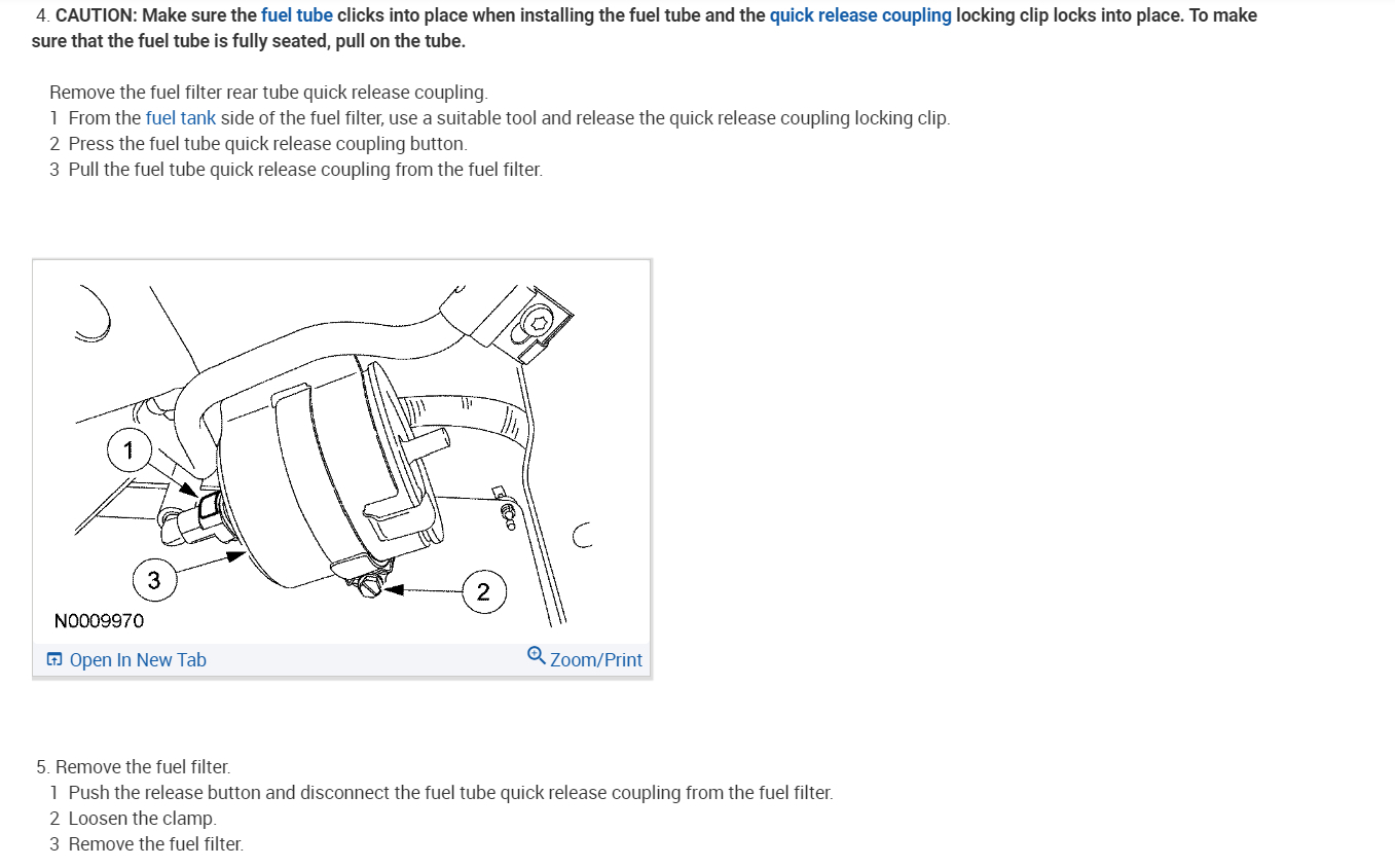

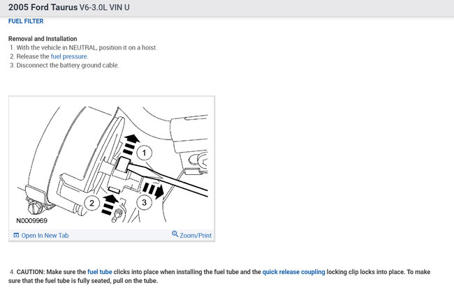

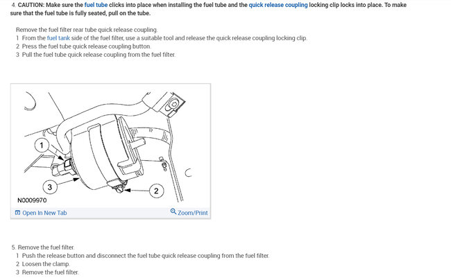

It doesn't have any power when accelerating until it gets to 40 mph. And hard to get going after a stop.
May 5, 2023 at 10:27 PM
  • 55,224 POSTS

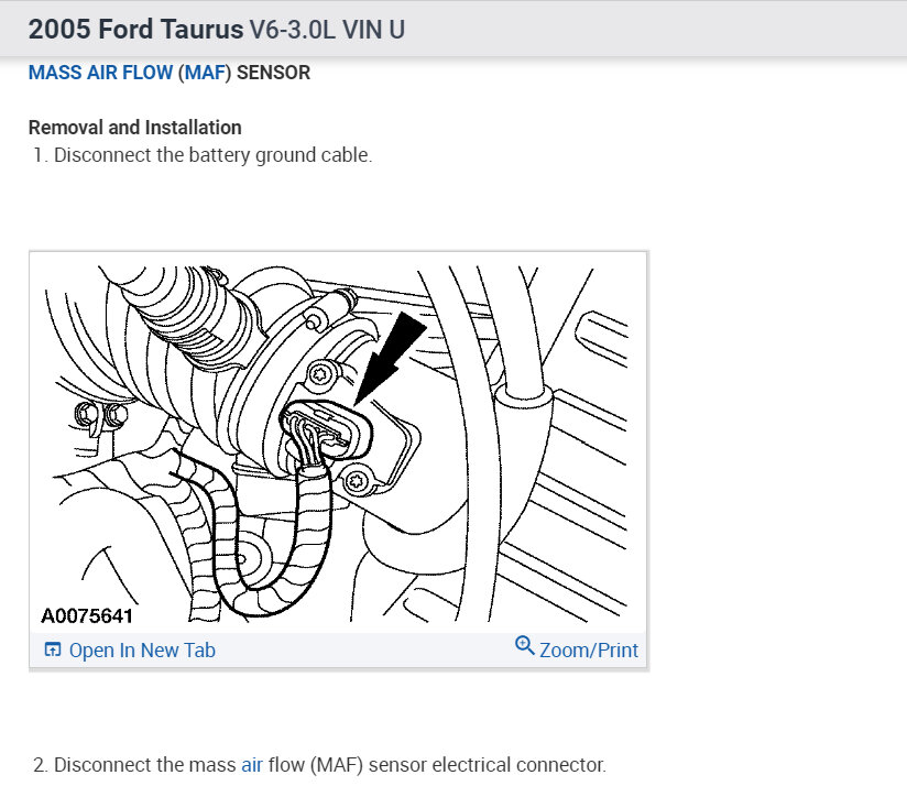

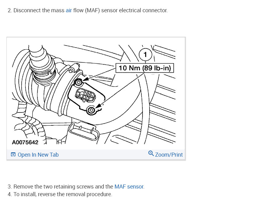

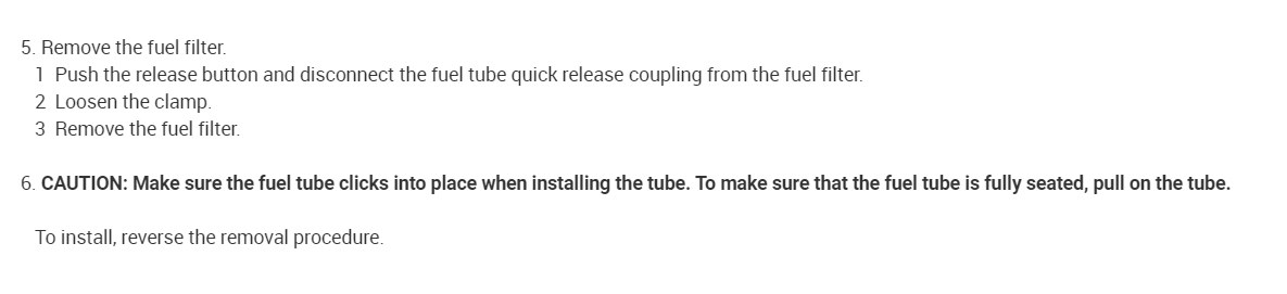

Low power can be weak fuel pressure (clogged fuel filter), a clogged catalytic converter, or a bad MAP sensor. Let's run the codes to see what comes up which can point us in the right direction.
Also, this guide can help as well:
https://www.2carpros.com/articles/engine-has-low-power-output
Here is the location of the fuel filter and a video to show you how to undo the fuel lines and I have included how to change out the MAF sensor as well.
https://youtu.be/Boi0DPXVHbM
Check out the images (below). Please let us know what you find.
