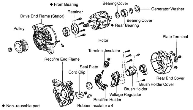

When I put the key in the ignition I loose all power and have to be jump started. I just bought a battery three months ago. so is it the alternator or starter?

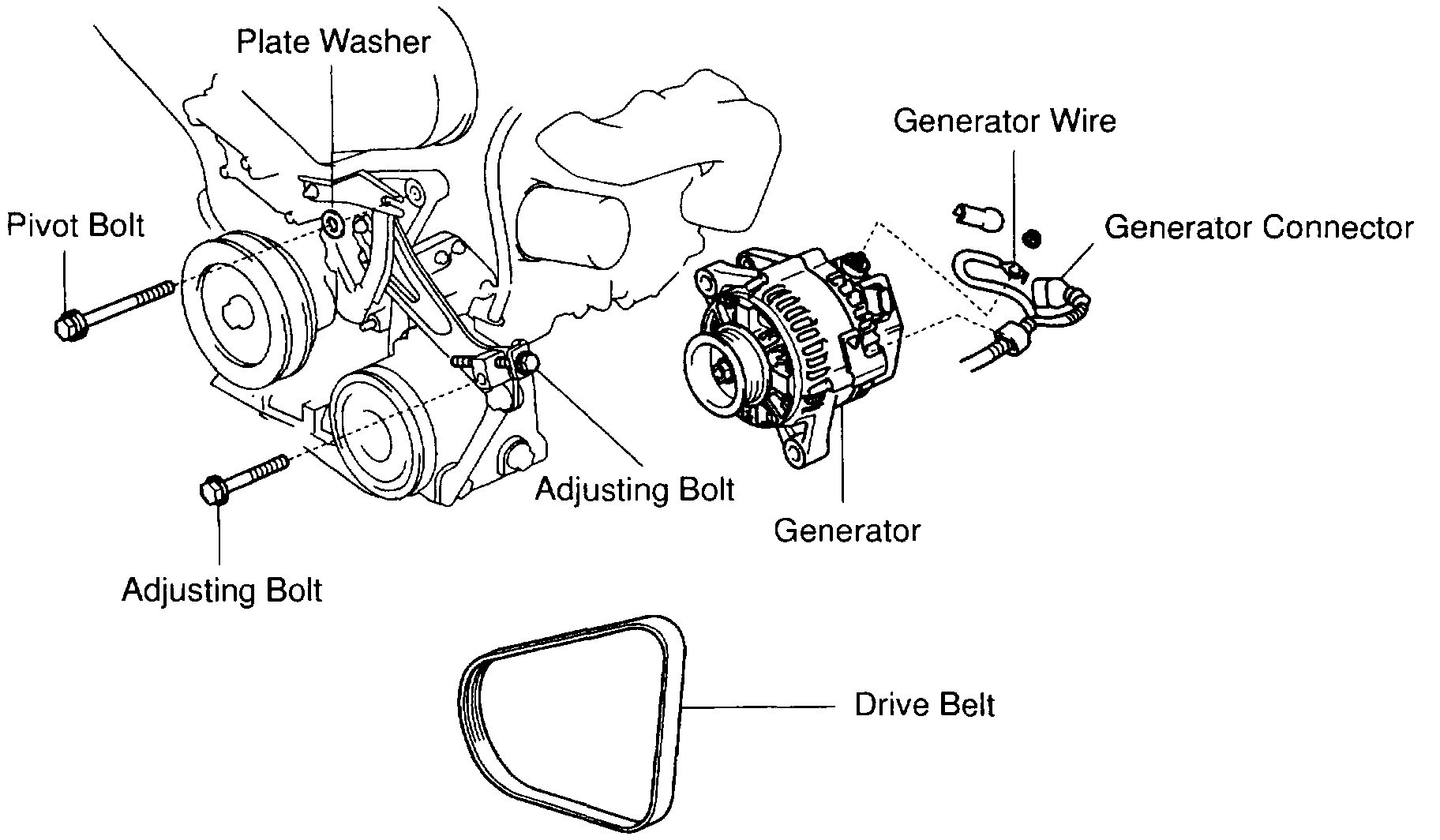

Here are directions specific to your vehicle. Make sure the belt is tight before you replace it. A loose belt can cause the alternator to fail. The attached pictures correlate with the directions.

pic 1
pic 2

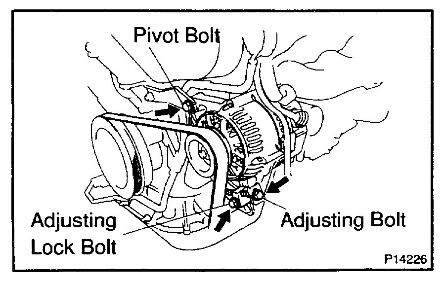

pic 3
1. REMOVE DRIVE BELT
Loosen the pivot bolt, adjusting lock bolt, and adjusting bolt, and remove the drive belt.
Torque:
Pivot bolt: 56 Nm (570 kgf.cm, 41 ft.lbf)
Lock bolt: 18 Nm (180 kgf.cm, 13 ft.lbf)

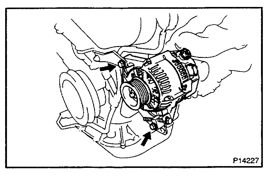

pic 4
2. REMOVE GENERATOR
a. Disconnect the generator connector.
b. Remove the nut, and disconnect the generator wire.
c. Disconnect the wire harness from the clip.
d. Remove the pivot bolt, plate washer, adjusting lock bolt and generator.
INSTALLATION
Installation is the reverse order of removal.
