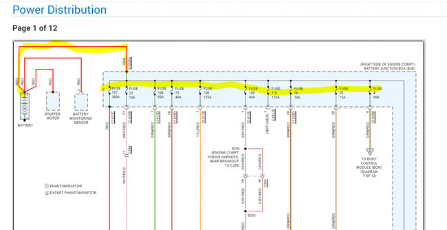

Yesterday I parked my truck and did some shopping. When I came out, I remotely started it, but when I went to put the key in it and crank it to drive, it shut off. Literally everything shuts down: the gear shift doesn't move, there are no headlights or dash lights, the horn doesn't work, no A/C or radio, there is no clicking sound when I tried to crank it, but the battery has plenty of charge. I tried jumping it anyway-no luck. Had to get it towed. Any ideas?

Have you checked the battery terminals to make sure they are tight and clean? If you lost power to everything, this is where we need to start. Take a look through this link:
If the battery terminals are clean and tight, open the fuse box under the hood and check any of the fuses I highlighted for power. I need to know if any have power. Here is a link you may find helpful. See pic 1 below
Let me know what you find. I'll watch for your reply.

Mike, you are very welcome. If you lost total power, there is an open somewhere between the battery and the power distribution box. Otherwise, you wouldn't have lost everything. That doesn't necessarily mean power was lost, but the ground may have also failed.
If you can, I would be really interested in knowing what happened. This has my attention. LOL
