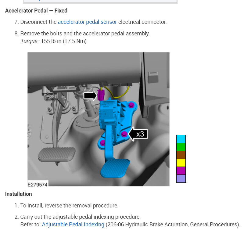

Car run great , idle find, but when shift to reverse or drive no throttle pedal response.
Aug 25, 2023 at 11:44 AM
  • 55,433 POSTS

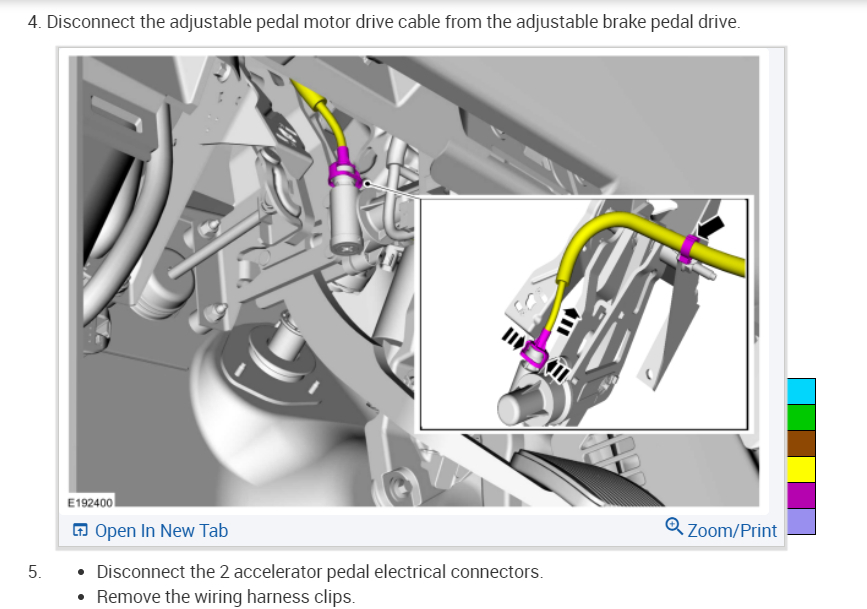

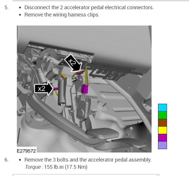

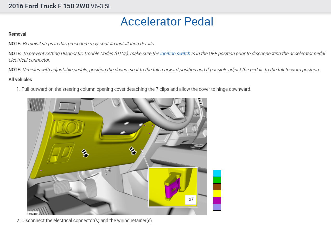

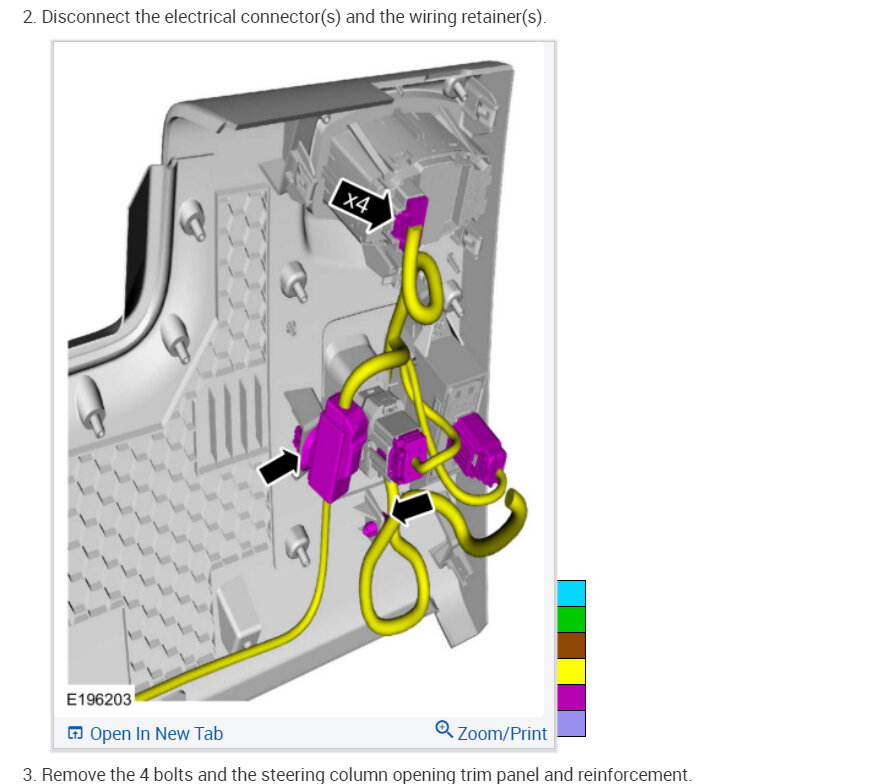

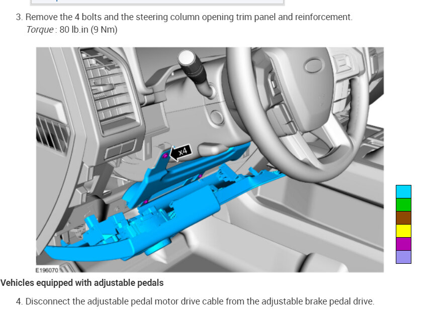

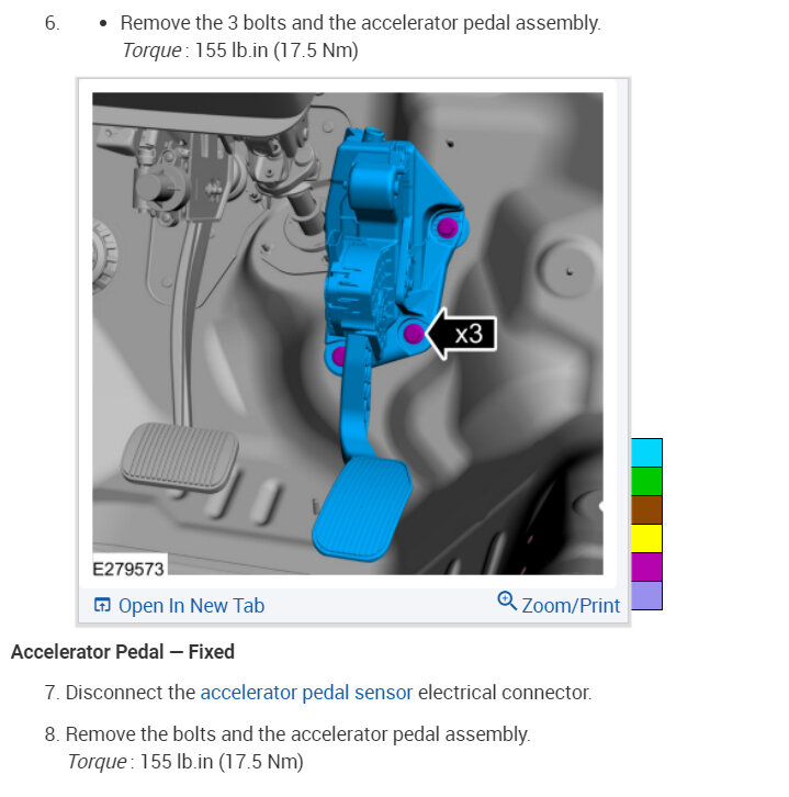

It sounds like the throttle bore has gone bad or the accelerator pedal position sensor is not working, to be sure let's do a scan to see what codes are stored.
Here is how to change out the accelerator pedal position sensor in case a code comes up for it:
