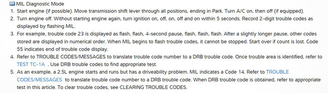

Have no overdrive. Switch has power on and off. No codes just first, second before third Ed. No overdrive power to speedometer. Is it a solenoid?

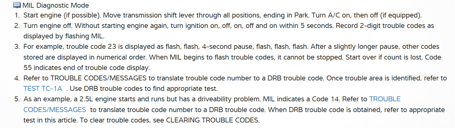

Scan for codes this may be a few things like a clutch burnt out. Could be a solenoid, but scanning will or should tell. Follow instructions in picture to get codes then get back to us. Make sure fluid level is full.
