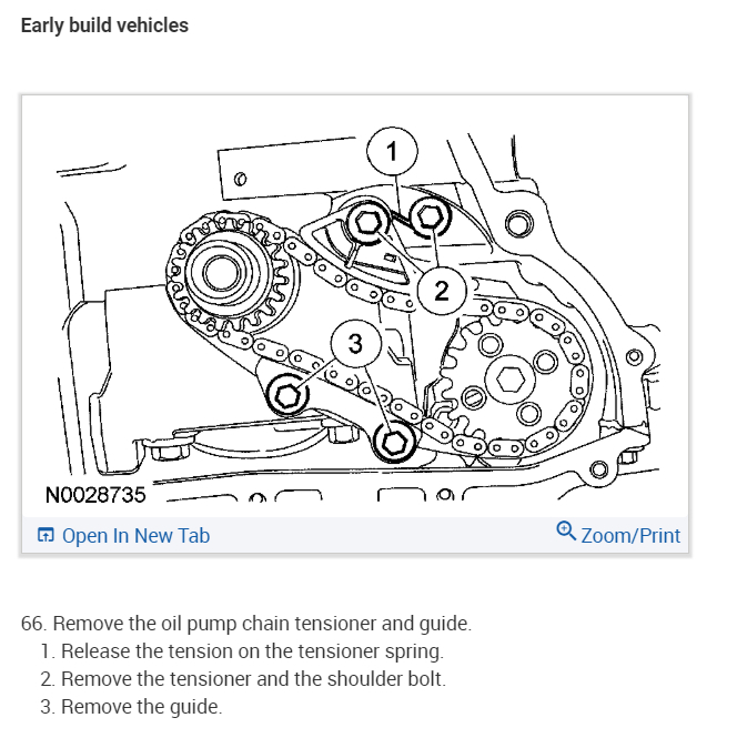

I just overhaul the engine. Crank pulley broke as it had cracks. Replaced it and started the engine there is no oil coming up to cylinder head. It was okay before replacing the crank pulley. No oil pressure.

There is a chain that runs the oil pump it must have broke or stripped out. Here is a diagrams to show you so you can check it out. Check out the diagrams (below). Let us know what happens and please upload pictures or videos of the problem.
