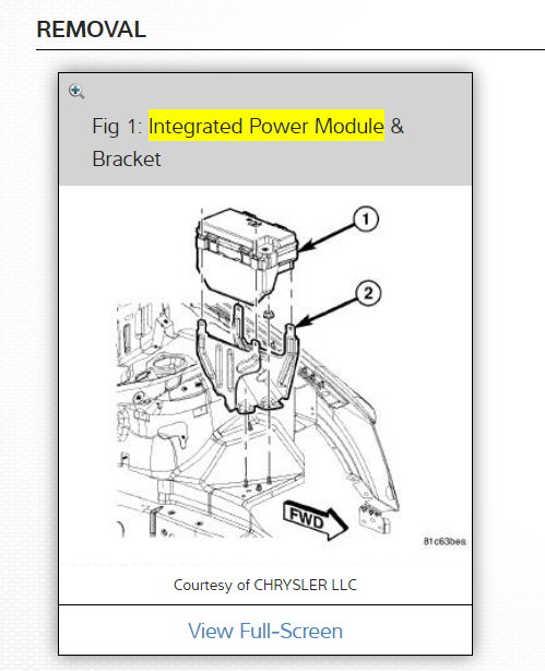

Here is how you change the TIPM, it is easy because it self initializes. Check out the diagrams (below). Please let us know what you find. We are interested to see what it is.
