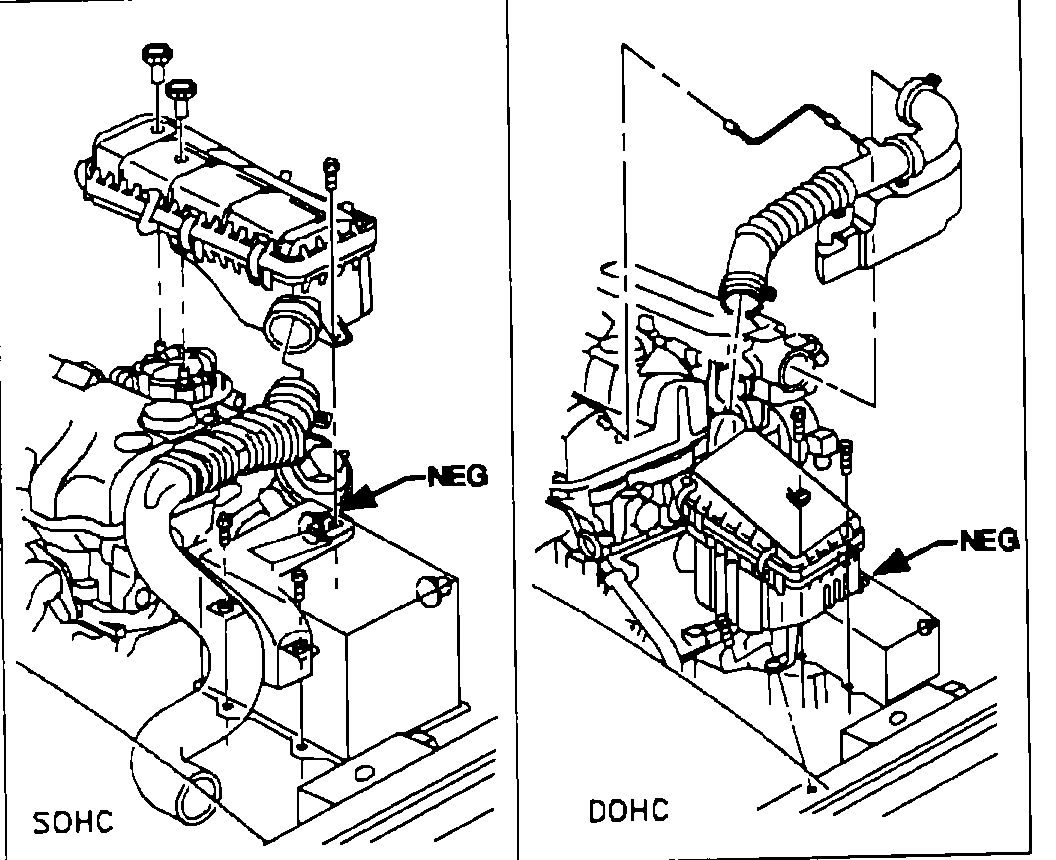

Air Induction Tubes
pic 1
Air Induction Removal

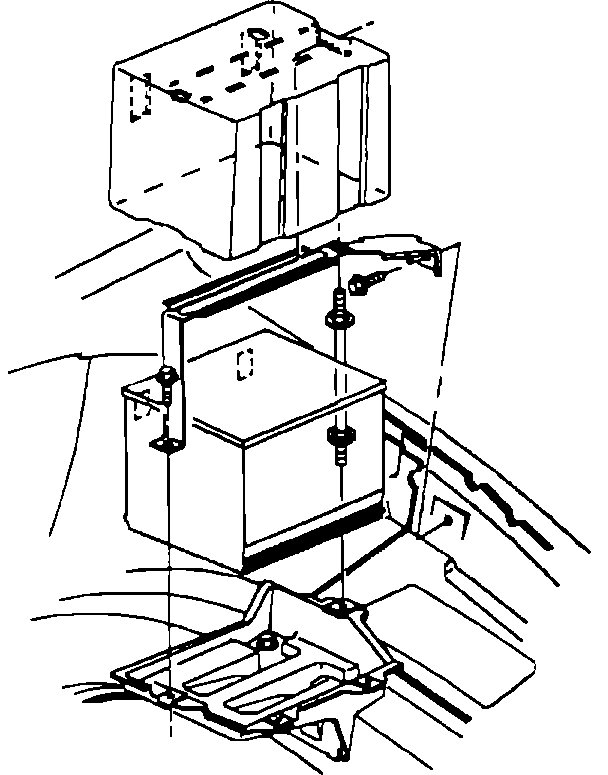

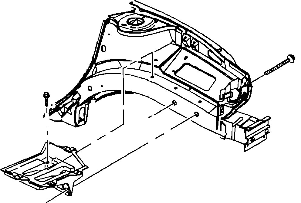

Battery Compartment
pic 2
Battery Removal
Battery Tray Removal
pic 3

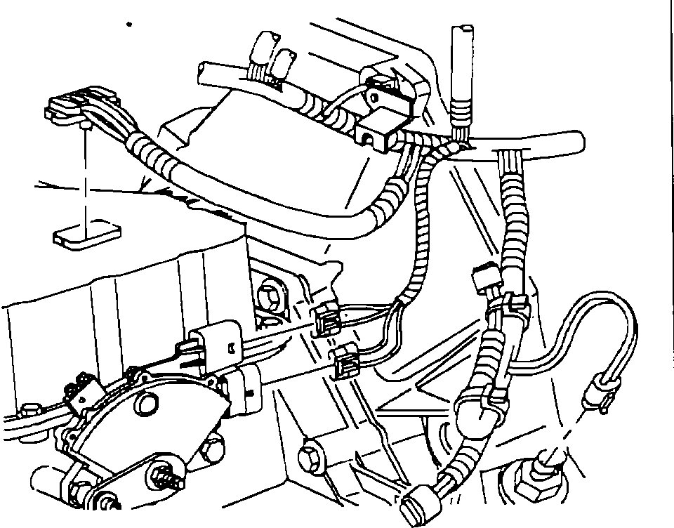

Transaxle Connectors
pic 4
Transaxle Connector

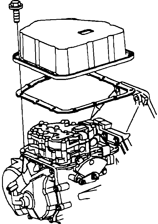

Valve body Cover
pic 5
Valve Body Cover

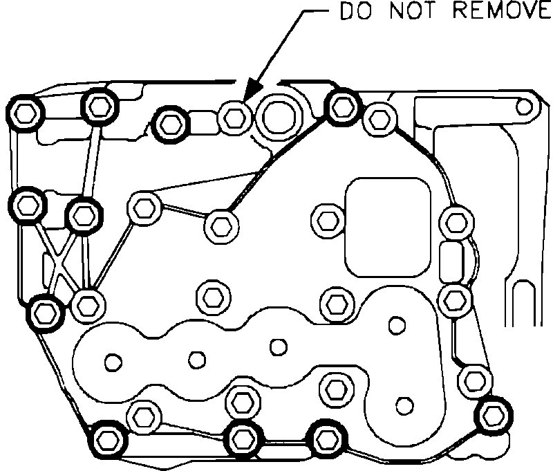

Valve Body Bolts
pic 6
Valve Body Bolts - Do Not Remove

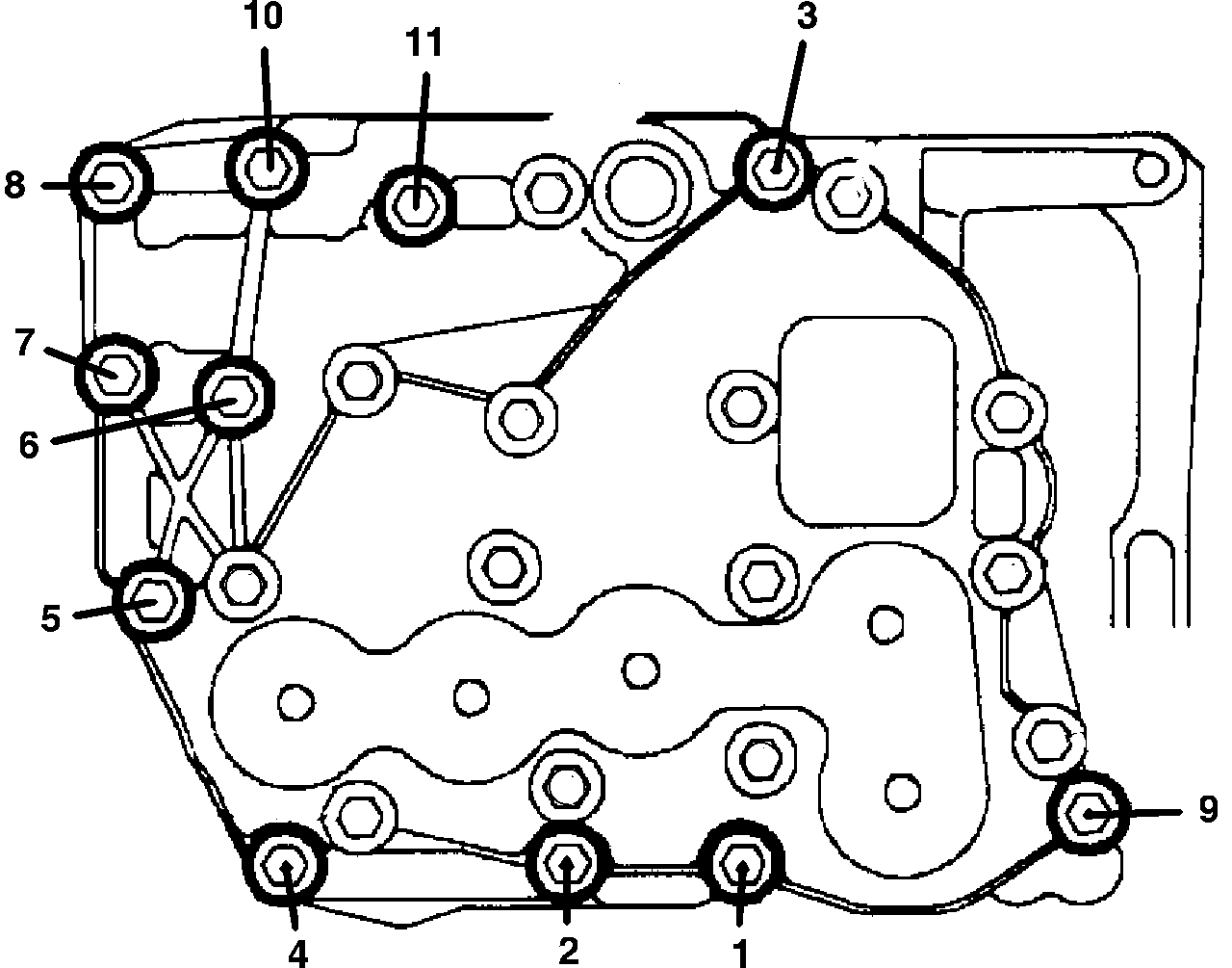

VALVE BODY INSTALLATION
Tightening Sequence
pic 7
Tightening Sequence
Air Induction Tubes
pic 8
Air Induction Installation
Battery Compartment
pic 9
Battery Installation
pic 10
Battery Tray Installation
pic 11
Transaxle Connector
Valve body Cover
pic 12
Valve Body Cover

3. Install and finger tighten valve body-to-case bolts first. This procedure must be followed to assure valve body is properly aligned to the case.
NOTICE: Clean and lubricate fasteners with ATF fluid. Wipe off excess fluid and install.
4. Torque valve body-to-case bolts using torque sequence shown in the illustration.
Torque: 11 Nm (97 in lbs)

5. Clean valve body cover gasket surface with carburetor cleaner or equivalent, applied with a shop towel.
6. Set valve body cover gasket in place and instal valve body cover.
7. Torque valve body cover bolts using torque sequence.
Torque: 10 Nm (88 in lbs)

9. Connect transaxle connector.
10. Torque transaxle connector bolt.
Torque: 3 Nm (27 in lbs).
NOTICE: Do not over-tighten or damage to the connector plate may occur.
11. Install battery tray.
12. Torque battery tray bolts.
Torque: 10 Nm (89 in lbs).
IMPORTANT: Two bolts are located in the fender well.

16. Install air induction box.

Does it make a difference regarding the drive link if I'm replacing the whole valve body?
Is there a picture showing the orientation or should I just note how it came apart/off ? And thanks for not bothering with pictures of reinstall of battery and air cleaner parts. I see 7 pictures correct ? N last for now , am I looking at the top of the transmission or from underneath ? If I can do it from on top, should b a piece of cake. One more when you say don't remove bolts on the v b because I'll be switching them out or do you mean keep the same location when switching ? Sorry I'm a little nervous but willing.
Feb 18, 2020 at 4:00 AM
  • 110,244 POSTS
I have no idea why I missed these pictures. Sorry about that. As far as access, it's from the top. That's why the battery box has to come out. And the bolt not to remove, If I recall those hold the valve body together and don't mount it to the housing. It has been awhile since I had one of these apart. If you run into trouble, let me know and I'll try my best to help from here. If you do run into trouble, if possible, upload pictures of where you are having trouble. It will help me.

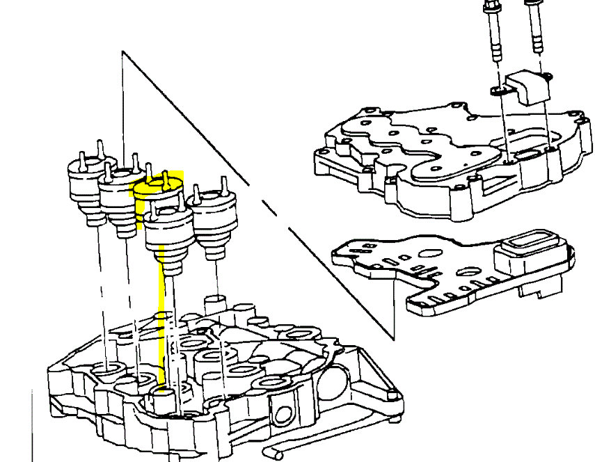

I found the slip when I had the lite dx. Code 25 TCC solenoid. Verify please and give me your opinion. I've put some 45,000 on the transmission since first lite. It works fine except for the over drive in-op. Fluid looks smells normal. Any reasonable place to get gaskets there spendy.
Feb 19, 2020 at 8:16 AM
  • 110,244 POSTS

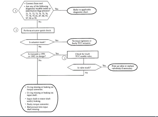

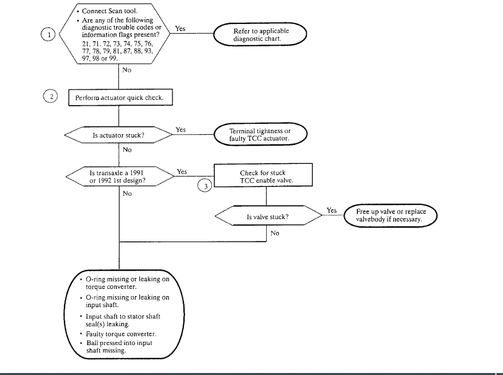

This code is specific to the TCC. Since it is the only code, I suspect either the actuator is bad or there is a bad o-ring at some point allowing pressure by bypass. The best advice I can give you is to check the TCC unit. I hope you understand that there are a few different things that can cause the code. I don't want you to replace parts just to find it didn't fix the problem. Testing does require special scanner. The solenoid in located in the transmission valve body. If you look at pic 1, I attached a flow chart for testing. Pic 2 shows the TCC solenoid.

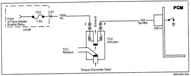

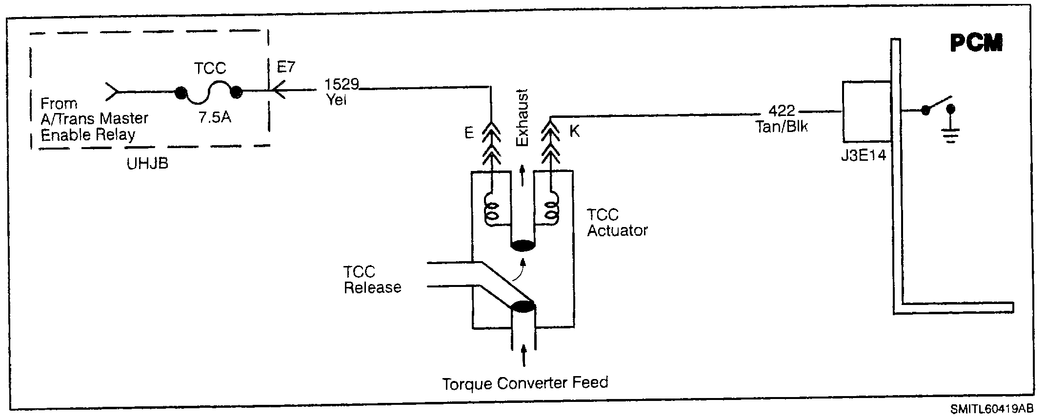

Pic 3 is a schematic of the system related to the TCC. Here is info related to the code:

When TCC is commanded On, the comparison of engine speed to turbine speed is monitored to assure TCC is On. When TCC is On the engine speed and turbine speed are equal. TCC is applied by grounding circuit 422.

TEST DESCRIPTION
Numbered steps below refer to numbered steps on chart.
1. Check for diagnostic trouble codes/information flags 21, 71, 72, 73, 74, 75, 76, 77, 78, 79, 81, 87, 88, 93, 97, 98, or 99. They must be eliminated first as a possible cause of DTC 25.
2. Check actuator operation. Use actuator quick check. The actuator quick test will Pulse Width Modulate (PWM) the actuators at a set rate. Listen and compare the noise of TCC gear actuator to that of other actuators. The noise of all should be similar.
3. Other possibilities for DTC 25 to set:
^ Internal leakage in the TCC apply circuit.
^ Possible low line pressure.
^ Converter charge valve stuck causing TCC apply pressure to be exhausted to lube.
^ Converter limiting valve stuck open.
^ Missing or damaged torque converter-input shaft O-ring.

^ When the PCM detects a fault in the circuit (open, ground, short), the PCM will open the circuit internally to protect the circuit.
^ This DTC may be caused by a poor electrical connection at either the PCM, actuator connector plate or Underhood Junction Block (UHJB) terminals. Wiggling connectors while performing an actuator quick test may help isolate the problem area.
