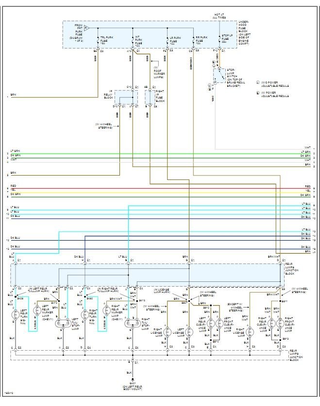

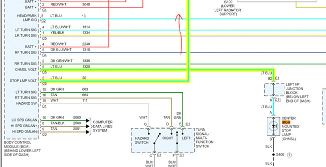

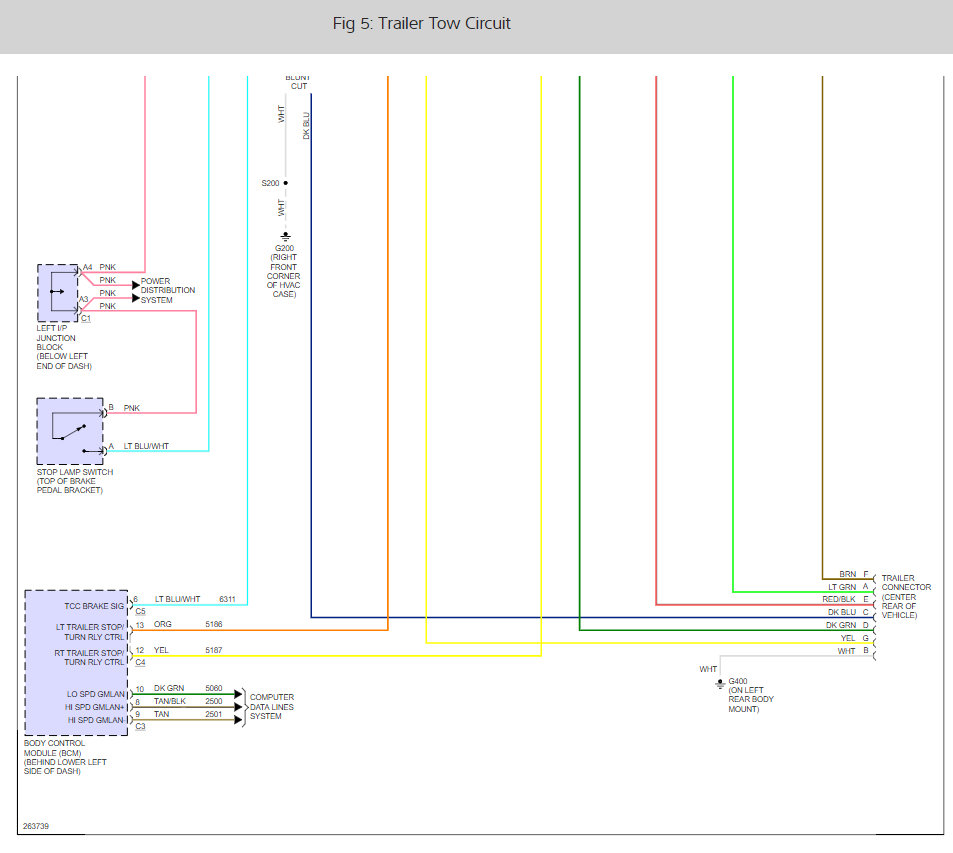

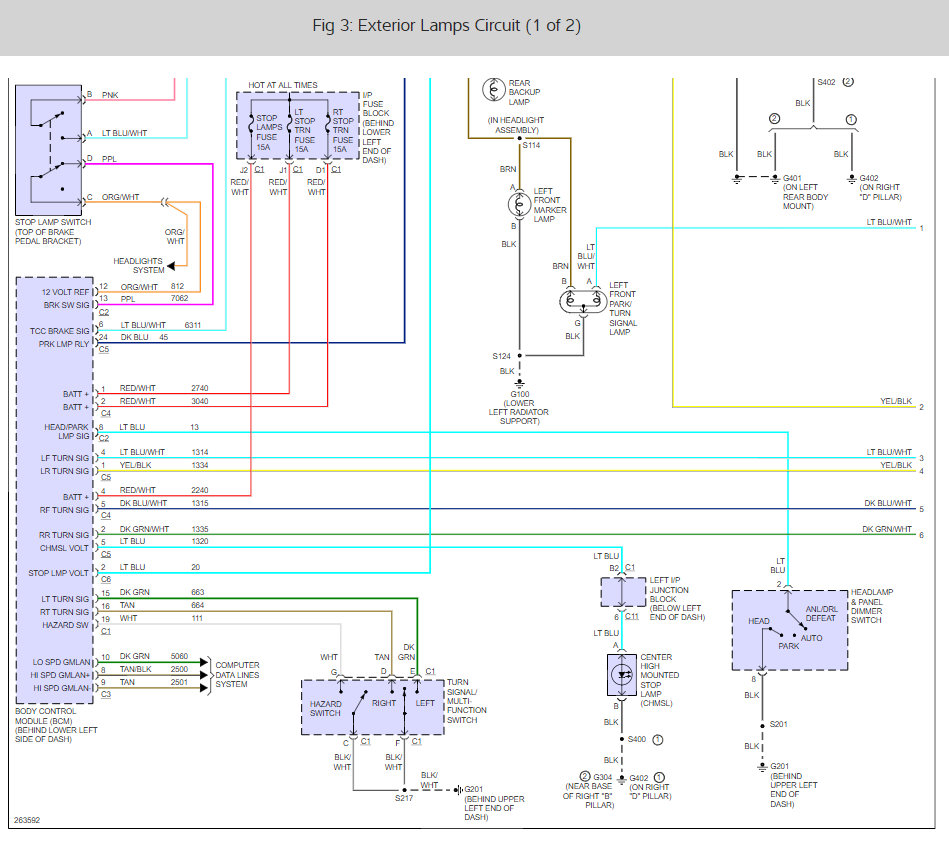

I have replaced the bulbs, relay switch, brake switch and check fuses on side of the dash and the ones under the hood. The top third brake light works but not the ones in the lower housings.
Jul 26, 2020 at 7:07 AM
  • 110,248 POSTS
Power to the high-mount brake light comes from a different source. Since it is working, that tells me the switch is good.
Now, if you look at pic 1, I highlighted two different wires from the body control module. Note the arrow I have pointing up. That goes to the lights that aren't working. The other one powers the high-mount light.

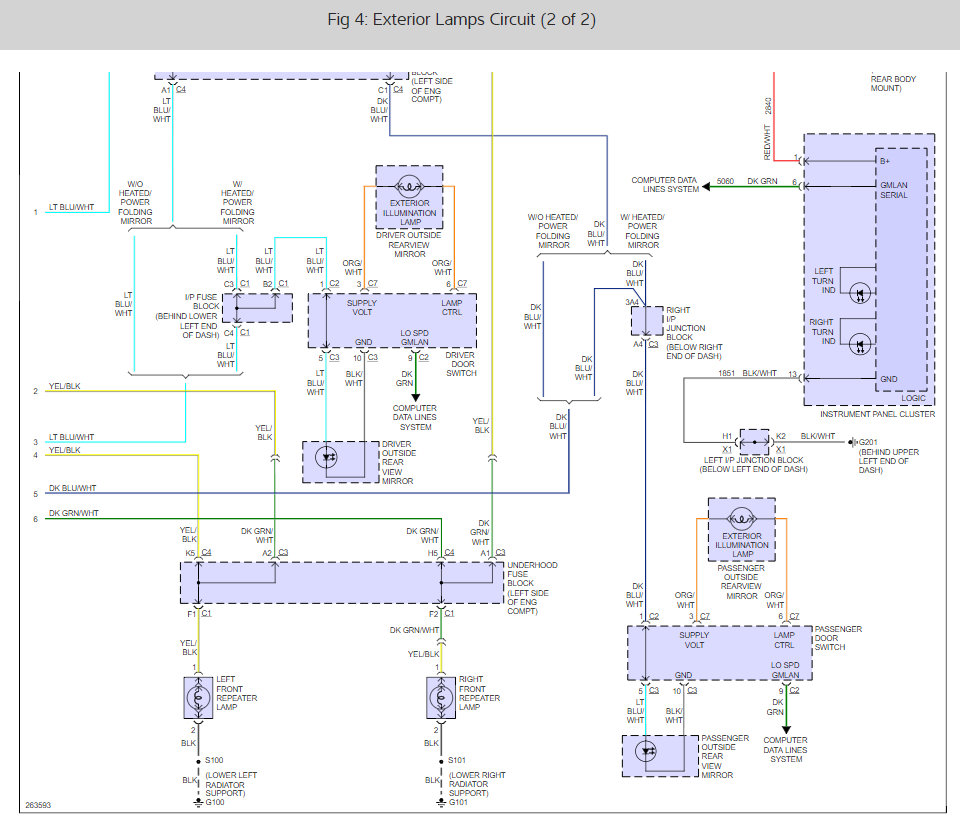

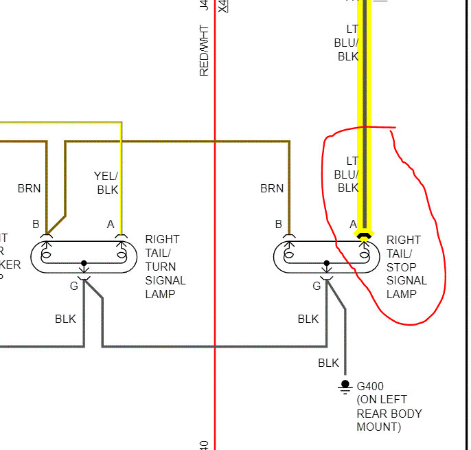

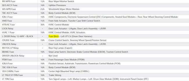

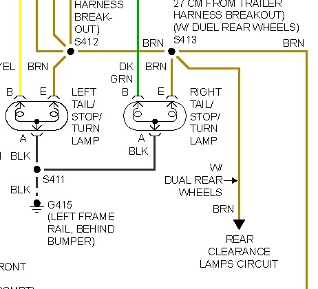

Here is where we need to start. I attached two other pics. Pic two shows the left side brake light and pic three is the right side. Note the wire and color that I circled. Using a test light, I need you to check if there is power in those wires when the brake is pressed.
Do this and let me know the results. Also, I need to confirm that all other lights on the rear are working.
Jul 26, 2020 at 7:27 AM
JOE T-JOE WOOD JR.
Found a loose connection on one of the blue wires. Thank you.

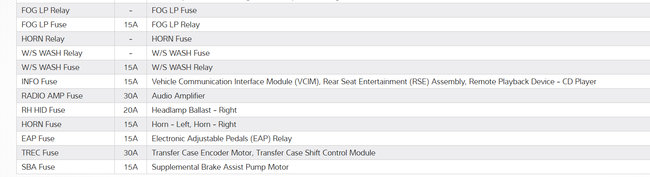

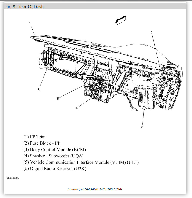

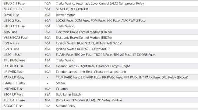

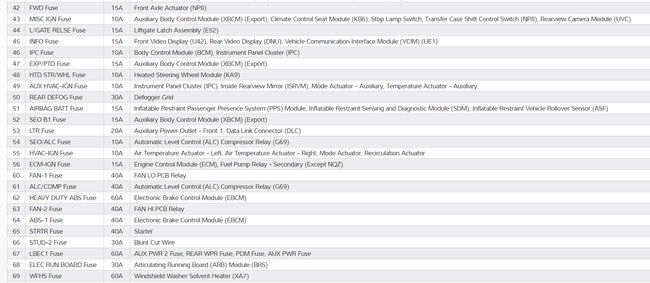

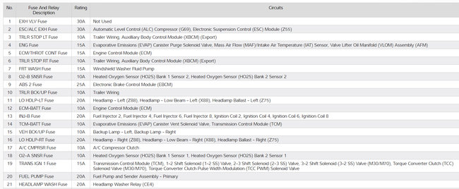

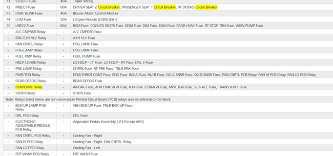

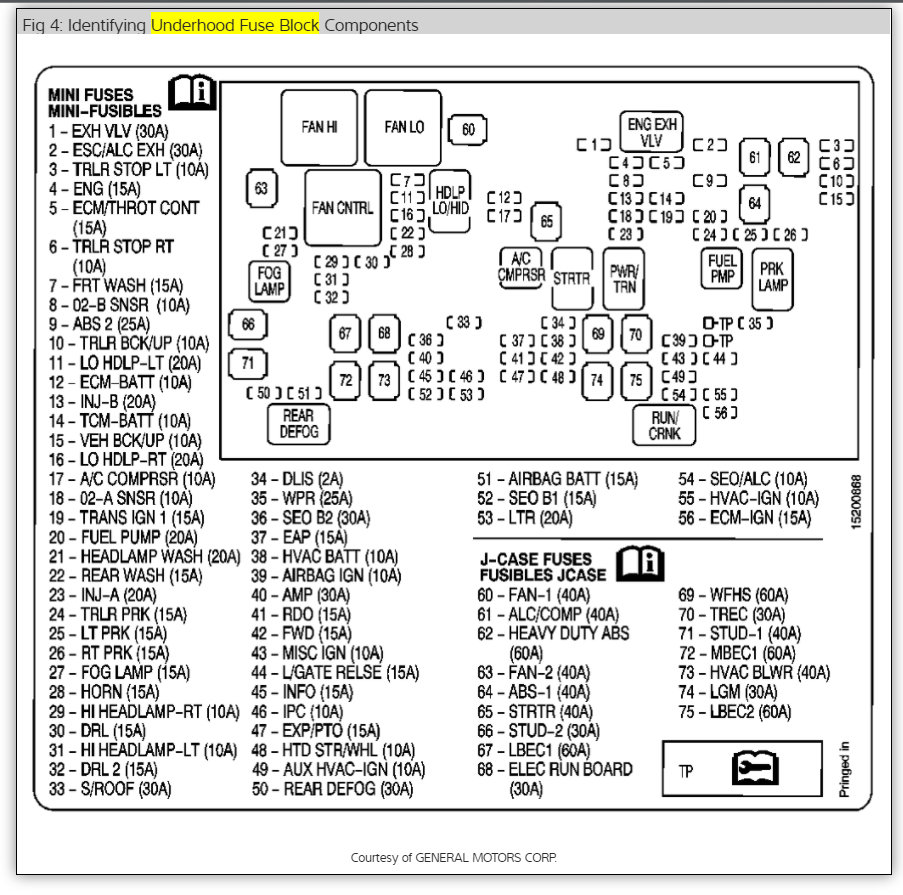

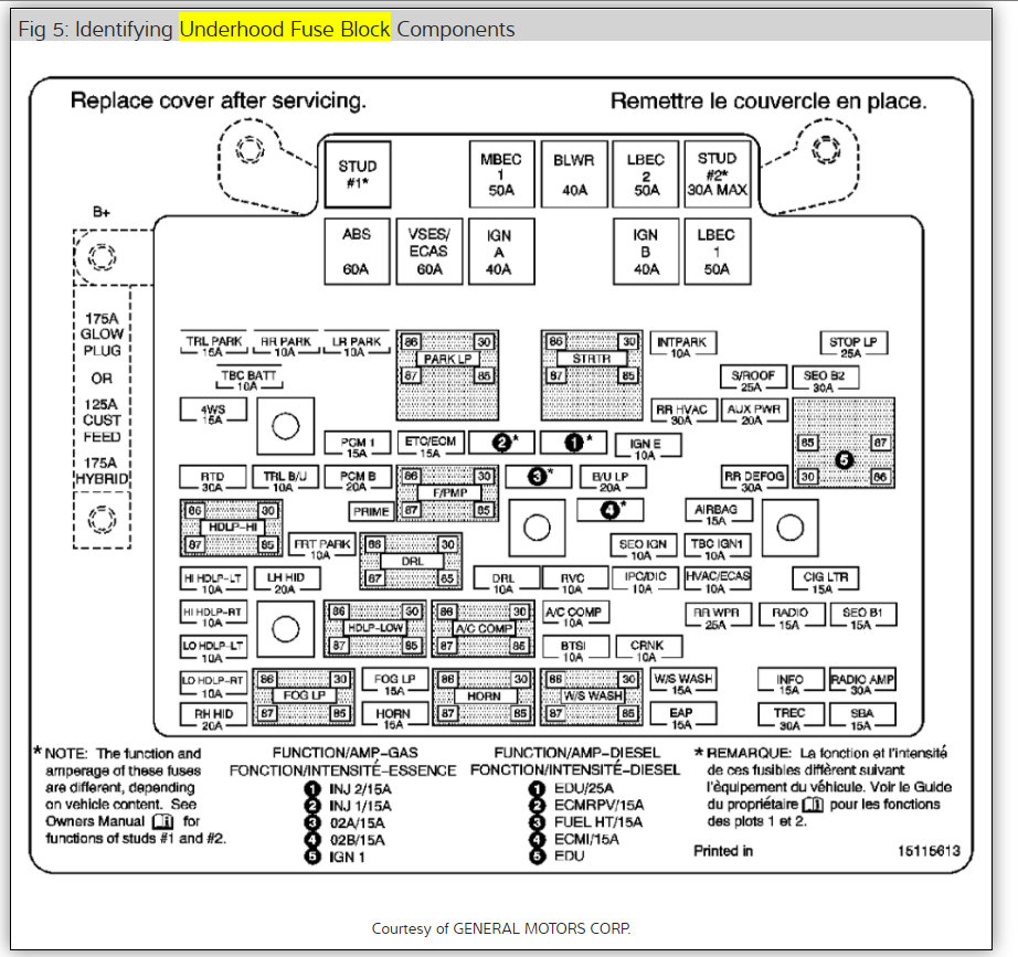

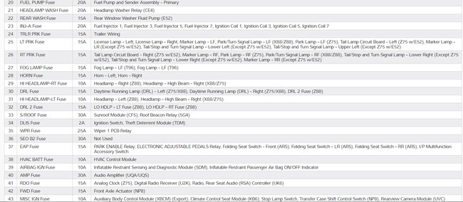

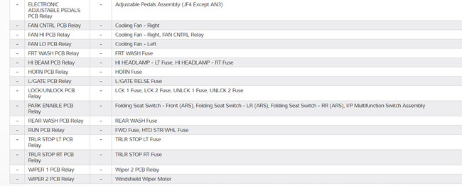

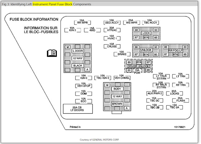

This sounds like the BCM is going out which controls both of these systems. But we should check the fuses first. Here is a guide and the fuse locations along with the BCM location. If the fuses are good I would try a used BCM and plug it in to see what happens. You may need to get it programmed at a shop which will run about $120.00.

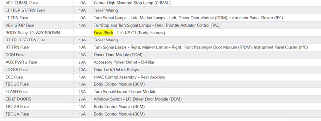

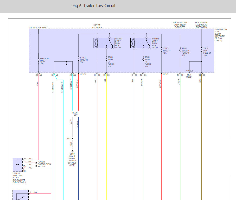

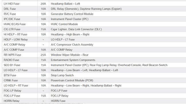

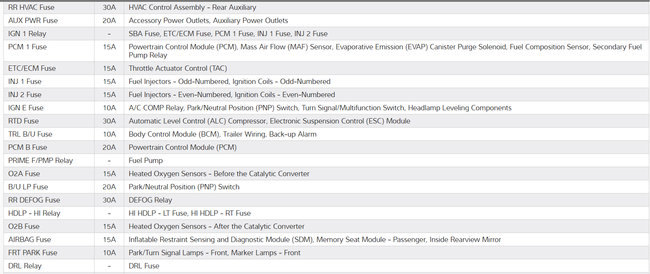

Tracing wires is fun and it keeps you out of trouble! It sounds like the MIS IGN fuse is out.
Here is a couple of guides and diagrams to help you run some simple tests:
(Check out the brake wiring and fuse panel diagrams below)
Jul 27, 2020 at 3:27 AM (Merged)

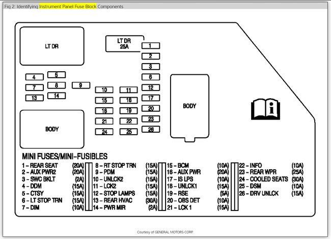

BS3
2007 Yukon, both low brake lights inoperative. Fuse and bulbs are OK. High center rear brake light works; plugs and wires all connected.
MMPRINCE4000
  • 8,548 POSTS
Check fuses. High center is independant of lower lights.
BS3
All fuses are ok. Turn signals also work. Thought about brake light switch but the high center rear brake light comes on at the liftgate.

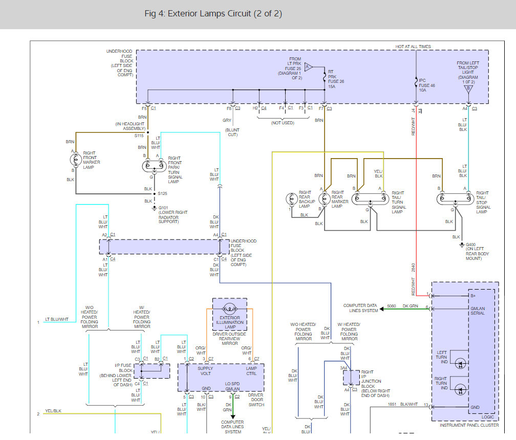

My brake lights dim when headlights are onin 2004 yukon xl. When brakes are pressed blinker flashes fast and they take the place of the brake lights when headlights are on. if brake isn't pressed blinkers work fine. Brake lights are dim when headlights are off. Checked all bulbs and fuses and in Feb. this year had rear circuit board and turn signal switch replaced for this problem but still had this happen when it rained outside. I was told may be a bad ground but I don't know where to check this at.
Jul 27, 2020 at 3:31 AM (Merged)
KHLOW2008
  • 41,812 POSTS
It should be caused by a bad grounding circuit. Check the grounding points near the taillights.
See the diagram below

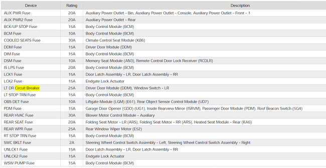

GRANTHORSE
I have replaced the left rear brake lights and they still do not work. It was suggested that perhaps it may be a circuit breaker. Where would I find that and is it something I can fix or do I need to take it to the dealership? Or, could it be something else? Any thoughts?
Jul 27, 2020 at 3:32 AM (Merged)
HMAC300
  • 48,601 POSTS
it may be a fuse but check your ground at lh rear of frame for good connection an dclean ther eis a circuit board on the rear frame in same area so check tosee if power is coming and going through it to light. a test light or volt meter will work.

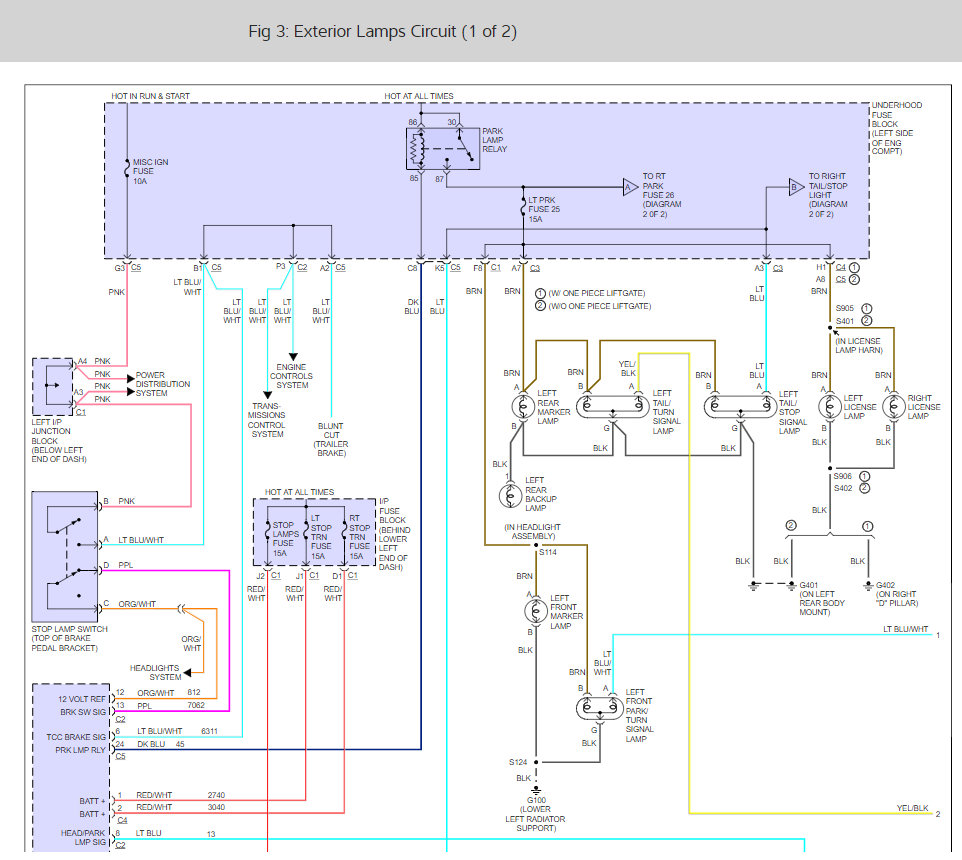

RASCALS49

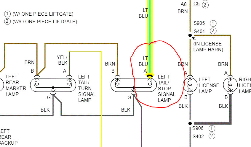

The blinker, flasher and brake light don't work on passenger side. Only tail light will light up. The drivers side is fine. I have tried new bulbs and fuses seem to be fine. I have tried new bulbs and fuses but passenger side flasher,brake lite and blinker dont work only tail lite will illuminate.
JDL
  • 16,098 POSTS
Did you check for voltage at the bulb socket or wiring? In the diagram, the brown wire is voltage for tail lamp. The dark green wire is voltage for stop and turn, just not at the same time. Lower Stop and turn are wired through the turn switch.
