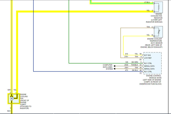

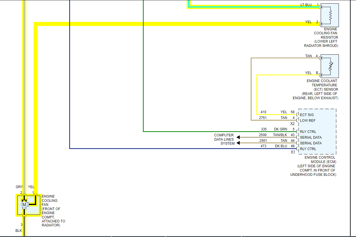

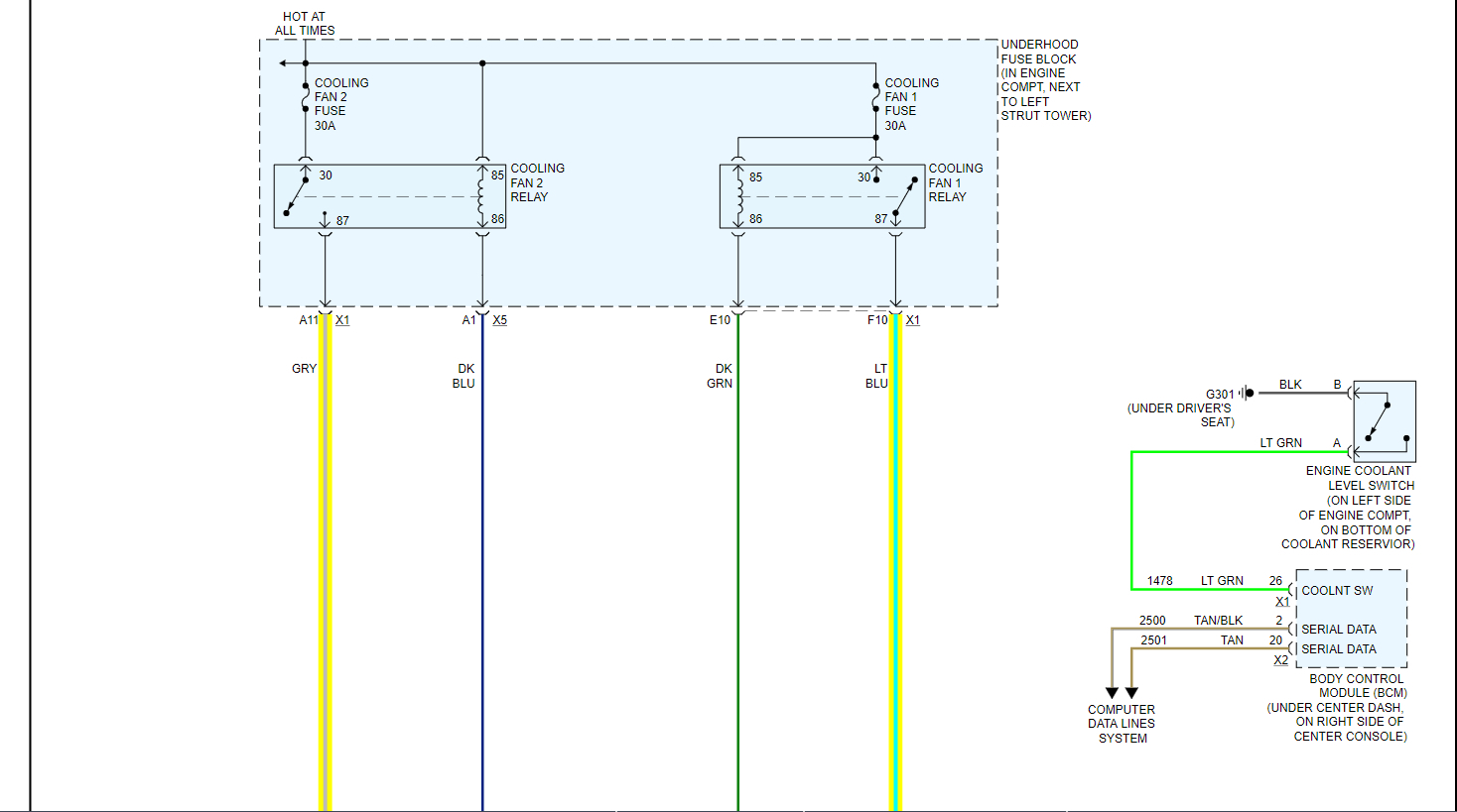

I have a 2-speed single cooling fan. I am having issues where the low speed fan does not seem to come on, and yet the hi-speed fan is blowing the 30A fuses. I have swapped relays from Cool Fan 1 and Cool Fan 2 with no change in symptom. Cool Fan 2 does kick in at temperatures over 200 degrees F, but does eventually blow the fuse. Am I right in believing I have an issue with the low speed resistor? It is my belief that by the time the hi-speed fan (cool fan 2 circuit) kicks in (sometimes on quite often), it is overworking as it never kicked on in low speed (cool fan 1 circuit), and it is overheating/blowing the cool fan 2 fuse. I have not tested to see if the ECM is triggering the ground circuit for cool fan 1, but I am thinking with the high mileage as this car has, that it may be a resistor problem. Also, assuming I have to replace this resistor, what is the best method for removal and replacement? Symptom: Car will try to overheat at long lights and A/C turns warmer until cruising again. Due to no low-speed fan coming on. Thanks a million!

Good afternoon,
Cooling fan relay 2 is for the high speed fan. The resistor is only for low speed.
Cooling fan relay 1 goes through the resistor.
You need to check for voltage at cooling fan motor with the A/C on which commands low speed.
I attached the wiring diagram for you of the fans. I think you need to replace the fan motor from drawing too much current and blowing the fuse.

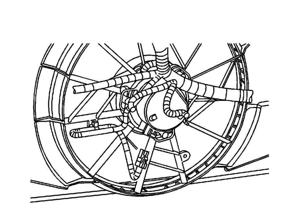

Cooling Fan and Shroud Replacement (2.2L (L61), 2.4L (LE5))
Removal Procedure
1. Disconnect the cooling fan electrical connector.
2. Remove the cooling fan wire from the fan shroud.
3. Raise and support the vehicle. Refer to Lifting and Jacking the Vehicle .
4. Remove the cooling fan assembly from the radiator by pushing up on the fan shroud to unsnap the retaining features. Position the cooling fan assembly away from the radiator.
