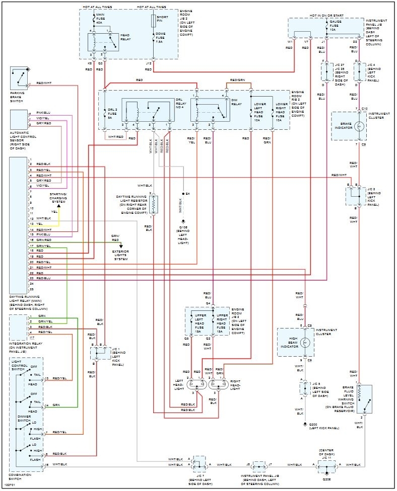

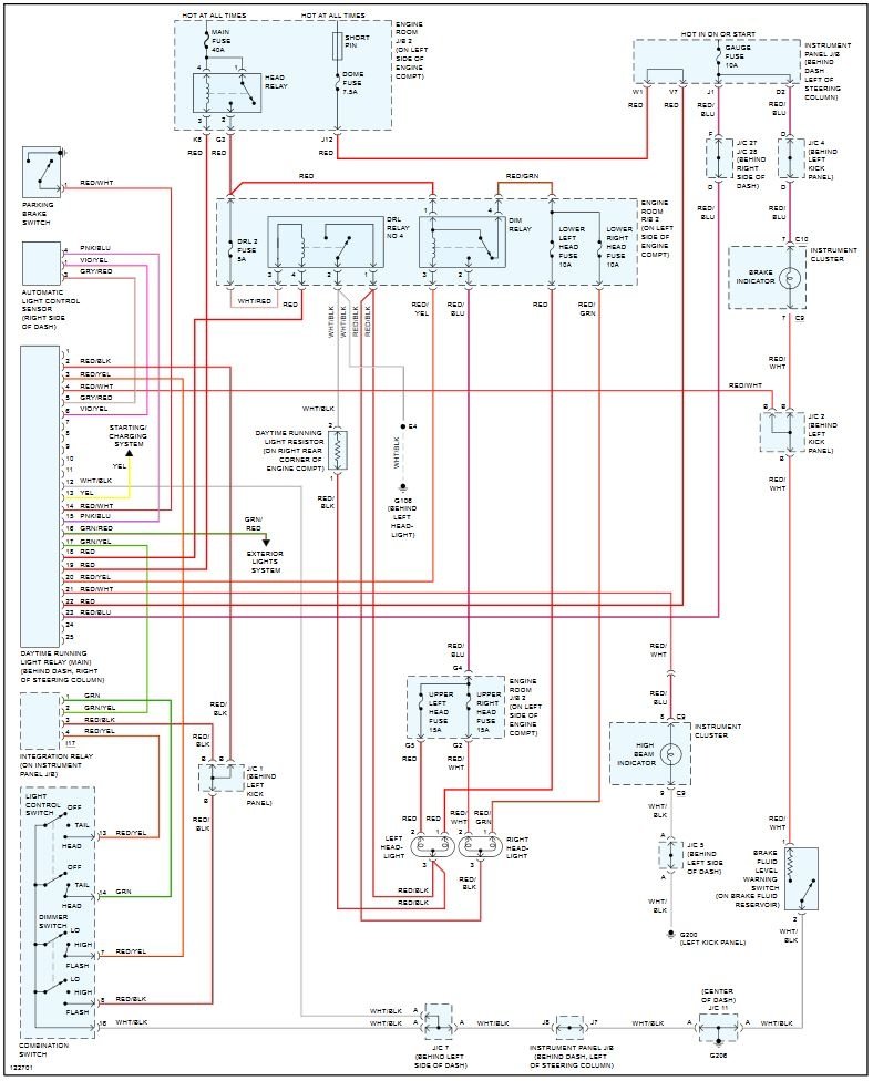

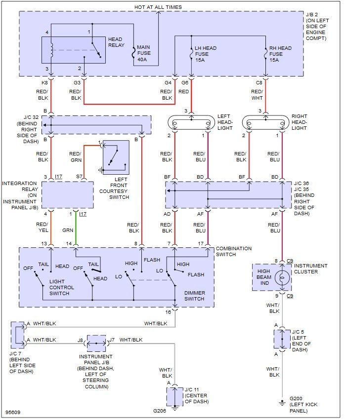

I have no low lights, and my head light witness in the dashboard is always turned on.
Nov 19, 2018 at 4:40 AM
JONNYB1963
  • 263 POSTS
It sounds to me that you may have a bad combination switch. Sometimes they call them a stalk switch. It sounds to me like the dimmer switch is malfunctioning and since they do not sell these separately you would need to replace the whole switch. I have included some wiring diagrams (one with DRL and the other without DRL) so you know how the system works as well as instructions on how to replace it.
See the images and diagrams attached.

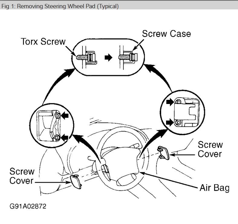

C. Remove the steering wheel cover pad by loosening the torx screws. Back them out until the heads run into the the top of the screw case See the image attached below.
D. Pull Steering Pad off of the steering wheel and carefully disconnect the air bag connector.

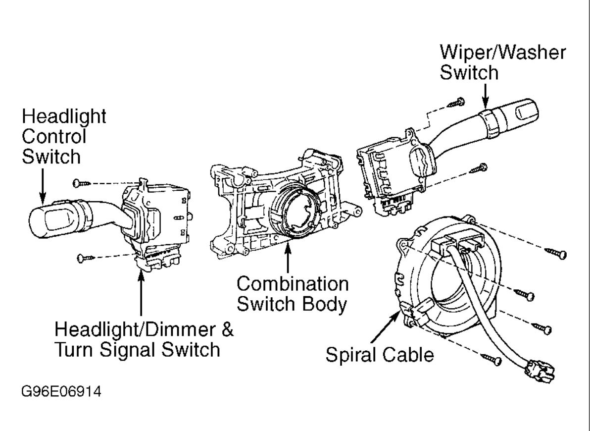

4. Locate and remove the Combination Switch assembly and cable connector(s)
5. Remove cruise control switches on the steering wheel and disconnect the cruise control connectors from the slip ring.
6. Remove the slip ring from the combination switch.
7. Remove the wire ties that hold the combination switch wiring harness to the steering column.
8. Remove screws and release the claws that secure the combination switch and spiral cable to the steering column.
9. Remove the combination switch and spiral cable.

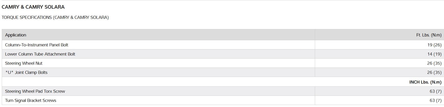

Reassemble in the reverse order with the new switch stalk. Use the torque specifications attached.
